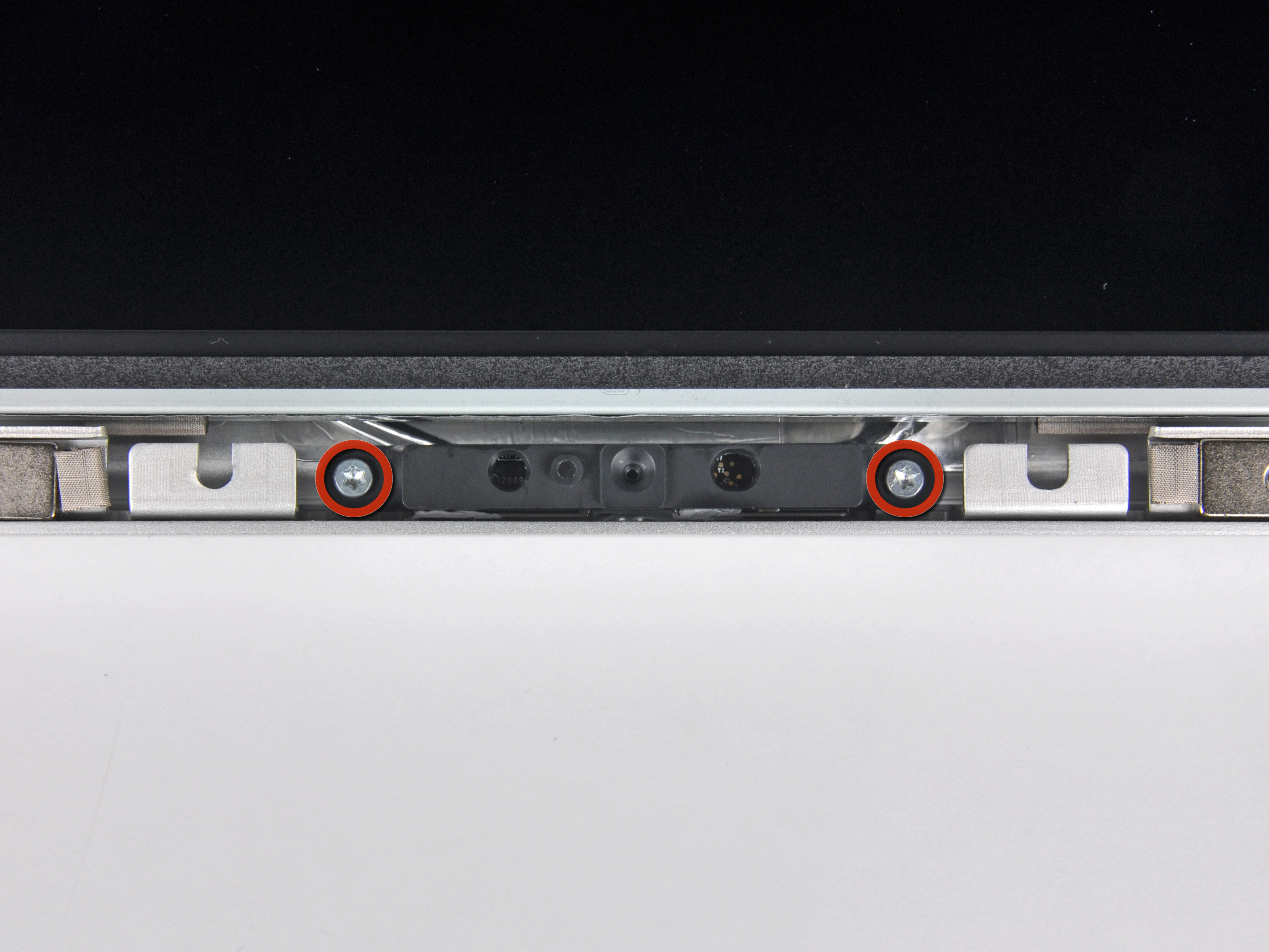

  3. iMac Intel 21.5" EMC 2308 Camera Board Replacement, Camera Board: step 3, image 1 of 1
    • Remove the two 5.2 mm shouldered T10 Torx screws securing the camera board to the outer case.
