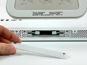

Image 1/2: Remove the access door from the iMac. Image 2/2: '''Before beginning the repair, unplug the computer and press and hold the power switch for 20-30 seconds, to discharge internal capacitors.'''
  • Loosen the two captive Phillips screws securing the access door to the iMac.
  • Remove the access door from the iMac.
  • Before beginning the repair, unplug the computer and press and hold the power switch for 20-30 seconds, to discharge internal capacitors.

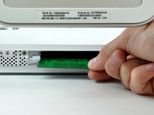

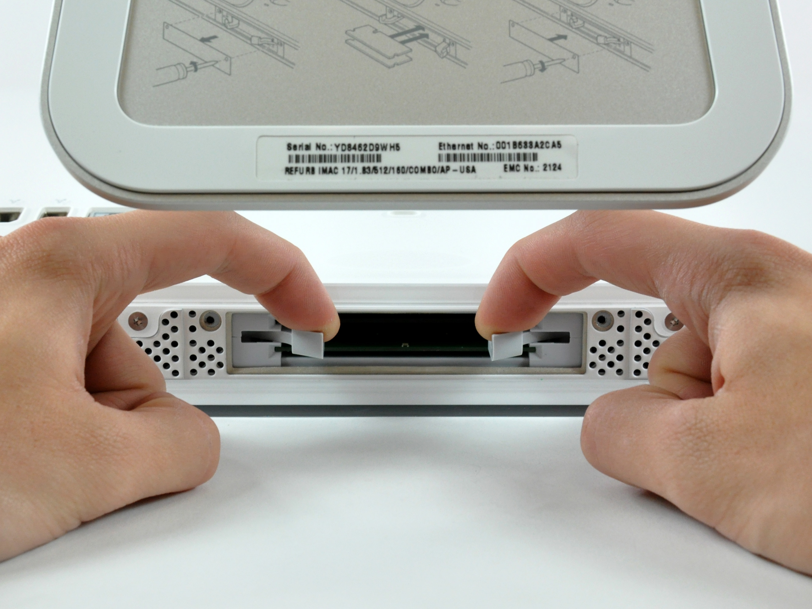

Image 1/2: Slide the RAM chips out of their slots. Image 2/2: Be sure the two RAM chips are fully inserted into the iMac before reinstalling any RAM arms.
  • Rotate the two RAM arms outward from the iMac to eject the RAM chips.
  • Slide the RAM chips out of their slots.
  • Be sure the two RAM chips are fully inserted into the iMac before reinstalling any RAM arms.

These comments don't belong here, they are for the hard drive replacement page. That being said, the RAM replacement is easy easy easy. It took me longer to get the RAM out of the packaging than it took to install them.

I of course did it wrong! Then figured it out and did it right after the children started crying their 3 macs weren't working! When you put the memory in it really is important to push the memory chips all the way in with your fingers until they are well seated. If not... flashing start light computer won't even start, and at best only half of ram will actually work. So put them in right side up, slide them in carefully into their slots and slide them all the way in until they click into place. All happy now on Club Penguin and Kizi!
