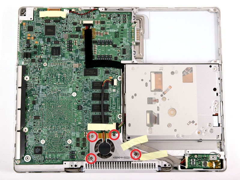

Remove the 4 Phillips screws from the bottom shield.
on mine, there are six small extra screws to remove.
Lift the bottom shield off.
Remove the 4 Phillips screws securing the fan to the metal framework.

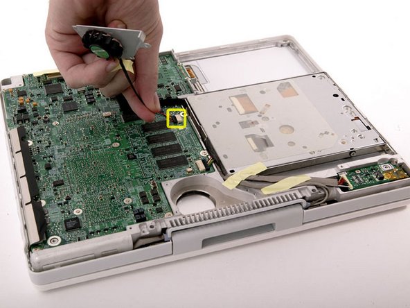

Lift the fan out of its compartment and disconnect it from the logic board, removing tape as necessary.
