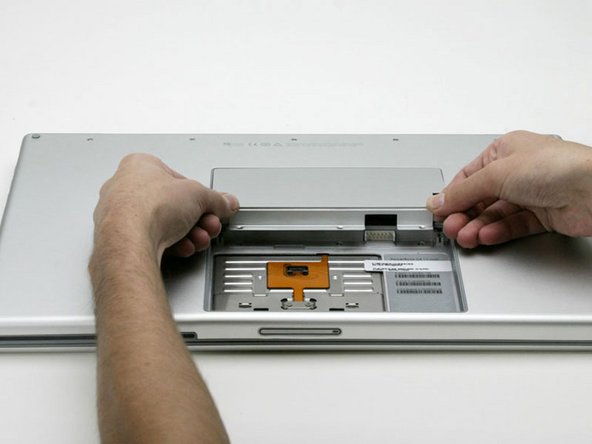

Image 1/1: Use your thumbs to push both battery release tabs away so that the edge of the battery lifts up.
2 Edit Step 1 Battery  ¶
  • Orient the computer so that the side with the line of screws on it is away from you.
  • Use your thumbs to push both battery release tabs away so that the edge of the battery lifts up.

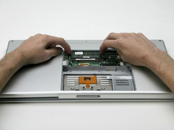

Image 1/1: Pull the chip directly out from its connectors. If there is a second RAM chip installed, pop it out in the same manner.
Edit Step 4  ¶

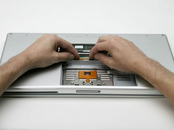

  • Release the tabs on each side of the RAM chip at the same time. These tabs lock the chip in place and releasing them will cause the chip to "pop" up.
  • Pull the chip directly out from its connectors. If there is a second RAM chip installed, pop it out in the same manner.

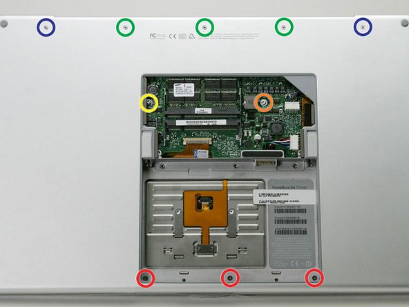

  • Remove the following 10 screws from the bottom case:
    • Three 1.7 mm Phillips from the front edge of the battery compartment.
    • One 3.9 mm T8 Torx to the right of the memory card.
    • One 6.9 mm T8 Torx at the left edge of the memory compartment.
    • Three 12.4 mm fully threaded Phillips from the center of the row of screws along the back edge of the case.
    • Two 15.1 mm 2.5 mm threaded Phillips, one from either end of the row of screws along the back edge of the case.

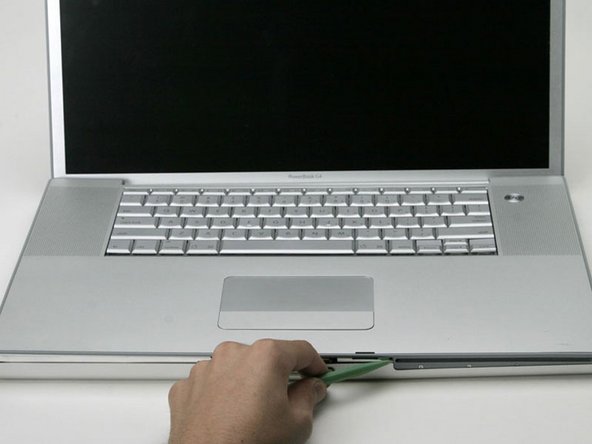

Image 1/1: Pull the upper case off, lifting from the back, and working around the  edges.
Edit Step 10  ¶
  • Open the computer and turn it so that the screen faces you.
  • Pull the upper case off, lifting from the back, and working around the edges.

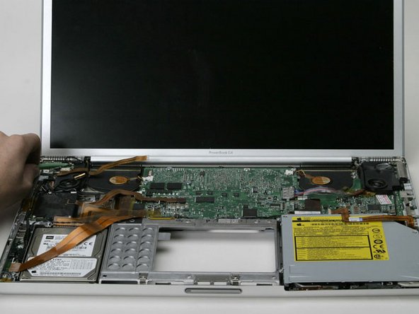

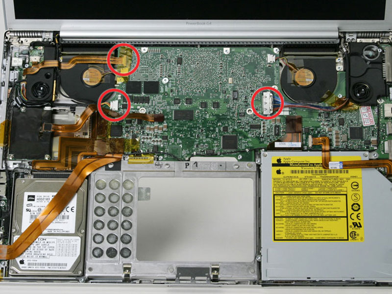

Image 1/1: Disconnect the inverter cable, the Bluetooth/DC-In cable, and the display data cable from the logic board.
Edit Step 12 Display  ¶
  • If you are ultimately removing the heat sink & fan assembly, your computer will differ from the images in this section.
  • Disconnect the inverter cable, the Bluetooth/DC-In cable, and the display data cable from the logic board.

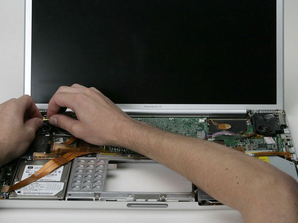

  • Disconnect the Airport antenna cable at the gold connector, making sure you pull only on the gold metal portion of the connector.

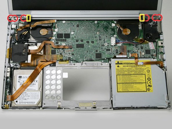

  • From each complete hinge assembly, remove two Torx T6 screws from the outside of each set, leaving two remaining in the middle of each hinge. On each side, the two screws closer to the edge of the computer are shorter than the two screws closer to the center of the computer. Then remove the two inner screws from each hinge assembly. There are 8 screws total.

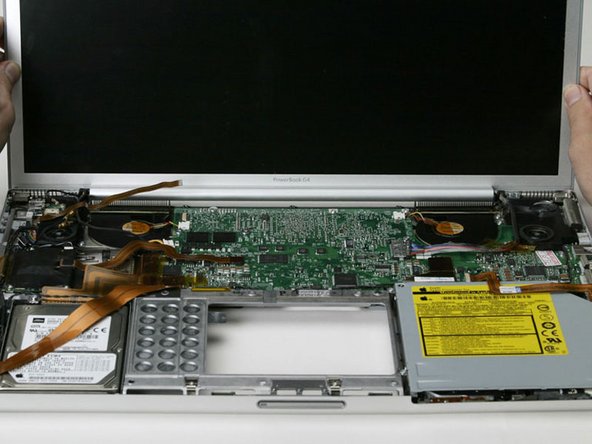

  • Lift the screen assembly away from the computer.

  • When reassembling the display, check to see that the hinges are seated properly before reinstalling the 8 screws of the two hinges. There is a metal phalange on the inside end of each hinge assembly that must be pointed downward and fit into a slot below the inside edge of the hinge. If not, the inside end of each hinge will sit too high and the plastic retaining bracket for the wiring will not sit down properly.
