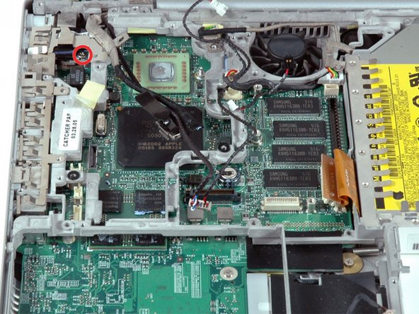

Image 1/1: Remove the small EMI finger beneath the black screw.
  • Remove the long black Phillips screw next to the memory card.
  • Remove the small EMI finger beneath the black screw.
What is an EMI Finger???
zdavatz - Reply
Quote from zdavatz:
yeah, good question. I just blew that off - everything else worked just fine - thanks to ifixit for such a great step-by-step!
springboard - Reply
Quote from zdavatz:
That black screw needs to come out because it goes all the way through the computer into the back of the keyboard. However, I didn't see any EMI finger, unless that's the purpose of the metal directly underneath it. EMI fingers are those little tin foil like things you'll see along the ports inside the computer. They provide shielding from what I presume stand for electro-magnetic interference.
aratuk - Reply
Quote from zdavatz:
I think the EMI Finger is probably the silver clip that is under the head of the black screw that step 3 tells us to remove.
Kredanta - Reply
EMI stands for electro-magnetic inteference. An EMI finger is a piece of metal that connects two pieces of a metal case together, preventing EMI ("radio waves") from passing in or out. In this case, yes it is the "clip".
jerrykrinock - Reply
The black phillips screw is completely stuck on my compulter, and in my frustration, I managed to stripp the screw.. Noe I am concidering drilling it out, this will most likely destroy both the screw and the "EMI finger". Is this a problem? I guess the screw is no problem, but the EMI finger? Or anybody have any ideas to what I could do, I wanted to change my harddrive.. Thanks!
powerbookg4hdd - Reply
Dear powerbookg4hdd. This is a very long screw and you could not drill it out. First, try to turn it with needle-nose pliers. If that is too difficult, use a larger drill bit and try to drill the head completely off instead. You're in a very difficult situation. Of course, remove the RAM card to give yourself some working space.
Dear jerrkrinock! Thank you for your quick reply. Taking your recommendation, I did not try to drill it out, and after considering several approaches, I used a cutter and changed the "star" screw into a "straight" one. This was successful, and I was able to change the drive. I did not find anything that could be an EMI finger, though.. Anyways, thanks ifixit.som for great guides!
I believe the clip is referring to the ribbon of grounding material that the plate sits on. You need to move it over to take the long screw out without tearing it. And then you need to lift it and hold it out of the way when you replace the the long screw to avoid pinching it under the head of the screw. TR
tredding - Reply
powerbookg4hdd: or anyone else -- i'm in a similar situation. what kind of cutter did you use to re-notch the screw? or is there another way to get this screw out if it is stripped?
afb - Reply
To be clear on this step you don't need to remove the long black screw (in fact it doesn't appear possible to remove it completely) just make sure it's been unscrewed as much as possible and then leave alone
mancunianlad - Reply
This is correct. The long black screw screws into the keyboard so it does need to be unscrewed, but can be left in place. It may fall out while the laptop is bottom down but if you are working on a towel you'll find it easily.
Quote from mancunianlad:
emanmb - Reply
I don't see anything that looks like a clip under this screw. It came out just fine (although it wanted to pull up the padding directly above it when I I pulled it out), but all that's under it is the metal plate it's screwed into, which looks like it is also held down by another screw. Is this what I'm supposed to remove? It certainly doesn't seem to want to come up.
Calion - Reply
Should this step specify that the memory door is now to be replaced? At Step 9 the photos show it back in place and yet I didn't see where it was to be screwed back on.
FWIW, my PB did not have an EMI Finger (assume some earlier repair removed it and did not put it back). Is that a concern?
kah - Reply

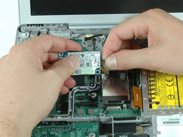

  • Use a spudger or flathead screwdriver to disconnect the Airport antenna from the card.
Note that this is a "right angle" coaxial connector. The metal cube is a part of the connector and stays with the cable. It is not a part of the airpor card. Also, I found two clear plastic blocks in front of the airport card, a smaller one near the connector and a larger one on the other side. Possibly these are to keep the cable from vibrating and flexing during, say, a truck ride. Don't lose these.

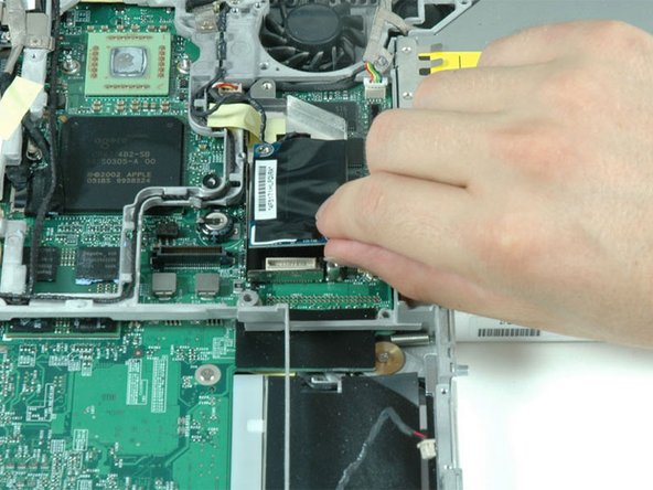

Image 1/1:
  • Grasp the plastic tab and pull the card out all the way.

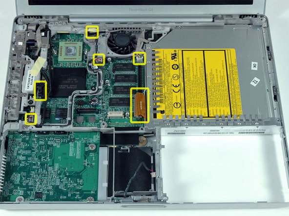

  • Grasp the keyboard connector ribbon near the connector and disconnect it from the logic board.
I would not pull up on the ribbon as is being done in the picture. Note that the black pastic base that you see is the connector part that is permanently attached to the ribbon cable. Use a small screwdriver or spudger alternately on each end of the black plastic base to pry and rock it upwards.
I agree. I was able to use a needle nose pliers to gently grab the black connector and wiggle the connector from the motherboard.
Quote from jerrykrinock:
emanmb - Reply

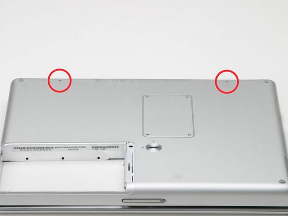

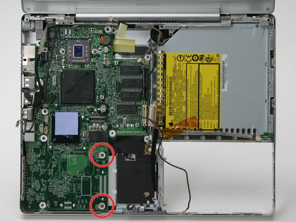

Image 1/1:

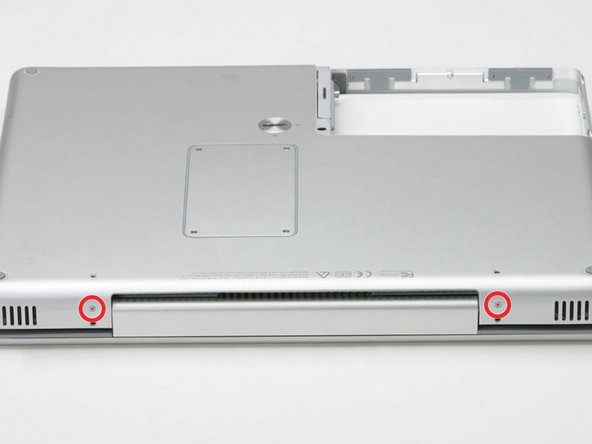

  • Remove the three 2.5mm Phillips screws from within the battery compartment.
Image 1/1: Outside case screws are aprox. 1/4 in long
  • Turn the computer 90 degrees clockwise and remove the two Phillips screws from the casing.
  • Outside case screws are aprox. 1/4 in long
Image 1/1:
  • Turn the computer 90 degrees clockwise again, and remove only the bottom screw on either side of the hinge.
I guess this is bottom screw if you have the computer upside-down?
shortusername - Reply
That's what worked for me. The illustration is correct or at least this procedure worked for me. =)
Quote from shortusername:
emanmb - Reply
Step 10-these two screws are 5.5 mm with a shoulder
Step 11--these three screws are 5.5 mm without a shoulder
Step 12--these two screws are 3.5 mm with a shoulder
Chuck - Reply
Don't do what I did.. I had taken both top and bottom screws out before coming upon this site.
When I had put everything back together again, I unfortunately realized that the top set (towards the bottom of the computer) of screws attach the screen to the frame. On the screen setup there are these prongs that slide into the bottom edge of the frame. My prongs where sitting ontop of where they were suppose to go. I then had to take the computer apart completely again :(
maruskiewicz - Reply

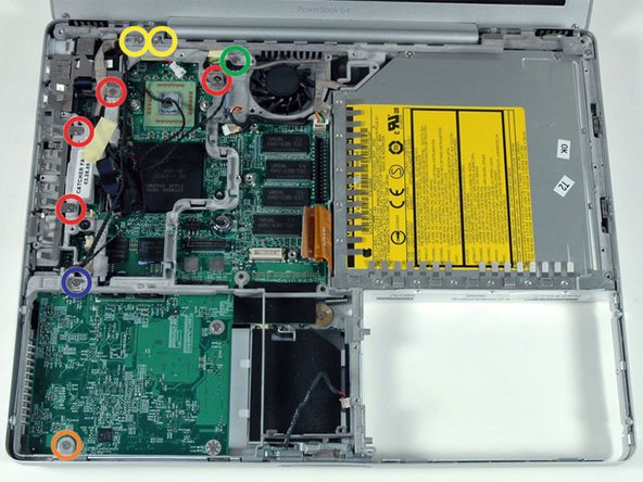

Image 1/1: Remove the following 14 screws:
  • Turn the computer over and open it up.
  • Remove the following 14 screws:
    • Six 2.5 mm Phillips on either side of the keyboard area.
    • Five 4.5 mm Phillips on the left half of the keyboard area.
    • One 7 mm hex in the upper left corner of the upper case (a T6 Torx driver will do the job nicely).
    • One 15 mm Phillips in the upper middle of the keyboard area.
    • One 16.5 mm hex in the upper right of the upper case (again, a T6 Torx driver will work well).
Suggestion: Print the photo on a full sheet of paper and punch small holes through the paper inside each circle. As you remove the screws, push each one through the corresponding hole in the picture.
LauderdaleMac - Reply
What are those connectors responsible with? What parts do they connect.
I need to know this since after my hdd replacement my airport card is not seen in the list of contents:
I get this massage : "No information found."
The card is working since I put it in another laptop and it worked there.
THANK YOU!
diago - Reply
Make a full page printout and using sticky tape put the screws (in clusters if easier) where they should go on the photo. In fact I took a blank sheet of paper and did a step by step guide to all screws I took out and then put the screws next to each step header (1,2,3....) and put sticky tape on them.
FYI there are 14 screws - not 13
I found that a T7 Torx screwdriver worked better for removing the two hex screws
slessard - Reply
I set out tiny dixie cups and marked them for each step wit screws 2-22, including 3 cups for step13, red, orange, and the other 3.
shon - Reply
Also, a T6 driver works for the blue and yellow screws, but the 1.5 mm hex head driver is the appropriate driver for those screws.
shon - Reply
I think, that the needed Hex is actually a 1/16 inch Hex.
the 1.5mm works fine but seems to be a littlebit too small (But i can't test it since i do not own 1/16 inch Hex (but that one should be about 1.58mm).
MrKane - Reply

That very well may be true. The 1.5 mm hex does go in pretty easily, but I got both screws out and back in with it. I don't have a 1/16 hex either, but that would be interesting to try if anyone has one.
shon - Reply

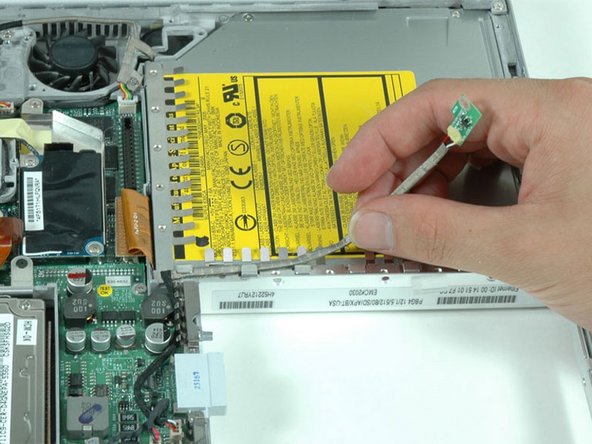

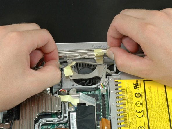

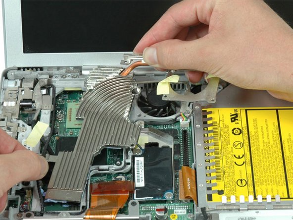

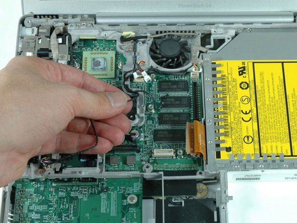

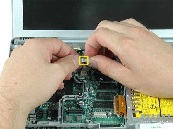

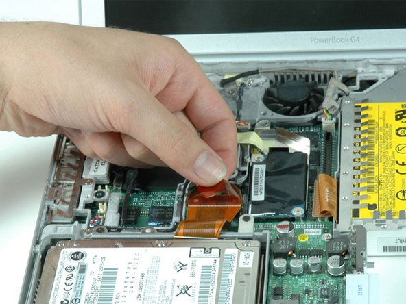

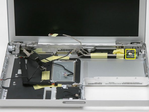

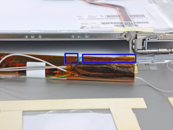

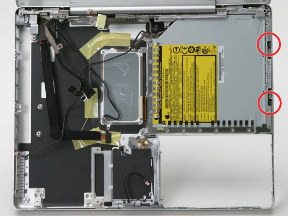

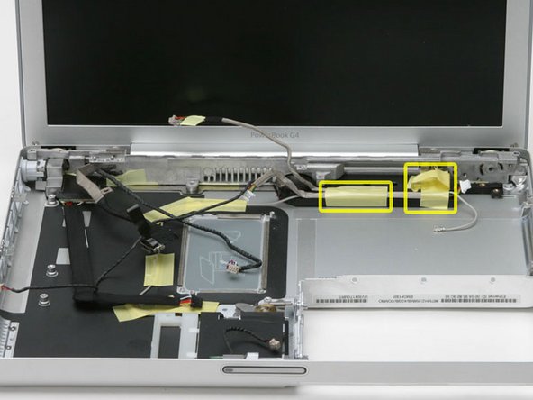

Image 1/1: Peel up the two pieces of foil tape on the left side of the keyboard area.
  • This step is extremely tricky, and has the potential to ruin your computer. It is easy to pull the plug with the red and black leads (the power) out of the motherboard. If you do that, it is nearly impossible to fix.
  • Peel up the two pieces of foil tape on the left side of the keyboard area.

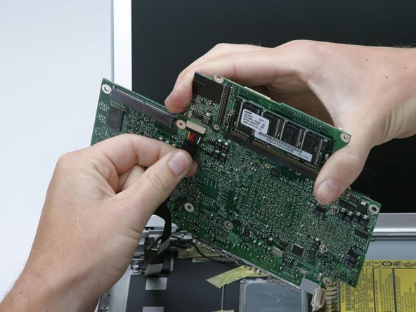

  • The connectors at the ends of the cables are attached very firmly to the sockets on the logic board. Pulling directly on the cable will either separate the cable from its connector or the socket from the logic board.
  • Carefully disconnect the microphone and power cables from the logic board. Using your fingernails or a dental pick, carefully pry the connectors from their sockets. Make sure you're pulling only on the connector and not on the socket.
What two pieces of foiltape do you mean?
zdavatz - Reply
Quote from zdavatz:
There should be two pieces of foil tape on top of the connectors on the left side. The laptop in the picture was disassembled previously and somebody forgot to put the tape back...
Miroslav Djuric - Reply
Is anything can be done if I brooked the power sockets in the logic board during hard drive changing?
gregk - Reply
In the picture, the foil is already gone. If your computer has been taken apart previously, as apparently ours has, the foil may be already gone. The photo is missing the markers that are needed to see what they are talking about, but these two connectors are near the left side. The speaker cable has a red and black wire, and the microphone connector has three grayish white wires.
YOU DON'T NEED TO DO THIS!!! IT IS DIFFICULT. WHEN YOU PROCEED TO STEP 16, JUST LIFT TOP OFF CAREFULLY AND LAY BESIDE LEFT SIDE!
jnelson - Reply
Quote from gregk:
I need to know this as well. The top socket (red and black wire) broke off the logic board. Can I fix it?
kristinaksmith - Reply
Quote from gregk:
thomsenmusic - Reply
I pulled the plug off the red and black power leads. I successfully pulled the plug off the board and took it to my apple store. The tech. said that I would need to find the entire power lead..from the button to the plug, or the entire metal piece with everything attached. He doubted that Apple still stocked any of the parts and suggested I look for parts on eBay. I may be able to push the wires back into the old plug but this may not be a stable connection. Any suggestions???
Quote from thomsenmusic:
As another reviewer suggested you don't need to unplug the 2 cables for the mic and power cables and risk breaking the connectors. Once you have managed to unclasp the casing just - carefully - put the casing to the left side and prop it up so it's standing almost vertically. You will have enough room to access the hard drive underneath.
I agree with several others here. It is not necessary and not recommended to perform the step 14-unpluggings. Everything worked fine without doing this step.
suselfunk - Reply
Quote from jnelson:
I agree. I did not disconnect either one either. I propped it against the side of the monitor of the MacBook Pro I was reading these instructions on while doing this repair.
shon - Reply
Mine was that way too! No foil.
Quote from Miroslav Djuric:
emanmb - Reply
I agree as well. Step 14 can be skipped and I did it that way as it was advised by users here. Just be careful once the plate is free as it is still connected to those wires and they seem fragile.
Quote from shon:
emanmb - Reply
They must have stopped using the foil tape. Mine did not have it either. I left the connectors alone too as suggested. Not a problem.
Craig - Reply
I found it easier to leave these attached and pry them off after partly lifting the top chassis in step 17.
Kees - Reply
Note were the tapes are as they do not fully show in the photo.

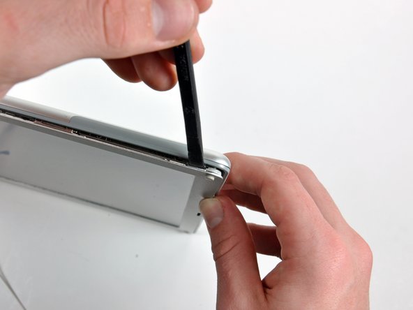

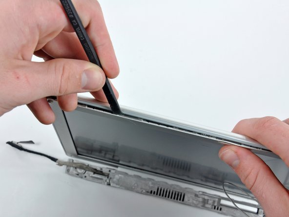

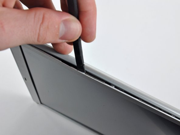

Image 1/1:
  • Starting at one of the upper corners near the screen, work around the frame, separating the upper case from the lower case.
As suggested above this is quite tricky due to the plastic catches towards the front of the case (ie where the trackpad is). Access the front 2 on the right by going in through the empty battery slot and prise away the plastic from the case. That leaves the 2 on the left which are tricky. Use a spudger or flat head screw driver (v careful here though so as not to scratch the casing) to work around the front left casing. Don't give up or despair - it does unlock eventually!
Heed the warning that this is a difficult procedure. Those little clips were a lot of work (sliced finger trying to get into the case). I was able to do it but with much attention to not break my case. Patience.
randy29 - Reply
Maybe mine had been opened before but the cover came off fairly easily. Getting it back on was a little tricky and required some finesse. I was able to get mine off with just my fingers and finger nails.
emanmb - Reply
Damo - Reply
I use a credit card to part the case. works very well
Damo - Reply
The aluminum upper case has a grey plastic rim that comes off with it. Running a guitar pick between the plastic rim of the upper case and the aluminum of the lower case made removal easy.
No Name - Reply
If you don't do step 14 (and you really DON'T need to), then know that you're not going to be able to remove completely the upper case from the lower. It will be attached by the black/red wires and the gray wires (see my comment in step 14, too, about detaching the wires that connect with the trackpad). I could not lean the upper case against the screen -- my wires were not long enough, I guess -- but since both sets of attached wires (skipping step 14) are on the same side, you can tip it up and hold it whilst you remove the hard drive. Yes, be patient in doing this step. I broke a guitar pick doing this, so you can apply some force, but do so gently. In the end, I'm not sure what I did to get the non-battery side separated, but just kept wiggling it and applying some force near the trackpad. It popped, and I immediately stopped putting on pressure to ensure I did not pull the upper case completely off (separating the wires/connectors referenced in step 14).

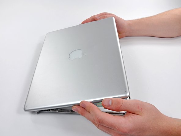

Image 1/1: There are two more grey plastic clips holding the left part of the upper case. They are not easy to release as they are hidden from view prior to disassembly. They are in the same position as the two in the battery compartment, but on the opposite side of the trackpad. Try to stick a flat pry tool into the clip holes and push the clips inward (toward to screen) so they disengage and release the left part of the upper case.
  • Using a screw driver, gently release the two grey plastic clips inside the battery compartment in order to remove the right part of the upper case.
  • There are two more grey plastic clips holding the left part of the upper case. They are not easy to release as they are hidden from view prior to disassembly. They are in the same position as the two in the battery compartment, but on the opposite side of the trackpad. Try to stick a flat pry tool into the clip holes and push the clips inward (toward to screen) so they disengage and release the left part of the upper case.
  • Lift the upper case off the computer.
This is not as easy as it looks. You see the four slots in the picturer there -- the two on the end are partially covered by the technician's left and right thumbs. Those are attached to plastic clips that need to be disengaged. You can access the two inside the batter compartment and disengage them using a small flat-head screwdriver, but the two on the left are not accessible. I finally got them to disengage by pulling up near the trackpad.
Also there are two small cables on the right side that need to be removed and then reinserted when removing and installed the top case back.
Andrew Harris - Reply
upper case won't go out .... it's seems like a metal top obstruct it , because upper case bend when I try to pull out !!
Fernando - Reply
The top case will not come completely off without removing the track pad cable connector.
antonio - Reply
These instructions neglect to mention that there are two hidden clips on the left side of upper case. They are just like the clips in the battery compartment, but they are hidden from view (they are above the hard drive compartment. So it is necessary to not only pry the bottom case out a little, but also to find the two slots where those clips are engaged, and push them in slightly (with a small nylon pry tool, or very gently with a small flathead screwdriver). You can see one of them in the photo above just to the left of the the trackpad, but the one on the left is blocked (in the photo) by the person's left thumb. It's pretty much in the same location as the two in the battery compartment, just on the left side. Good luck. Took me 15-20 minutes of increasingly more forceful prying before I got lucky and accidentally found the left clip holes. I wish these instructions mentioned them... I've edited them so they do now.
Donald Aehl - Reply
I had my hard disk replaced about 6 years ago but I decide to replace it myself this time. I think the service guy must have had a problem with the power socket as this was wobbling on the logic board when I opened it up. I unplugged the mic but left the power (red and black wires) in the board as this was so loose it would have come clean off trying to unplug. I put it all back together and it didn't fire up. In the end I had no choice but to pull the power socket clean off the board as it wasn't making any contact with the contacts on the board. Using a magnifying glass i could see that this wasn't soldered (looked like it was glued) and had two plastic pins. These pins slotted in two holes on the board to align. I the end I just put a bit of superglue gel on the pins and using tweezers place it in position and held it there for 20 secs. It was how firm on the board like the mic socket. Before screwing it all back I pugged in the power to test it. It worked. Fired up instantly. If you ever manage to pull off the socket, just glue it back but avoid getting glue on the contacts.
gapalmer -

  • Peel back the yellow tape securing the inverter cable near the fan.
FYI, if all you want to do is oil your computer fan, remove the sticker from atop the fan at this step and you will expose three holes that lead directly to the fan's bearing. I used a silicone-based lubricant and sprayed directly into the holes.
Maecenas - Reply
Image 1/1: One 4.5 mm Phillips near the modem.
  • Remove the following eight screws:
    • One 4.5 mm Phillips near the modem.
    • Three 6 mm Phillips near the display.
    • Two large 7.5 mm Phillips with attached springs.
    • Two 13 mm Phillips, one on the lower left side of the heat sink and one between the fan and the optical drive.
The middle of the three 6 mm screws (orange circles) is hiding under the cable. Actually you need to do step 24 first, so you can access it.
The 6mm screw is mis-labelled on the photo. The actual screw is on the upper-left corner of the frame around the fan, not the one under the heat sink bar across the top.
Raymond -
The spring screws here are very hard to remove.. the posts holding them down to the logic board popped off for me, and I wasn't about to remove the logic board to re-solder them. I couldn't even get them apart after they were out though! All I did was re-apply thermal paste to the CPU and thermal pads to the GPU and Northbridge chip, and them put on the heatsink without the two spring screws. It keeps cool temperatures, (118* F after normal web browsing for about an hour), which is pretty good still. Just some reassurement for anyone with the same issue. :)
Jonas Kvale - Reply

Image 1/1: If you need to mount the heat sink back into the laptop, we have a [guide|744|thermal paste guide] that makes replacing the thermal compound easy.
  • Support the heat sink with both hands, and carefully lift it out of the computer. Be careful not to bend the copper heat pipe connecting the two sections of the heat sink.
  • If you need to mount the heat sink back into the laptop, we have a thermal paste guide that makes replacing the thermal compound easy.

  • Use the orange plastic loop to disconnect the hard drive cable from the logic board.

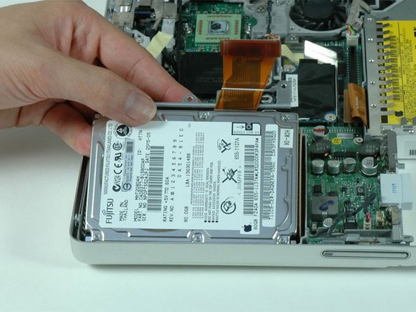

Image 1/1:
  • Lift the hard drive up and out of the computer.
Actually you are removing a "hard drive assembly", which consists of the hard drive plus a mounting bracket and flex cable.

Image 1/1: One 3.5 mm Phillips in the lower right corner.
  • Remove the following five secrews/standoffs from the DC-to-DC board:
    • One 3.5 mm Phillips in the lower right corner.
    • Two 3 mm Phillips on either side of the battery contacts.
    • One 10 mm Phillips in the upper right corner.
    • One 14 mm long 4 mm standoff in the upper left corner. You can remove this standoff either with a 4 mm nut driver or needlenose pliers.
Well, obviously there is a mistake in step 33 since the "One 3 mm" and "Two 3.5 mm" are both shown as red, while the photo shows one red circle and two orange circles. In fact, I believe that the "One 3 mm" screw, which is the one that should be red, is in fact 4 mm, and the "Two 3.5 mm" screws are actually in the two orange circles.

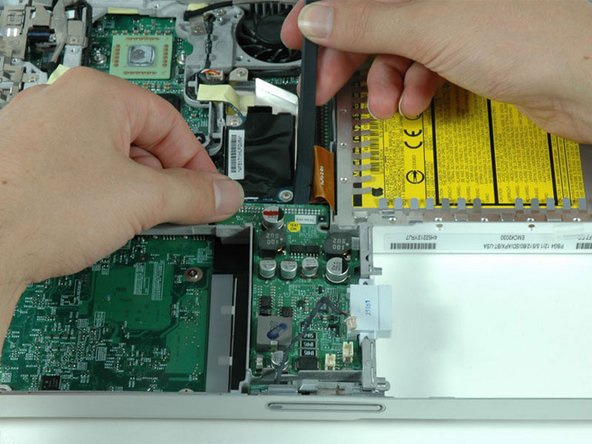

  • Use a spudger to pry up the end of the DC-to-DC board closest to the display and remove the board from the computer.
Image 1/1:
  • Remove the three Phillips screws securing the modem and modem shield to the logic board.
Some computers have only two screws -- the top and bottom one.
bluePeter - Reply
My 1 ghz model only has 2 screws, one in the upper left hand corner of the modem, one in the lower right hand corner, NOT one in the middle, so don't waste your time trying to peel the black plastic cover off of the modem.
stevesontheroad - Reply
3 mm phillips screw
riverate - Reply
Image 1/1:
  • Disconnect the modem from the logic board by lifting the bottom edge of the modem. Don't remove the modem entirely just yet as it is still connected to the RJ-11 board.
Image 1/1:
  • Turn the modem over and disconnect the RJ-11 cable.
Image 1/1: Carefully disconnect six indicated connectors from the logic board. To disconnect the four white connectors, use your fingernails or a dental pick to carefully pry the connectors from their sockets. Make sure you're pulling only on the connector and not on the socket.
  • The connectors at the ends of the cables are often attached very firmly to the sockets on the logic board. Pulling directly on the cable will either separate the cable from its connector or the socket from the logic board.
  • Carefully disconnect six indicated connectors from the logic board. To disconnect the four white connectors, use your fingernails or a dental pick to carefully pry the connectors from their sockets. Make sure you're pulling only on the connector and not on the socket.
Note that the display connector (black rectangle, second from left of the six) has a flexible black plastic handle on top which you can safely pull on.
Connectors top-left and bottom-right of fan should be disconnected (along with screws) before removal of the heat-sink to avoid awkward "threading" of the heat-sink towards the display (potentially injurious to the display also).

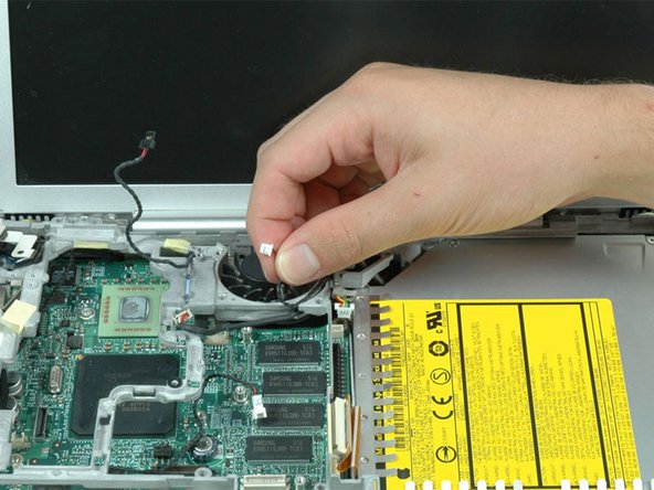

  • Lift up middle speaker cable from the lower left corner of the fan, and disconnect the two sections of the cable.

  • Remove the two Phillips screws from the bottom right of the logic board.
  • When reassembling, take note of the plastic piece immediately to the right of the screws. Make sure you do not neglect to put it in place before screwing down the logic board.
On my computer the rear screw is 6mm and the front one is 4.5mm. But my computer has obviously been disassembled bdfore
Charles Fuller - Reply
both screws should be 4.5mm
riverate -
Image 1/1: Lift the logic board partly up from the optical side.
  • Do not lift the logic board out completely without first disconnecting the DC-In connector underneath the logic board.
  • Lift the logic board partly up from the optical side.
When you remove the logic board, note that there is an EMI finger surrounding the connectors on the left side. Now here is the important part: When reassembling, remember to reinstall this EMI finger!
To re-assemble the EMI finger, make sure it fits well around the video connector. At the bottom of the video connector, the EMI finger has small "fingers", that should grab the logic board. At the top of the video connector, the EMI finger should go under a metal mesh "pillow".
bluePeter - Reply
I re-assembled the EMI finger completely wrong: on the top side of the connectors. i'm almost done re-assembling the power book, and I ask myself if it's necessary to do steps 21-54 again, or if I could just leave the EMI finger out....
springen -
You say do not lift the board before you disconnect the DC-in connector. The connector is under the board, how do you disconnect it without lifting the board first?
hooligan - Reply
Quote from hooligan:
hooligan - Reply
I can not lift the board. Something is holding it down on the lower left side. all of the screws are out.. What can be holding it down?
hooligan - Reply
Hi hooligan,
There shouldn't be anything in the lower left corner that would catch onto the logic board. Please double-check that all screws are removed before taking it out. You can disconnect the DC-in connector once you're able to partially lift out the logic board.
I can't remove the board either. It is stuck in the lower left. All the screws are out.
genetics - Reply
did you get any solution for this? I can't get it out either.
Brian - Reply
Verify that the Aircard has been removed. That should do the trick.
Brandon Curtis - Reply

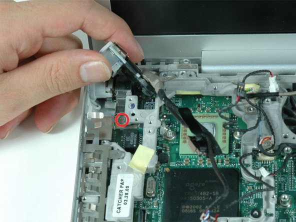

Image 1/1:
  • Disconnect the DC-In connector from the underside of the logic board.
Image 1/1: Remove the newly-liberated small metal bracket.
  • Remove the two 6mm Phillips screws from the upper right corner of the computer.
  • Remove the newly-liberated small metal bracket.
I think the picture here could be improved?

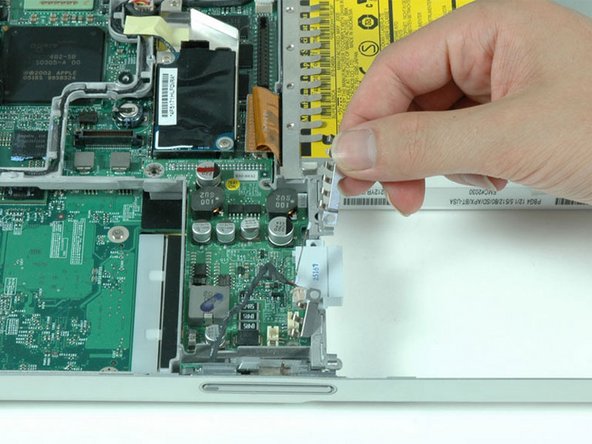

Image 1/1:
  • Remove the two recessed Phillips screws on the right side of the optical drive.
Both 4.5mm screws
riverate - Reply

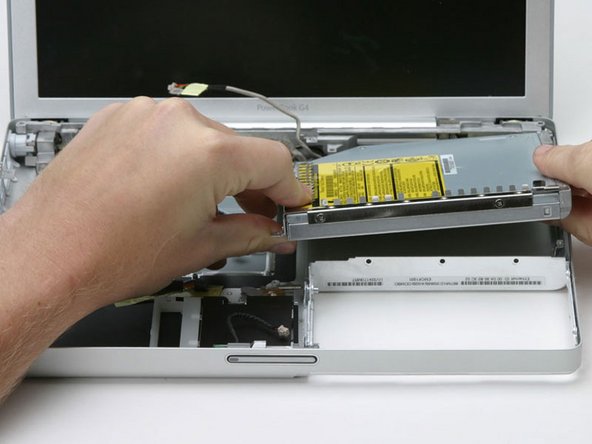

Image 1/1: If you have a CD or any other object jammed in your optical drive, we have an [guide|772|optical drive repair guide].
  • Lift the optical drive up by its front left corner and pull it out of the computer.
  • If you have a CD or any other object jammed in your optical drive, we have an optical drive repair guide.

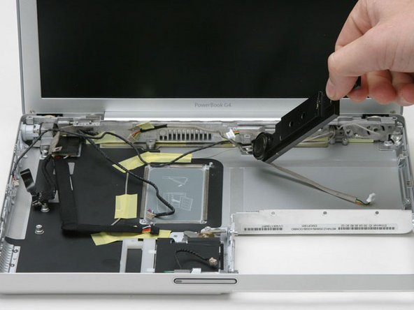

Image 1/1: Remove the single Phillips screw from the right side of the subwoofer, under the tape you just removed.
  • Peel back the yellow tape from the right side of the subwoofer.
  • Remove the single Phillips screw from the right side of the subwoofer, under the tape you just removed.
  • Remove the yellow tape that secures the remaining cables to the side of the subwoofer.
On my computer this is a 6mm screw, longer than the screw in the previous step 57
A 3.5mm in my computer
riverate - Reply
Image 1/1: The subwoofer is adhered to the case, so a little force may be required.
  • Slide the subwoofer away from the screen and out of the computer.
  • The subwoofer is adhered to the case, so a little force may be required.
The subwoofer is double sided taped to the back of the chassis. So... you have to pull it a bit harder than you'd thing.
rseymour - Reply

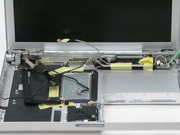

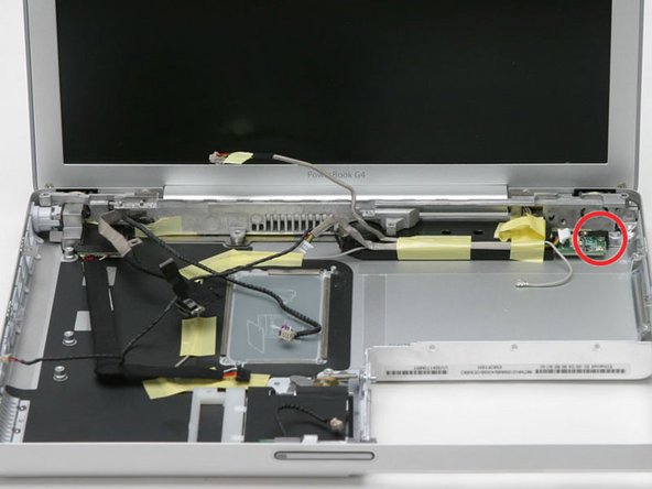

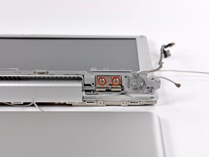

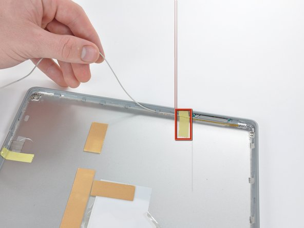

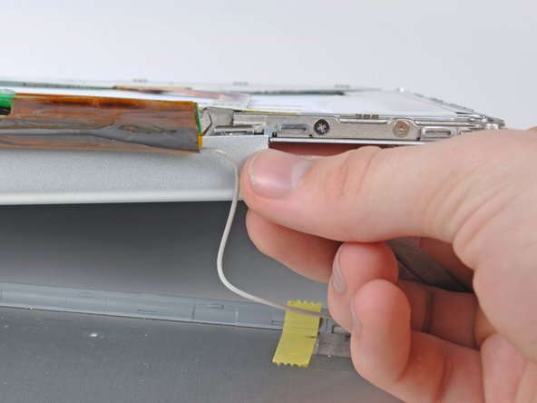

Image 1/1:

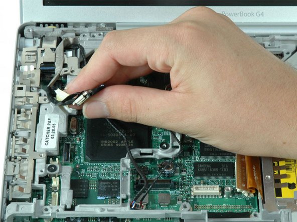

  • Deroute the Airport Extreme antenna from the card slot and lower case, removing tape as necessary.

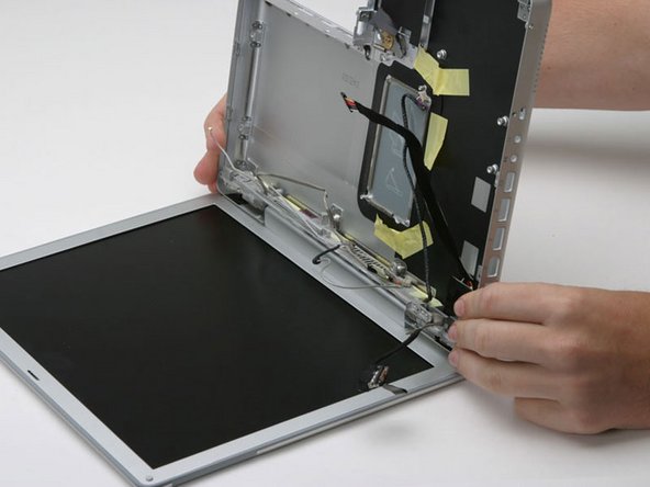

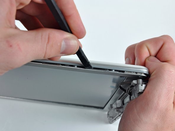

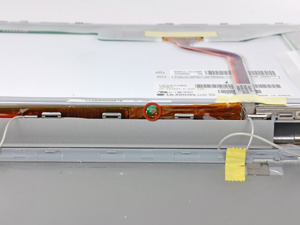

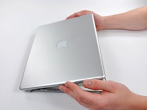

Image 1/1: Close the bottom case and turn the laptop over.
  • Place a cloth between the screen and the bottom case.
  • Close the bottom case and turn the laptop over.
  • Remove the two Phillips screws from the bottom case.

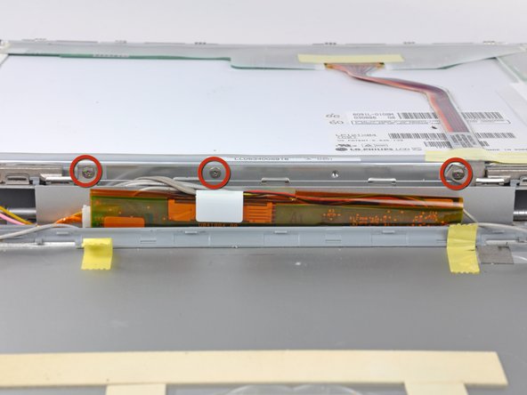

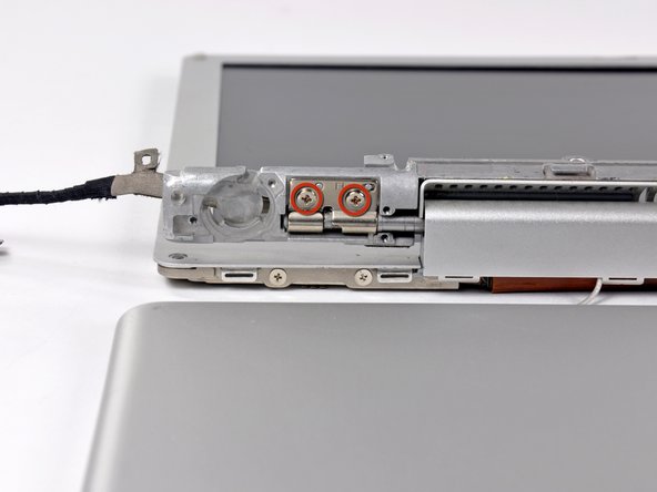

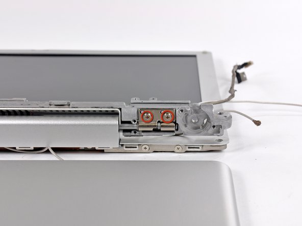

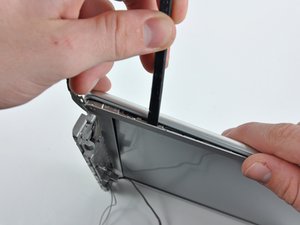

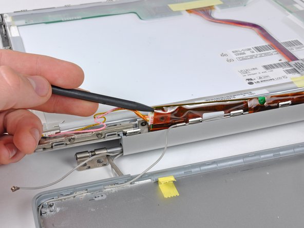

Image 1/1:
  • Remove the two Phillips screws from either side of the display hinge.

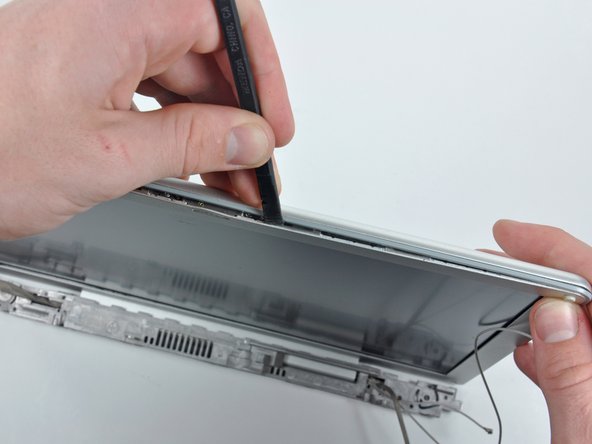

Image 1/1: You have effectively removed the computer from the display.

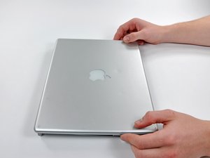

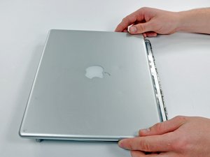

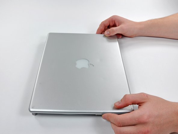

  • Grasp the lower case and push down on the hinge side while rotating the other end of the case toward you until it pops free, then remove it entirely (leaving the display).
  • You have effectively removed the computer from the display.
Image 1/2:

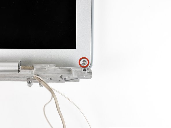

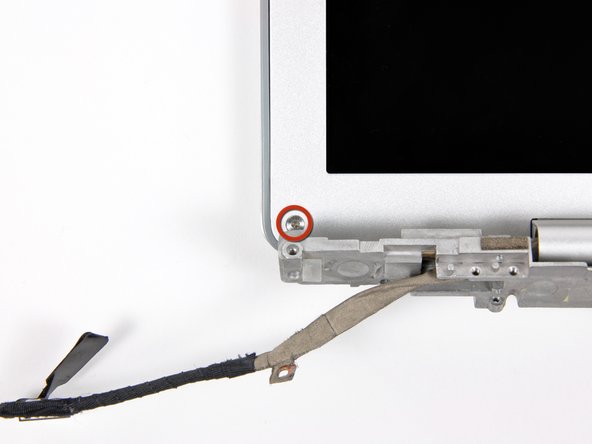

  • Remove the two T6 Torx screws in the lower left and lower right corners of the display securing the rear bezel to the display assembly.
The Torx screws would be more easily removed after removing the four screws of the metal bracket (step 69).
At reassembly screw-in the torx screws followed by the four screws of the metal bracket.
Raymond - Reply

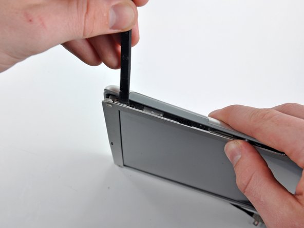

Image 1/3: Rotate the tool away from the LCD to pop the rear bezel off the tabs on the front display bezel.
  • Insert the spudger between the left edge of the front display bezel and the plastic strip attached to the rear bezel, with the edge of the tool angled toward the LCD.
  • Rotate the tool away from the LCD to pop the rear bezel off the tabs on the front display bezel.
  • Work along the left edge of the display until the rear bezel is evenly separated from the front bezel.
Image 1/2: Rotate the tool away from the LCD to pop the rear bezel off the tabs on the front display bezel.
  • Insert a spudger between the right edge of the front display bezel and the plastic strip attached to the rear bezel, with the edge of the tool angled toward the LCD.
  • Work along the right edge of the display until the rear bezel is evenly separated from the front bezel.
  • Insert a spudger between the top edge of the front display bezel and the plastic strip attached to the rear bezel, with the edge of the tool angled toward the LCD.
  • Work along the top edge of the display until the rear bezel is evenly separated from the front bezel.

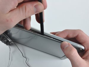

Image 1/2: Release the clip by rotating the spudger away from the screen.
  • Insert a spudger in the space between the front bezel and the rear display bezel near the top left corner.
  • Release the clip by rotating the spudger away from the screen.
  • Repeat this process on the top right corner of the display.
  • These clips are especially tough to undo, and may take some extra force to remove them.

Image 1/2: Thread the display inverter, antenna, and display data cables through the bracket and remove the metal bracket.
  • Flip the device over and remove the two 4.5 mm Phillips screws on each side of the metal bracket (four screws in total).
  • Thread the display inverter, antenna, and display data cables through the bracket and remove the metal bracket.
The Phillips #00 was way too small, I used a #1.
mat - Reply
Yes, #1 is the size to use for better leverage as these screws can be very, very tight. Care required to not strip the screws or the driver …
Raymond - Reply

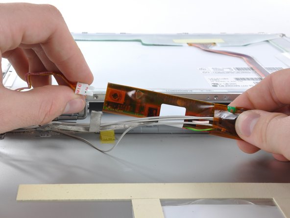

  • Disconnect the inverter cable by pulling the connector away from the socket on the inverter board.

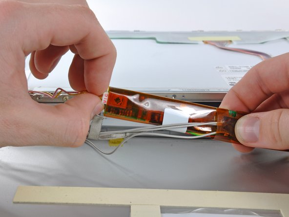

Image 1/1: Separate the antenna board from the display inverter.
  • Starting at the two tape tabs, peel the tape away from the display inverter to expose the antenna board.
  • Separate the antenna board from the display inverter.
  • Remove the display inverter.

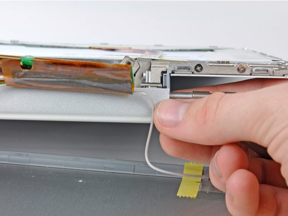

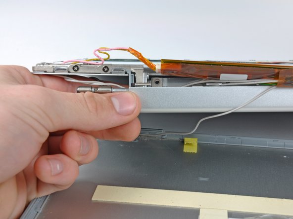

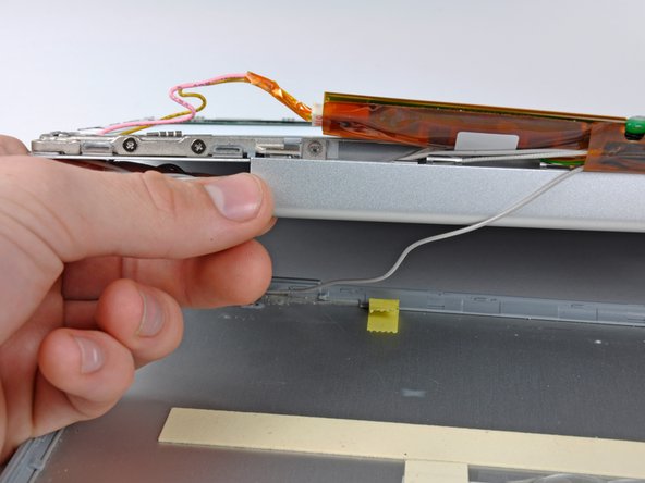

Image 1/1: De-route the antenna cable from the right side of the rear display bezel.
  • Remove any tape covering the right antenna cable.
  • De-route the antenna cable from the right side of the rear display bezel.

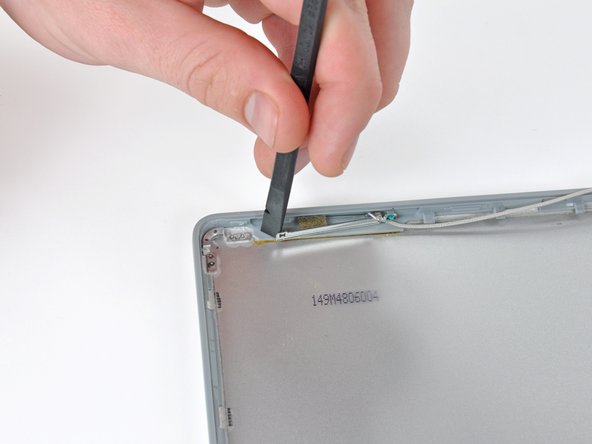

Image 1/2:

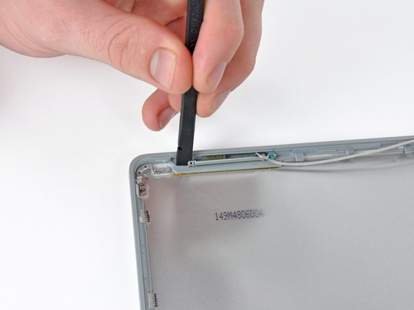

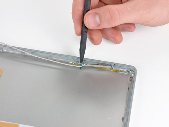

  • The antenna is attached to the rear display bezel via adhesive. To remove it, place the flat end of a spudger behind the top edge of the antenna, and carefully twist the spudger to pop the antenna off.
Image 1/1:
  • Place the pointed end of the spudger behind the lower part of the antenna and carefully rotate the spudger to free the antenna from the rear display bezel.

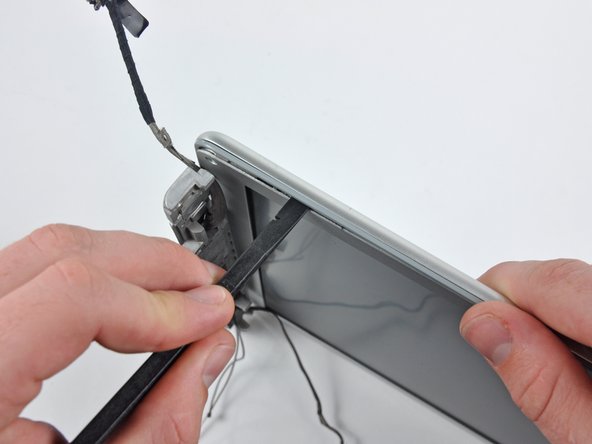

Image 1/1: De-route the antenna cable from the left side of the read display bezel.
  • Remove any tape covering the left antenna cable.
  • De-route the antenna cable from the left side of the read display bezel.
Image 1/1: Remove the antenna assembly.
  • Remove the left antenna in the same way that the right antenna is removed (shown above).
  • Remove the antenna assembly.
