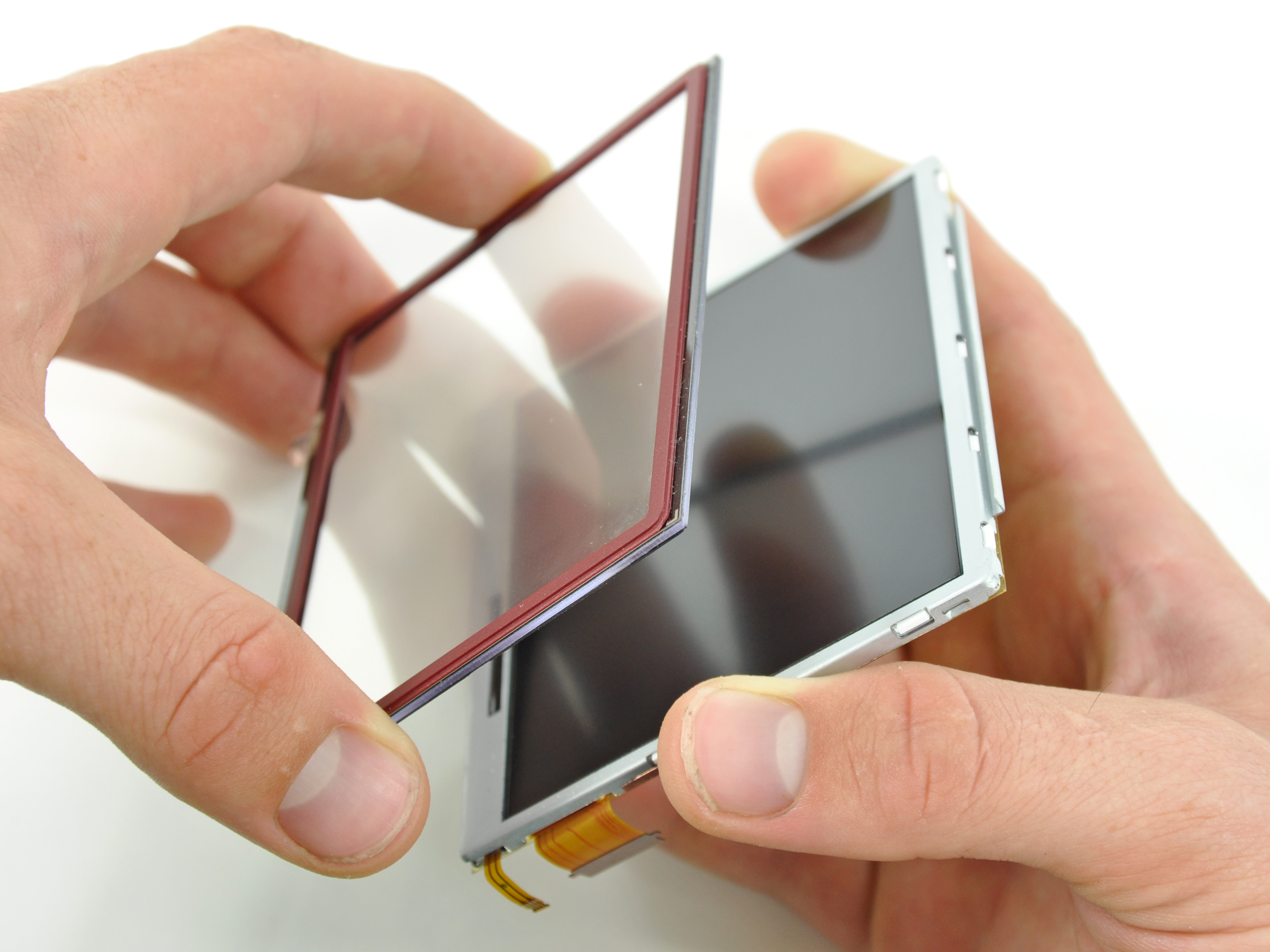

Image 1/2: Slide the spudger down the right side of the display to free the edge of the touchscreen. Image 2/2: Slide the spudger down the right side of the display to free the edge of the touchscreen.
  • Insert a spudger between the touchscreen and top right corner of the display.
  • Slide the spudger down the right side of the display to free the edge of the touchscreen.
Image 1/2: Slide the spudger along the bottom edge of the touchscreen to separate it from the display. Image 2/2: Slide the spudger along the bottom edge of the touchscreen to separate it from the display.
  • Continue around the bottom right corner of the display with the spudger.
  • Slide the spudger along the bottom edge of the touchscreen to separate it from the display.
Image 1/2: Slide the spudger along the left edge of the touchscreen to remove it from the display. Image 2/2: Slide the spudger along the left edge of the touchscreen to remove it from the display.
  • Continue around the bottom left corner of the display with a spudger.
  • Slide the spudger along the left edge of the touchscreen to remove it from the display.
Image 1/2: Image 2/2:
  • With three sides freed, remove the touchscreen from the lower display.
The plastic frame has to be removed from the old touchscreen, too. It's an adhesive. My new touchscreen didn't have one. When reattaching, insert the frame back into the DSi case first, then carefully drop the new touchscreen down on top of it to try to get it to line up correctly.
Also, after everything was done, I had to run the touchscreen calibration in the DSi menu to get the touchscreen to work properly.
