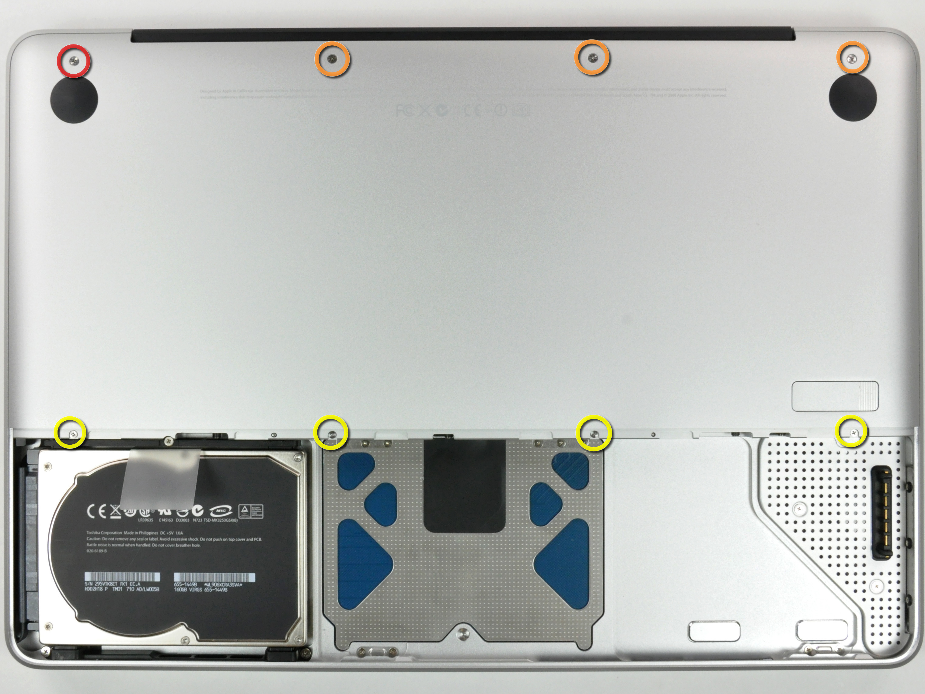

  4. MacBook Unibody Model A1278 Lower Case Replacement, Lower Case: step 4, image 1 of 1
    • Remove the following eight screws securing the lower case to the chassis:
    • One 3 mm Phillips screw.
    • Four 3.5 mm Phillips screws.
  5. MacBook Unibody Model A1278 Lower Case Replacement: step 5, image 1 of 1
    • Using both hands, lift and remove the lower case off the upper case.
