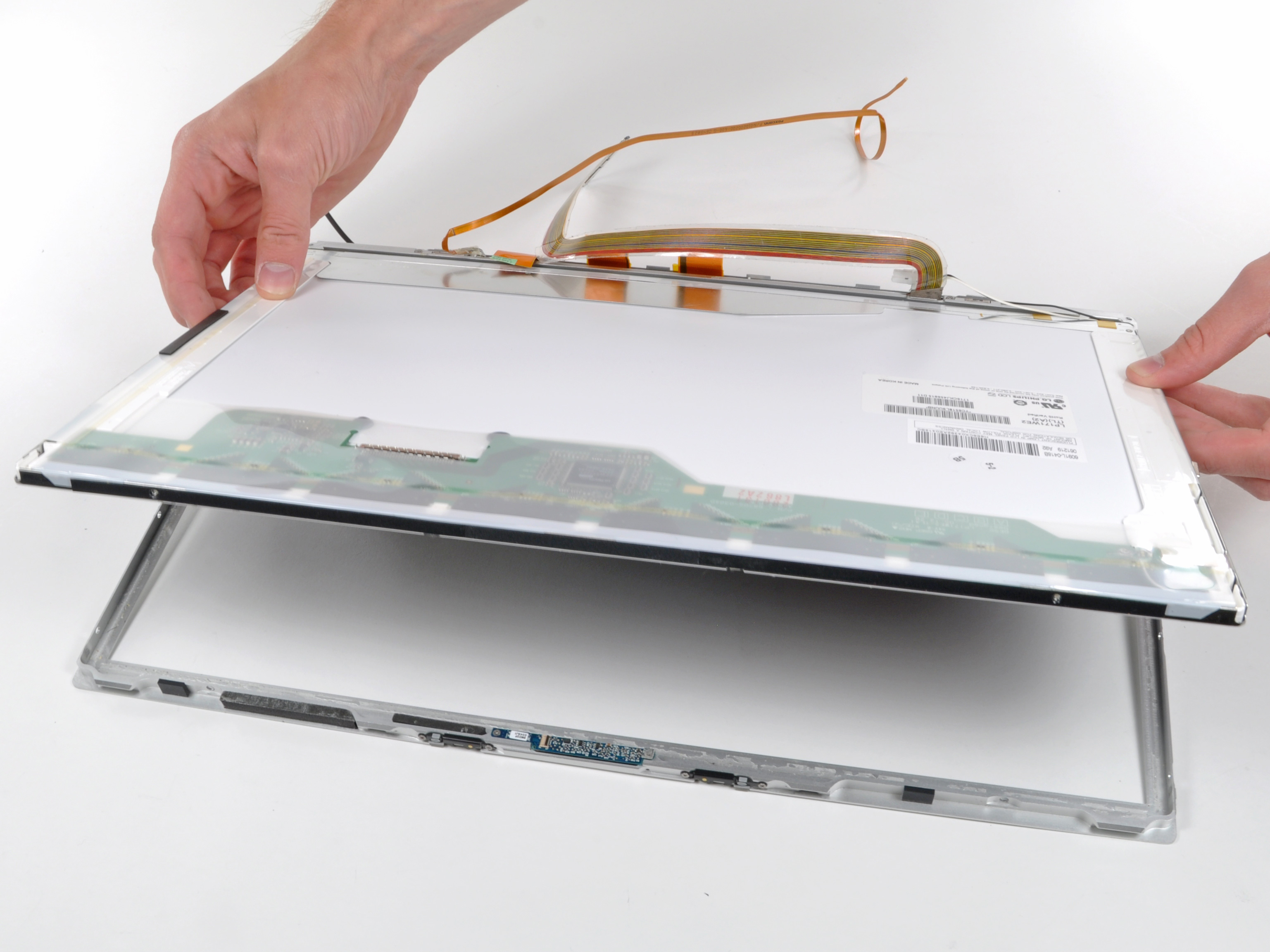

  32. MacBook Pro 17" Models A1151 A1212 A1229 and A1261 LCD Replacement: step 32, image 1 of 1
    • Now that the top and left edges are free, slightly lift the LCD out of the front bezel for enough room to pry the steel strip along the lower edge of the LCD away from the front bezel.
    • Pry along the lower edge of the LCD until it is freed from the adhesive on the front bezel.
  33. MacBook Pro 17" Models A1151 A1212 A1229 and A1261 LCD Replacement: step 33, image 1 of 1
    • Lift the LCD out of the front bezel, minding any cables that may get caught.
