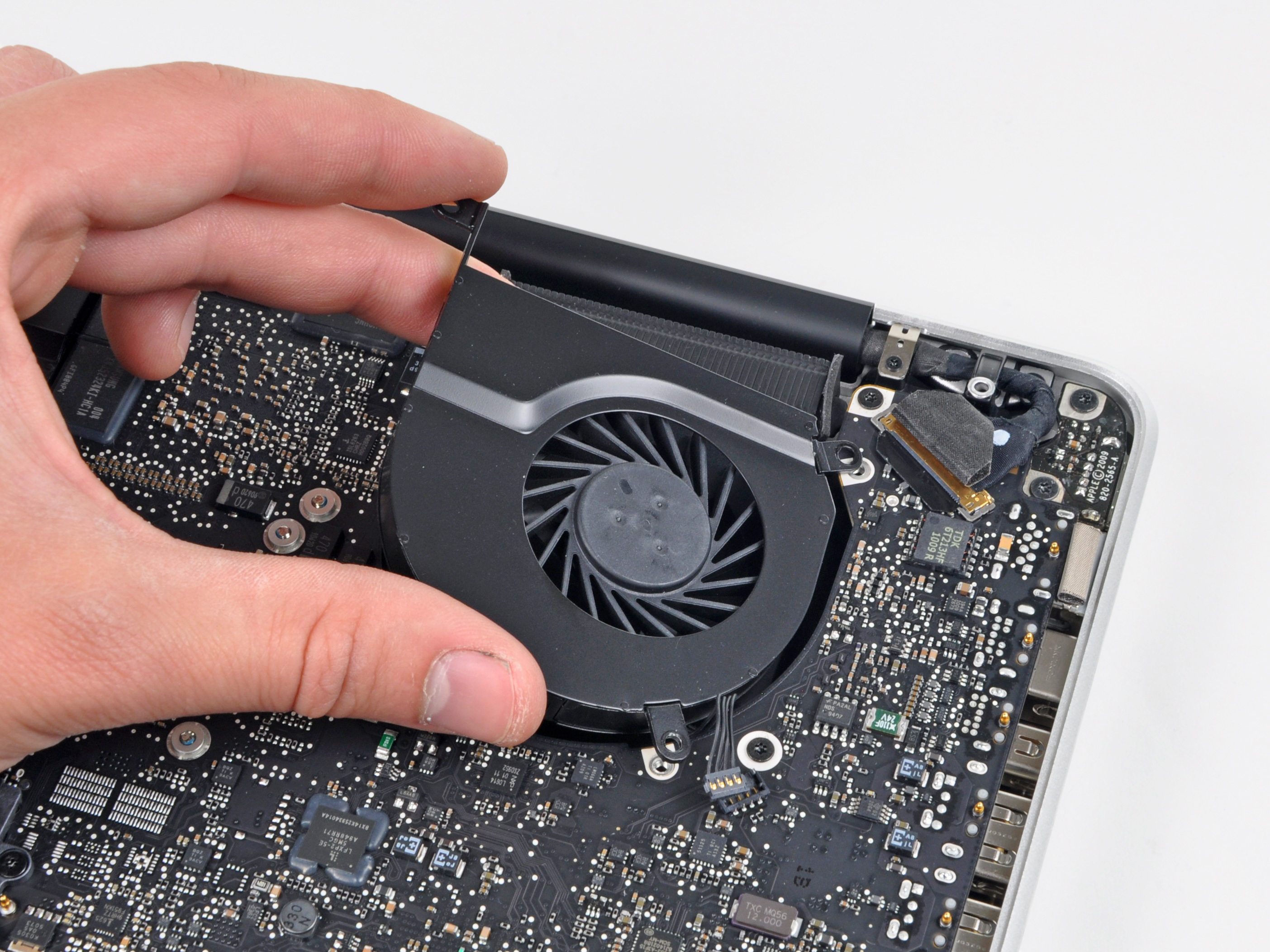

  5. MacBook Pro 15" Unibody Late 2011 Left Fan Replacement, Left Fan: step 5, image 1 of 1
    • Remove the three 3.4 mm T6 Torx screws securing the left fan to the logic board.
    • In some models, these T6 Torx screws may be 3.1 mm long.
  6. MacBook Pro 15" Unibody Late 2011 Left Fan Replacement: step 6, image 1 of 3 MacBook Pro 15" Unibody Late 2011 Left Fan Replacement: step 6, image 2 of 3 MacBook Pro 15" Unibody Late 2011 Left Fan Replacement: step 6, image 3 of 3
    • Use the flat end of a spudger to disconnect the left fan connector from the logic board.
    • It is useful to twist the spudger axially from beneath the fan cable wires to release the connector.
    • The fan socket and the fan connector can be seen in the second and third pictures. Be careful not to break the plastic fan socket off the logic board as you use your spudger to lift the fan connector straight up and out of its socket. The layout of the logic board shown in the second picture may look slightly different than your machine but the fan socket is the same.
  7. MacBook Pro 15" Unibody Late 2011 Left Fan Replacement: step 7, image 1 of 1
    • Lift the left fan out of the upper case.
