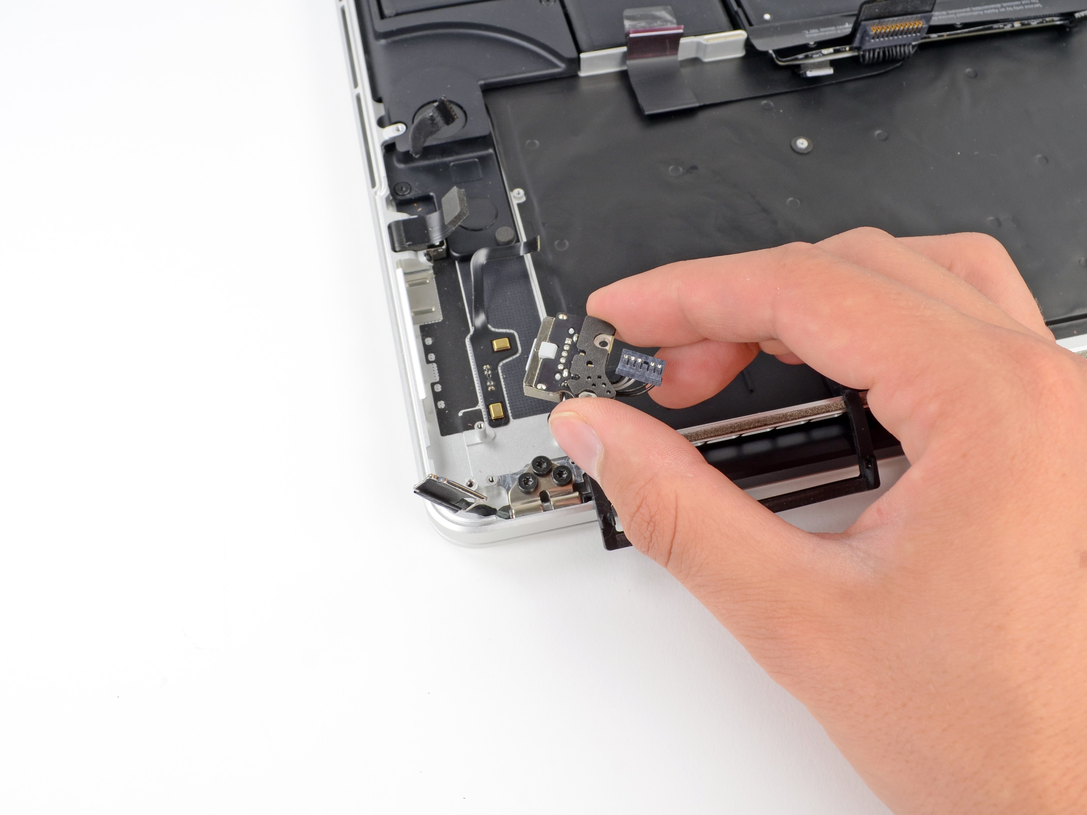

  34. MacBook Pro 15" Retina Display Mid 2012 MagSafe DC-In Board Replacement, MagSafe DC-In Board: step 34, image 1 of 2 MacBook Pro 15" Retina Display Mid 2012 MagSafe DC-In Board Replacement, MagSafe DC-In Board: step 34, image 2 of 2
    • Rotate the device 180 degrees to more easily access the rest of the internal components.
    • Remove the two 2.5 mm T5 Torx screws securing the MagSafe DC-In board to the upper case.
    • Slide the MagSafe DC-In board towards the right free it from its recess within the upper case.
    • Lift and remove the MagSafe DC-In board out of the upper case assembly.
