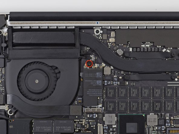

  • Use the tip of a spudger to detach the three antenna connectors up from their sockets on the AirPort board.

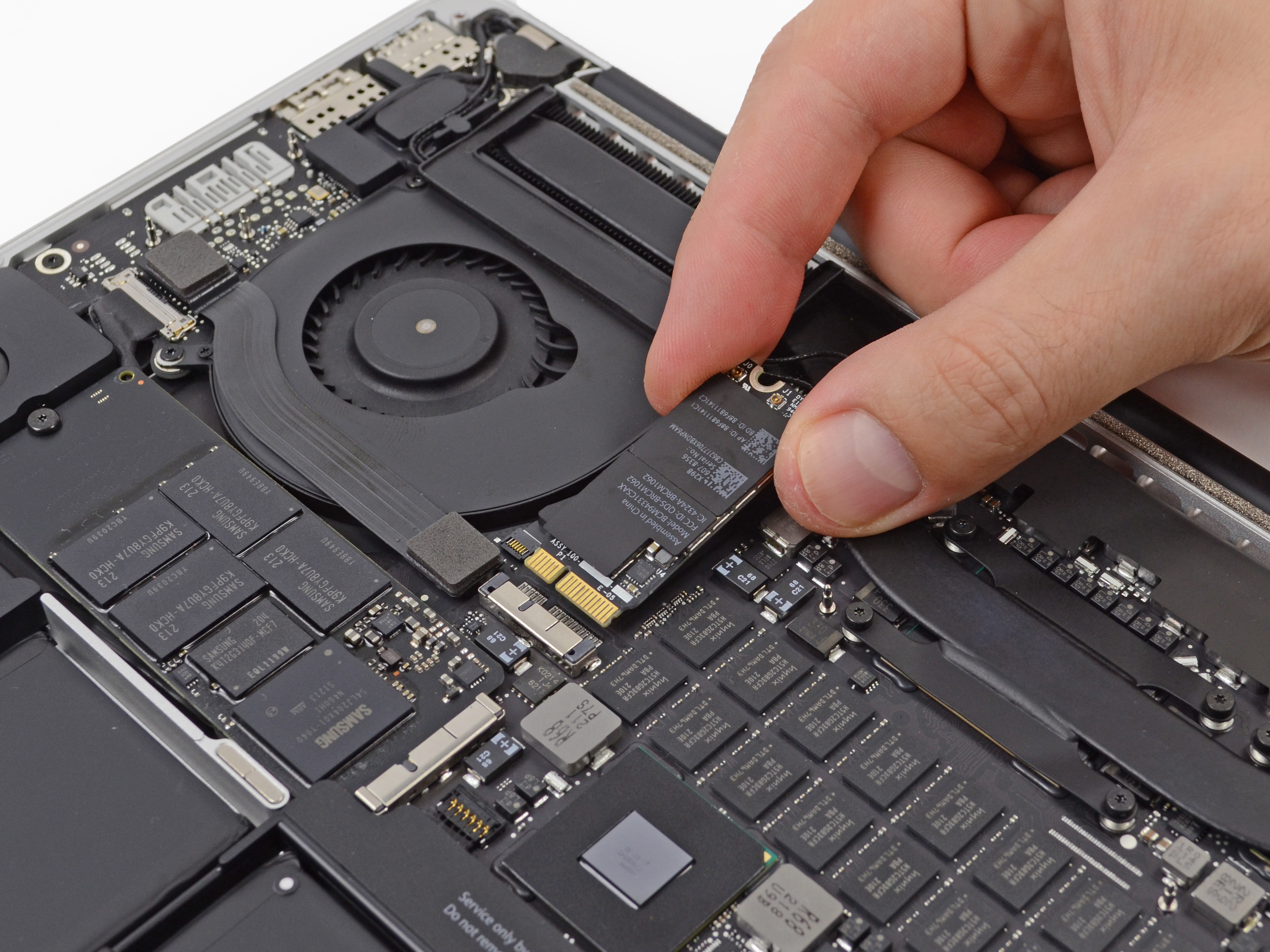

Image 1/2: Grasp the edges of the board and slide it out from its connector. Image 2/2: Lift and remove the AirPort board.
  • Remove the single 2.9 mm T5 Torx screw securing the AirPort board to the logic board.
  • Grasp the edges of the board and slide it out from its connector.
  • Lift and remove the AirPort board.
Is the Airport module a PCIe or Mini PCIe? Can it be replaced by a half length mPCIE model like in most PC laptops?
Ssamydla - Reply
There was a "sticky cushion thing" underneath the old Wifi card.Do i need to remove it and put it on the new card?.Is that absolute essential?.I forgot to do that and realised it later.Please advice.
verma1986 - Reply
