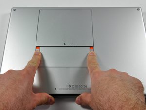

  • Use your fingers to push both battery release tabs away from the battery, and lift the battery out of the computer.
Before start, make a clone of your old HD into the new one, if you don't want to initiate a fresh copy. (Carbon Copy software is good).
ColmillodeChile - Reply
Besides using WD 500GB models, are the WD 640GB and WD 750GB (the 9.5mm thickness model) good to go for? I am still considering as I have heard from other websites on the computer does not draw enough power to power up the 640 and 750 as it has the clicking sound and the rainbow keeps appearing. Anyone has install one before yet?
Please advice. Appreciated! Thanks a million to all the Mac gurus out there!
Danny Lim -

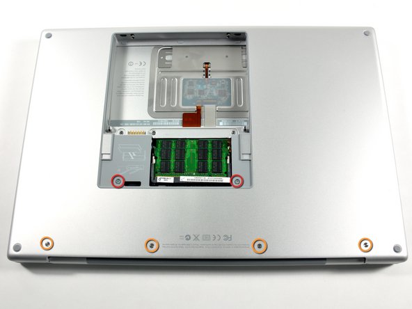

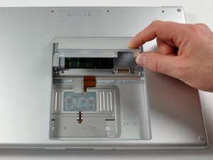

Image 1/2: Lift the memory door up enough to grip it and slide it toward you, pulling it away from the casing.
  • Remove the three identical 2mm PH000 Phillips screws from the memory door.
  • Lift the memory door up enough to grip it and slide it toward you, pulling it away from the casing.
These screws are different from the rest, they should be kept separate from the others.
Maarten Van Coile - Reply
Replacing RAM on an A1226: The instructions said Phillips #00, but the screwdriver that fit the RAM Shield screws for me was a Phillips #0.
dlyons - Reply

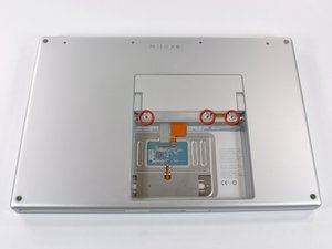

Image 1/1:
  • Remove the two 2.8 mm Phillips screws in the battery compartment near the latch.
Keep these two Philips screws separate. The screws are approximately 0.5mm shorter in length. When using one or two of the other longer screws in the battery compartment when reassembling, the lid will not open because the screw(s) do yam the lid button.
Peter van Nes - Reply
I had a logic board replaced by Apple (bad nVidia GPU), and believe it or not the Apple tech mixed up the screws. My latch did not work as good until I discovered and swapped the misplaced screws.
madmaxmedia - Reply

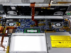

I removed the memory here as you would normally if you were changing it.
Mike Matthias - Reply
Image 1/1: Two 10 mm T6 Torx screws on either side of the RAM slot.
  • Remove the following 6 screws:
    • Two 10 mm T6 Torx screws on either side of the RAM slot.
    • Four 14.5 mm Phillips screws along the hinge.

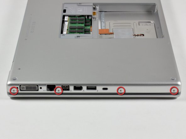

Image 1/1:
  • Remove the four 3.2 mm PH00 Phillips screws on the port side of the computer.
If you are using a muffin pan to keep removed parts separate (a method I recommend highly), note that Steps 5, 6, and 7 involve removing the same size screw—and thus you can put them all in the same pile. This is unlike just about every other part you will remove during this procedure.
Matt McCaffrey - Reply
Using shot glasses!
peterbcpa -
If you are a mac newbie like me take care when you reassemble not to insert a screw in the DVI display port screw holes (shame). I cannot manage to get it out anymore.
tai manu - Reply
I did the same thing once, and eventually got it out. Try tweezers, a screwdriver, magnets, holding the MBP on its side so gravity is working with you, etc. Eventually the little bugger will come out, you just have to keep working at it.
madmaxmedia -
It would be a good idea to put some sticky tape on those two DVI display port holes, so that you never make the mistake to insert (when reassemble) any of the screws!
genik - Reply
RE: Misplaced Screws in the DVI port, I was upgrading an early 2008 MacBook Pro with an SSD to get some more life out it, and sure enough, misplaced one of these small screws into the DVI port upon reassembly. Screwdrivers, shaking, gravity... nothing worked. UNTIL I went to my dad's house and his super-comprehensive workbench, where he found a small, high-pull magnet and the little bugger flew right out. Refrigerator magnets won't cut it, you will need a more powerful magnet, such as these: http://www.kjmagnetics.com/products.asp?...
Hope this helps someone... it was an easy solution to a frustrating problem
John Lee - Reply

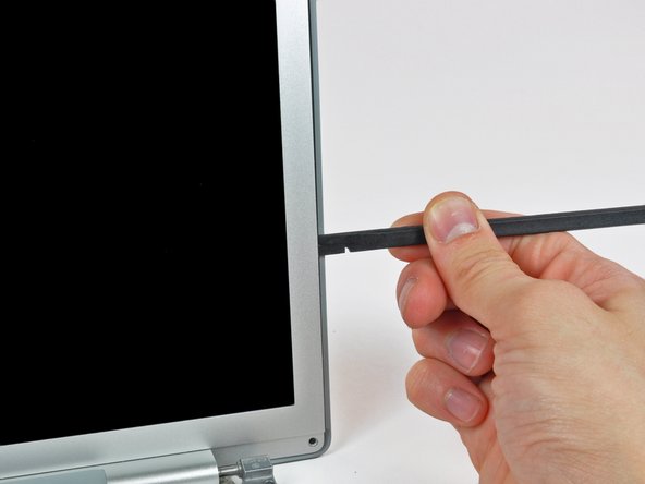

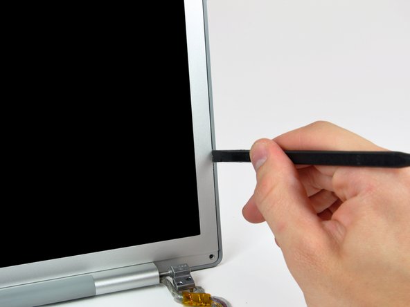

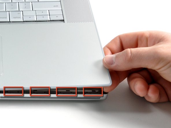

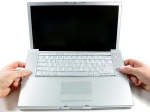

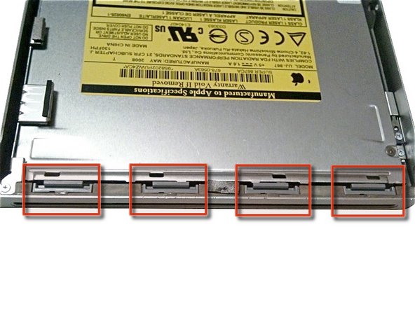

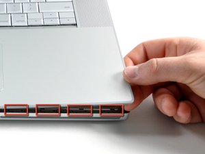

Image 1/3: Lift up at the rear of the case and work your fingers along the sides, freeing the case as you go. Once you have freed the sides, you may need to rock the case up and down to free the front of the upper case.
  • Do not yank the upper case off quickly. The case is attached to the logic board via a ribbon cable.
  • Lift up at the rear of the case and work your fingers along the sides, freeing the case as you go. Once you have freed the sides, you may need to rock the case up and down to free the front of the upper case.
  • There are four plastic clips above the DVD slot, and another above and to the left of the IR sensor. These clips can be very difficult to disengage without prying. They can also be difficult to re-engage during reassembly.
  • Reassembly Tip: Press down firmly on the tip of the top case above the location of each clip until you hear a snap to reseat them in their slots.
  • Reassembly Tip: The two center DVD clips will rarely snap back into place properly without help, and downward pressure will instead simply deform the frame around the DVD slot. Support the frame by inserting a plastic spudger into the DVD slot directly under the clip location until it is snug, then press down until you hear the snap.
The clips above the DVD slot (below the deck palm rest) are an absolute bear. They're hard to get released, and even harder to get back locked when you reassemble. (I've read to tilt the deck toward you when reassembling, inserting the front edge first, and press about an inch back from the edge to get all the front clips locked first before lowering the rest (back) of the deck.) No success for me yet, best of luck.
sonofray - Reply

Those clips on the front edge are very challenging. I have a set of nylon pry tools that are for taking apart car dashboards without scratching the vinyl or plastic. I was able to get a long one in from the side and twist it which freed the clips without damaging the plastic on the upper case or the aluminum on the lower case.
Putting it back together presented another challenge. When I first re-assembled it I think I pushed too hard over the DVD slot and accidentally bent the metal down. I was able to bend it back up using a thicker part of those same nylon pry tools, and then i was able to get it snapped back down successfully. Had I known this would happen, I would have just put the nylon tool in the slot to reinforce the metal as I was snapping the case back down.
Nick - Reply
As everyone has said, the front clips by the DVD can be really tight. Use the spudger to pry the top and bottom halves apart. Slow work it in from one side to separate the top and bottom.
When reassembling the case, work the front clips by the DVD drive back in first. Once you slide them back in, the rest of the case fits easily.
Ted Wise - Reply
i've used an old atm card, it works fine.
rotarypot - Reply
I had a lot of trouble with getting those clips to lock in place again when reassembling. The way I eventually did it was to wedge something into the front of the CD/DVD slot so that I wouldn't warp the laptop casing. I used the end of a pen; when wedged in the tip of the pen was the right height to not support the casing above and below the CD/DVD slot and not allow it to warp.
I simply ensured the pen was aligned with one particular clip, lifted the laptop slightly, and squeezed the top and bottom edge of the laptop casing very firmly at that point. Each clip clicked in quite easily doing it this way. Just remember to move the pen (or whatever you are using) along to whichever clip you are clicking in.
David - Reply

I would agree with everyone that the clips above the DVD drive are very temperamental. They came off easily for me but were a pain getting to clip back in place correctly.
Make sure you have the front clipped on securely before screwing the case back together otherwise the lid will not close properly.
Nicolas - Reply

There is a fifth plastic clip between the IR sensor and the screw hole. (ie. 1 cm left of the IR sensor)
On the top of the case mark the center of each of the four clips that are over the CD slot and the one clip to the left of the latch with a pencil. When re-installing the top case apply pressure over the clip to the left of the latch until you hear a snap. For the four clips over the CD slot, upend the entire case. Then insert the flat end of the spudger into the CD slot under the center of each clip. Apply pressure from the top of the case while providing support with the spudger in the CD slot until the clip snaps in. This will minimize the chances of bending the CD slot which would prevent CDs from ejecting.
danno - Reply
Take care reassembling new the DVD drive. It's easy to bend the top piece of metal down (the one that engages the clips) and your DVD can get stuck occasional ejecting. Very annoying. Maybe give it a little prophylactic bend upward. I placed a blunt letter opener in the slot and torqued it, while applying downward pressure from the top deck... This allowed the clips to engage nicely without bending this piece down.

I've opened these up many, many times, and by far the easiest method I have found to disengage the front clips is as follows:
Lift up the top case by the rear corners near the hinge, keep lifting so the top case is tilting towards you. You will feel some resistance, but keep lifting and you will hear the clips disengage with a 'snap'. Doing it this way should not bend the top case metal or loosen the spacing between the top case metal and plastic trim. The clips will not break, they will still engage when you put the top case back on.
It basically takes me 5 or 10 seconds to take off the top case now, and the case goes back on nice and tight as before.
YMMV and all that, but that's my experience.
madmaxmedia - Reply

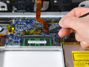

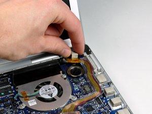

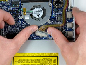

Image 1/2: Note: It is possible to replace the hard drive without disconnecting the keyboard from the chassis, but it will need to be held upright to keep it out of the way, while still allowing you both hands to work on the drive removal. Be careful when removing the keyboard-trackpad ribbon cable to ensure that the rear of the upper case is disengaged from the area near the hinge. It is easy to accidentally bend the screw receivers on either side of the keyboard.
  • Disconnect the trackpad and keyboard ribbon cable from the logic board, removing tape as necessary.
  • Note: It is possible to replace the hard drive without disconnecting the keyboard from the chassis, but it will need to be held upright to keep it out of the way, while still allowing you both hands to work on the drive removal. Be careful when removing the keyboard-trackpad ribbon cable to ensure that the rear of the upper case is disengaged from the area near the hinge. It is easy to accidentally bend the screw receivers on either side of the keyboard.
    • Remove the upper case.
If you does not have the spudger, use the Dremel to file a wooden piece
(Chinese stick maybe) to transform in a spatula. Works fine for me
If you don't have the magic "spudger," try using a plastic (eating) knife.
jpkjpkjpk - Reply
I read that you can actually also use the corner of a credit card. I didn't have a spudger and this worked perfectly for me. If you hold the card quite close to the corner and it has just the right amount of flex.
David - Reply
You may be able to unplug the ribbon connector by lifting each end of the tape.
MrSafety - Reply

To unplug the cable, pull the black connector straight up from the logic board.

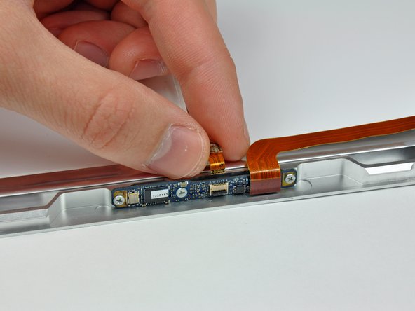

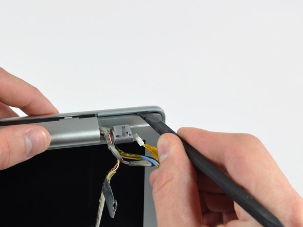

Image 1/1: Apple was kind enough to include a label showing where each color antenna cable plugs in - just make sure to look at this when reconnecting the antenna cables.
  • Disconnect the two or three antenna cables attached to the Airport Extreme card. Depending on your model, one of the three cables may be unused and capped with a black shrink tube.
  • Apple was kind enough to include a label showing where each color antenna cable plugs in - just make sure to look at this when reconnecting the antenna cables.

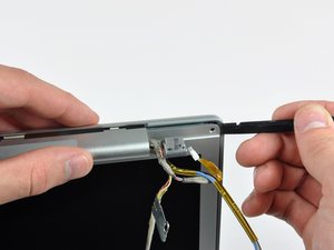

Image 1/1:
  • Deroute the Airport antenna cables from their channel in the left speaker.

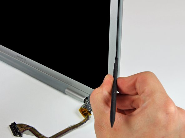

Image 1/1:

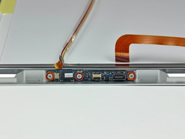

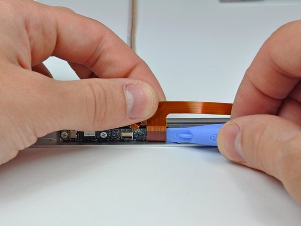

  • Disconnect the iSight cable from the logic board by sliding the cable to the left and out of its connector.

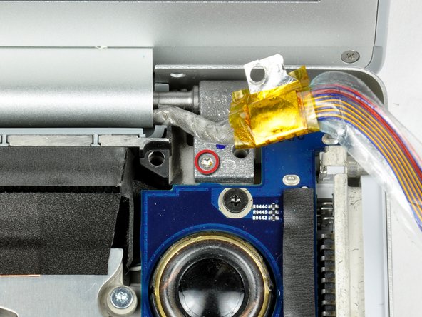

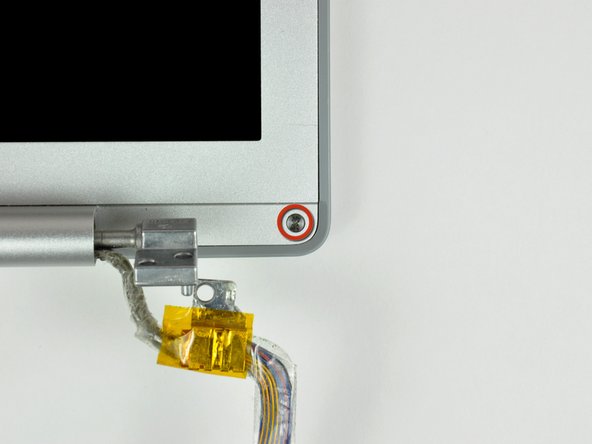

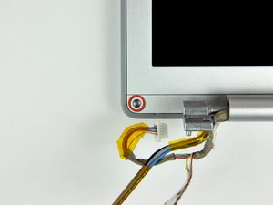

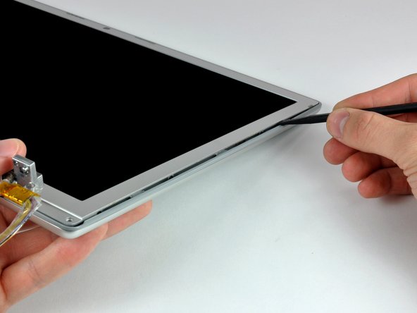

Image 1/1: One 9.5 mm silver T6 Torx screw with threads on only 3 mm of the shaft on the inside of the display hinges.
  • Support the display with one hand while removing the following screws:

  • Disconnect the inverter cable from the left I/O board by placing a spudger beneath the cable and lifting up.
Image 1/2: Remove the foam bumper from the top of the right hinge of the display.
  • Disconnect the display data cable from the logic board.

  • Remove the silver 9.2 mm T6 Torx securing the ground loop in the display data cable to the casing.
  • Support the display with one hand while removing the following screw:
    • One 9.5 mm silver T6 Torx screw with threads on only 3 mm of the shaft on the inside of the display hinges.

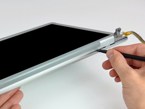

  • Remove the 4.5 mm Phillips screws from the lower left and right corners of the display (two screws total). These screws have a .8 mm thick head.

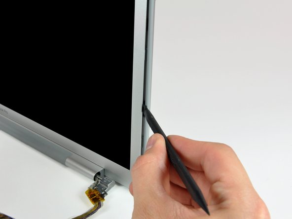

Image 1/3: Do not insert your spudger between the plastic strip and the rear bezel.
  • Insert the flat end of a spudger perpendicular to the face of the display between the plastic strip attached to the rear bezel and the front bezel.
  • Do not insert your spudger between the plastic strip and the rear bezel.
  • With the spudger still inserted, rotate it away from the display to separate the front and rear bezels.
  • Work along the right edge of the display until the rear bezel is evenly separated from the front bezel.
Image 1/2: Pry the rear bezel away from the front bezel to slightly separate the bottom edge of the rear display bezel.

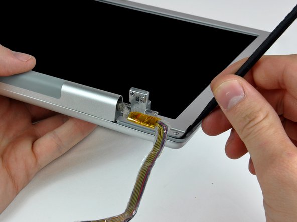

  • Insert your spudger between the front and rear display bezels at the lower right corner of the display.
  • Pry the rear bezel away from the front bezel to slightly separate the bottom edge of the rear display bezel.

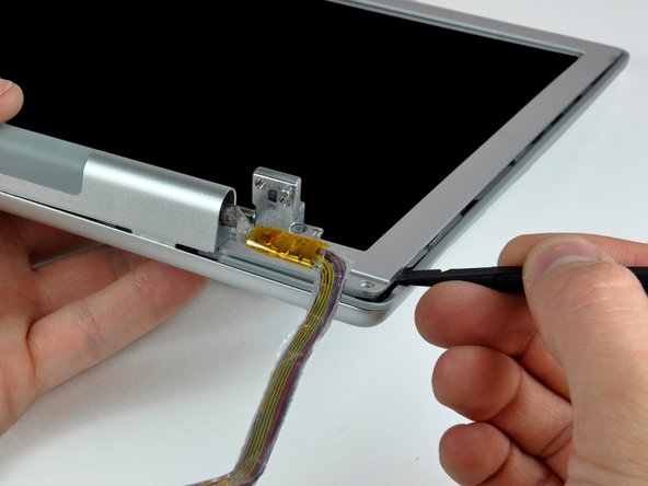

Image 1/2: Twist the spudger to separate the lower edge of the rear display bezel from the clutch cover.
  • Insert the flat end of a spudger into the gap between the rear display bezel and the clutch cover.
  • Twist the spudger to separate the lower edge of the rear display bezel from the clutch cover.
  • Work along the lower edge of the rear bezel until it is evenly separated from the clutch cover.

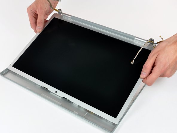

Image 1/1: Go here for the guide to continue replacing the screen:  [guide|1287]

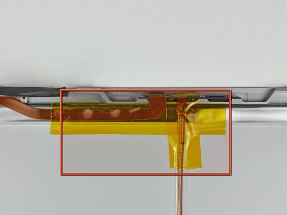

Image 1/1: It is not necessary to completely remove this piece of tape.
  • Peel the large piece of tape near the display latch off the top edge of the LCD.
  • It is not necessary to completely remove this piece of tape.

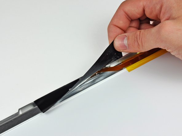

Image 1/1: Hold the camera cable down while removing the tape.
  • Remove the two pieces of tape covering the camera cable.
  • Hold the camera cable down while removing the tape.

  • Use the edge of a plastic opening tool to flip up the ZIF cable lock.
  • Pull the camera cable out of its socket.

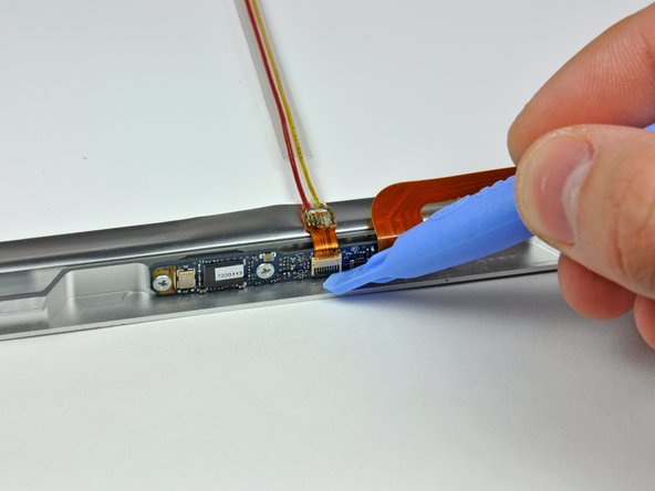

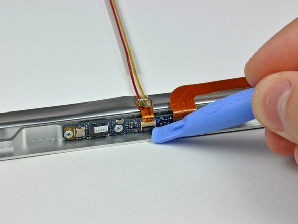

Image 1/1:

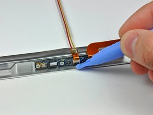

  • Use a plastic opening tool to pry the camera ribbon cable away from the camera board.

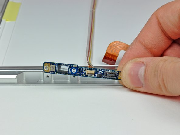

Image 1/2: Remove the camera board from the front display bezel.
  • Remove the three Phillips screws securing the camera board to the front display bezel.
  • Remove the camera board from the front display bezel.
