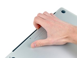

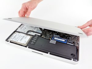

Image 1/2: Remove the lower case.
  • Use your fingers to pry the lower case away from the body of the MacBook near the vent.
  • Remove the lower case.

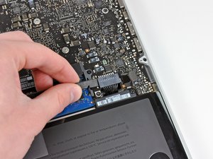

Image 1/2: It is useful to pry upward on both short sides of the connector to "walk" it out of its socket. Be careful with the corners of the connectors, they can be easily broken off.
  • Use the edge of a spudger to pry the battery connector upwards from its socket on the logic board.
  • It is useful to pry upward on both short sides of the connector to "walk" it out of its socket. Be careful with the corners of the connectors, they can be easily broken off.
Is this step of removing the battery connector required?
manodh - Reply
yes - as with disassembly of any electronic component you have to remove any power source. You don't want to accidentally turn the Mac on
khull -
This step is not really required. Apple does not recommend it.
Steven Layton - Reply

Rather than be careful of the corners of the connector i would say don't use the spudger anywhere near the corners. While the corner looks like the obvious place to begin to pry it up from, it will break. Levering from the sides as the instructions suggest works well.
ausmkv - Reply

I would recommend it, one careless short and the whole board is dead......
John - Reply
simply remove the battery rather than disconnecting the cable
toiu - Reply
Don't know what the deal is with the battery, but this IS a necessary step to keep from frying the logic Board if you accidentally touch something and short it out. I did this step every time during my troubleshooting and The battery was ALWAYS recognized by the system the next time I turned the MBP on. So be safe and don't fry your logic board in the process...
fasthans - Reply
Prying the battery connector off does not take much force. I did exactly what the guide suggested (walked it off back and forth) with the spudger without any problems. Just be very gentle, much like with anything inside laptops, they are very fragile and need to be worked with carefully. A+ instructions, battery replacement was a success.
aekinaka - Reply
Installed/upgraded 4gb RAM to the system maximum 16gb and installed a 500 gb SSD today....DID NOT disconnect the battery cable....no issues at all when I powered back up. Then did a clean install of OSX Yosemite....next I used a time machine backup to put all my stuff back on the new HD. From start to finish it took about 4 hours. Macbook boots up right at 16 seconds now.
MacProUser - Reply

Its a lot easier and safer (corner wise) to pry it using the flat side of the black spudger directly in front of the connector (don't go/use the corners) very easily you will be able to pry it further by inserting the spudger into a better and thicker plastic section of the connector
Ed Oliver - Reply
DON'T remove the Battery Cable, you risk the battery NOT being recognised when you start the Mac up again, or breaking it!! More to the point, APPLE DOES NOT RECOMMEND THIS, so don't do it! I Installed 2x 8GB ( 16Gb total) of Crucial Mac RAM at 1333Mhz for my Late 2011 MacBook Pro, and it works beautifully, fully recognised and working well. I followed these instructions, but as Apple didnt recommend disconnecting the battery, I skipped this step, and as well as taking less time, nothing was damaged or broken, and everything works perfectly!!! Just make sure that you DISCHARGE ALL STATIC ELECTRICITY FROM YOUR HANDS, by touching a metal surface in the Mac. Apple recommends the edge of the Optical Disk Drive ( Big silver thing ) before touching any parts. Also, Take care removing the RAM out of its packet, DO NOT touch the Gold connectors, and hold the RAM by the edges. Finally, be PATIENT, GENTLE and it should all go perfectly. I managed it first time, with no technical ability, so follow my advice. Good luck!
Bradley Marks - Reply
Followed the tuto Step by step. Disconnected the battery (quite easily).
No problem when I lit the Mac on again. Battery's here, date's right.
nichoferr - Reply

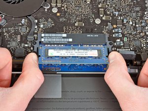

Image 1/2: The RAM chip should "pop" up slightly from its socket.
  • Pull the two RAM retaining arms away from the center of the RAM chip.
  • The RAM chip should "pop" up slightly from its socket.

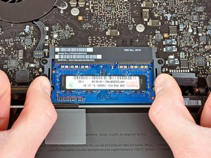

Image 1/1: Repeat this process to remove the second RAM chip.
  • Pull the RAM stick out of its socket.
  • Repeat this process to remove the second RAM chip.
After replacing the RAM my macbook did not start anymore. Only if I take out one Ram it works. Does anyone knows why.
joelcroese - Reply
Hello Joelcroese, have you a issue about your problem, because i have actually this problem ? ... Thanks for your feed back.
Remy Duprat -
Make sure both your RAM chips are running at the same speed - don't know about the Macbook but it will cause other machines to not recognize the RAM at all or only pick up one stick -
melindaruth -
I am afraid of this too!
ingwis - Reply
Is the channel configuration of your ram sticks correct? Mac needs 9-9-9-24 channel configuration. Something like Corsair Mac Memory or the kit that iFixit provides are in the correct channel configuration.
skimmilk05 - Reply
Just to point out:
1. Do not press again the locker.
2. Changed the bottom RAM first.
3. Put nicely, gently to the slot. Cue for you. You must see the label of the manufacture.
4. Close everything.
5. Switch the Mac and check "Finder>About my Mac" show the correct RAM.
Jay Nandu - Reply

Hello!
There is a photo of inside of lower case?
i buy second-hand mbp mid 2012 13" with 16 Gb RAM, and HWMonitor shows memory module 1 temp around 75 - 77 celsium, who is a bit too high, i think.
open lower case, clean off dust, and see on a lower case inside, in place, where is memory modules, is additional insulation foam layer. dont know - that is from apple, or previous owner put that on its own?
in any case 77 celsium on memory is too high temp, i think. have also 2011 late mbp 13" also with 16 Gb ram, and there typical temp on mem module 1 shows about 52 -55 celsium - almost as half lower than on mid 2012....
john - Reply
