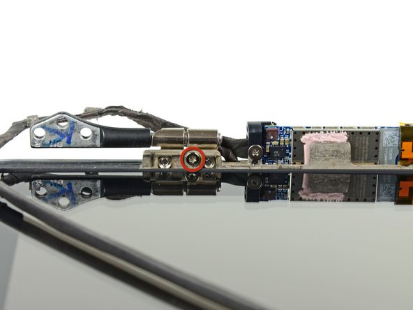

  18. MacBook Pro 13" Unibody Mid 2010 Right Clutch Hinge Replacement, Right Clutch Hinge: step 18, image 1 of 1
    • Remove the single 5.2 mm T6 Torx screw securing the right clutch hinge nearest the display glass.

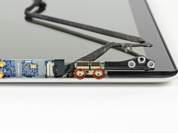

  19. MacBook Pro 13" Unibody Mid 2010 Right Clutch Hinge Replacement: step 19, image 1 of 1
    • Remove the two remaining 5.2 mm T6 Torx screws securing the right clutch hinge to the display.

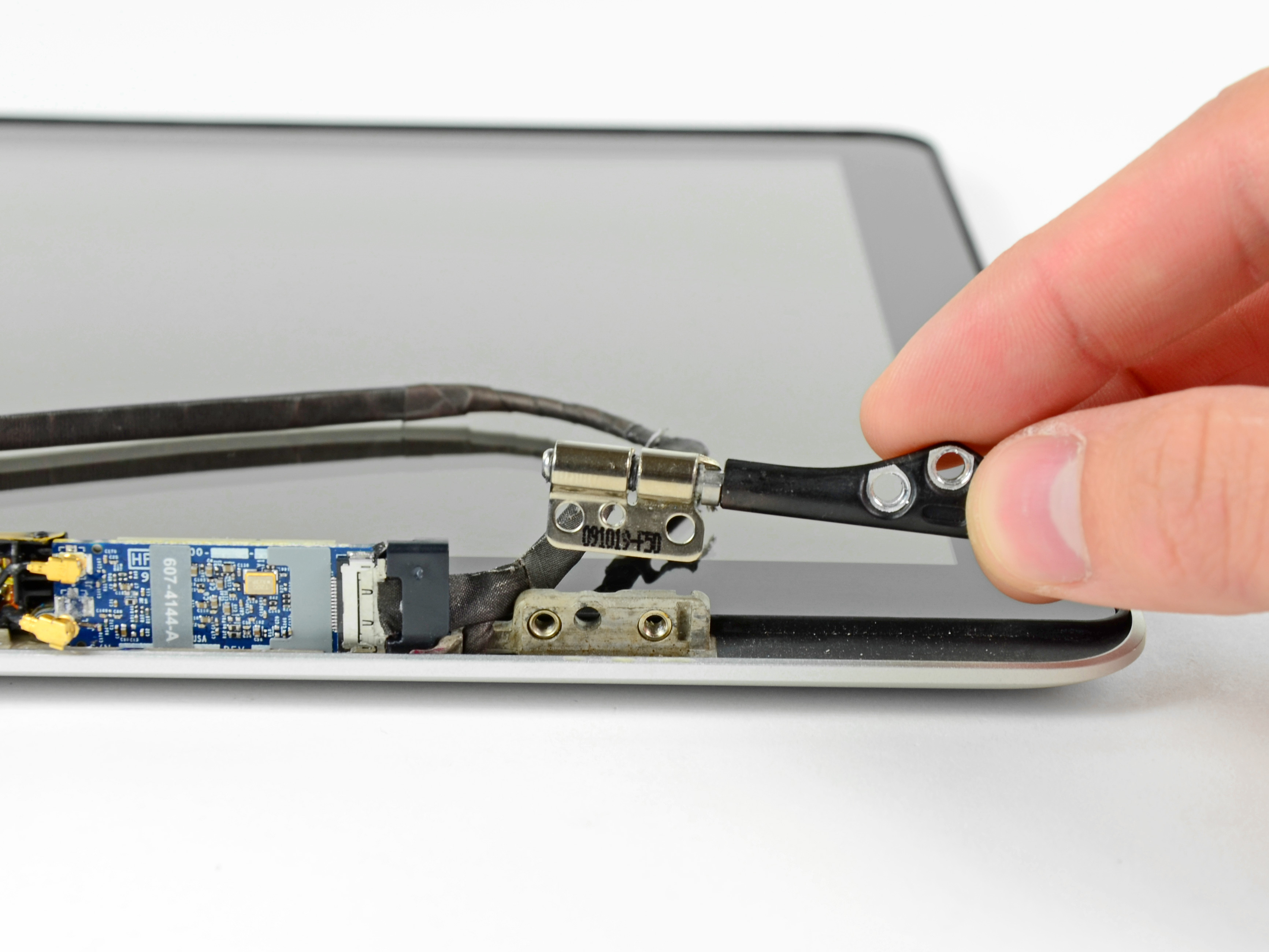

  20. MacBook Pro 13" Unibody Mid 2010 Right Clutch Hinge Replacement: step 20, image 1 of 1
    • Remove the right clutch hinge.

If you don't use loctite on your screw threads or some other equivalent your hinges will come loose again! The hinge is probably exposed to more vibration and use than any other mechanical system on your computer. Three months after performing this repair to tighten my wobbly hinges, they are loose again! Buy some thread locking adhesive, save yourself the pain of a double repair job!
