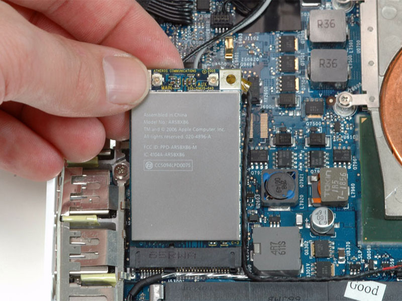

Wi-Fi connectivity not what it used to be? A new AirPort Extreme 802.11g card might alleviate your woes.

The guide is fantastic and the Airport Extreme Card upgrade took me less than an hour to complete. It wasn't very difficult. Some pointers: read the entire guide before undertaking the project; keep the screws from each step separated in labeled containers; buy a spludger if you don't already have one; keep a tweezer handy for the tiny screws; and take your time separating the keyboard from the computer so as to not crack/break the plastic bezel.

Image 1/1:
  • Disconnect the two antenna cables from the Airport card on the left side of the computer.
Image 1/1: One 3 mm Phillips from the left side.
  • Remove the following 2 screws from the Airport card:
    • One 3 mm Phillips from the left side.
    • One 8 mm Phillips from the right side.
Image 1/1:
  • Grasp the Airport card at its top and slide it toward the screen and out of the computer.
Yeah all done, and computer is wireless once again!!
