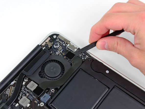

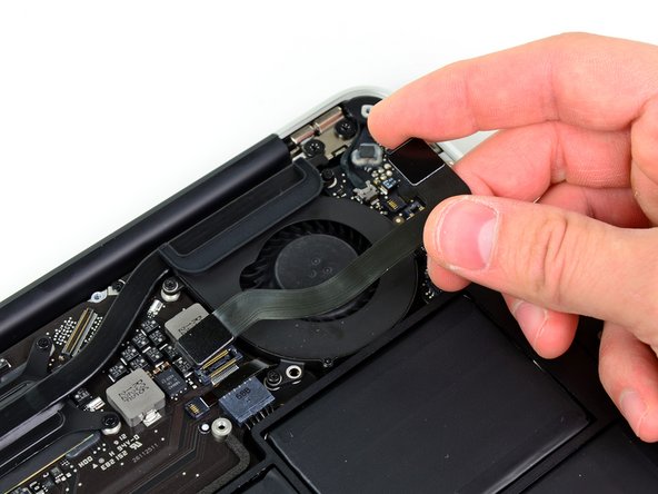

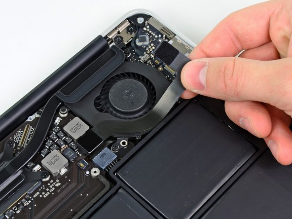

  • Use the flat end of a spudger to pry the I/O board cable up from its socket on the I/O board.

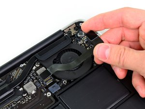

Image 1/1:
  • Peel the I/O board cable up from the adhesive securing it to the fan.

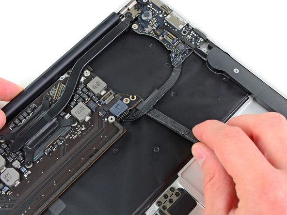

Image 1/2: Be sure to lift straight up on the connector as you disconnect it from its socket. The socket is very deep on the logic board and prying it from side to side may damage the logic board
  • Use the flat end of a spudger to lift the I/O board connector up and out of its socket on the logic board
  • Be sure to lift straight up on the connector as you disconnect it from its socket. The socket is very deep on the logic board and prying it from side to side may damage the logic board
  • Remove the I/O board cable.

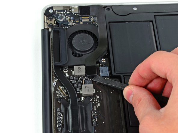

Image 1/1: Be sure you are prying up on the hinged retaining flap, '''not''' the socket itself.
  • Use the tip of a spudger to carefully flip up the retaining flap on the fan cable ZIF socket.

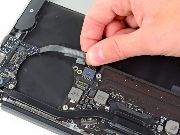

Image 1/2: Pull the cable parallel to the face of the logic board toward the front edge of the Air.
  • Disconnect the I/O board by pulling the power cable away from its socket on the logic board.
  • Pull the cable parallel to the face of the logic board toward the front edge of the Air.

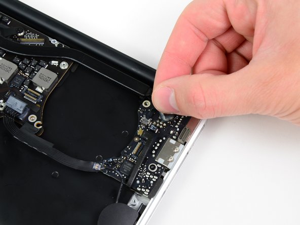

Image 1/2: Be sure you are prying up on the retaining flap, '''not''' the socket itself.
  • Use the tip of a spudger to carefully flip up the retaining flap on the microphone cable ZIF socket.
  • Be sure you are prying up on the retaining flap, not the socket itself.
  • Pull the microphone ribbon cable straight out of its socket.

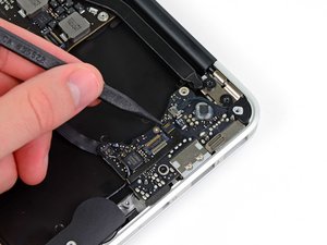

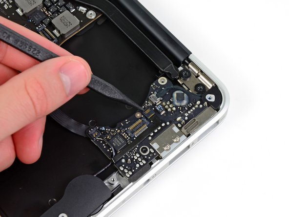

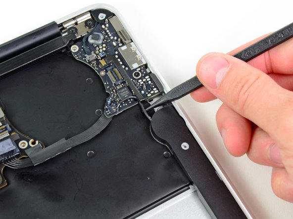

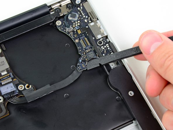

Image 1/2: Pry up from beneath the wires.
  • Use the flat end of a spudger to pry the left speaker cable connector up and out of its socket on the I/O board.
  • Pry up from beneath the wires.

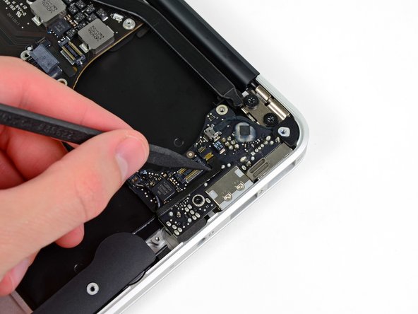

Image 1/1: Do not lift upward on this cable as you disconnect it, as its socket may break off the logic board.
  • Pull the camera cable parallel to the face of the I/O board toward the rear edge of the Air to disconnect it from its socket.
  • Do not lift upward on this cable as you disconnect it, as its socket may break off the logic board.

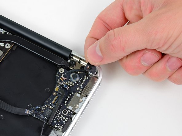

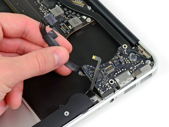

Image 1/1:
  • Remove the single 3.6 mm T5 Torx screw securing the I/O board to the upper case.
Image 1/1:
  • Carefully lift the I/O board from its edge nearest the logic board and remove it from the upper case.
