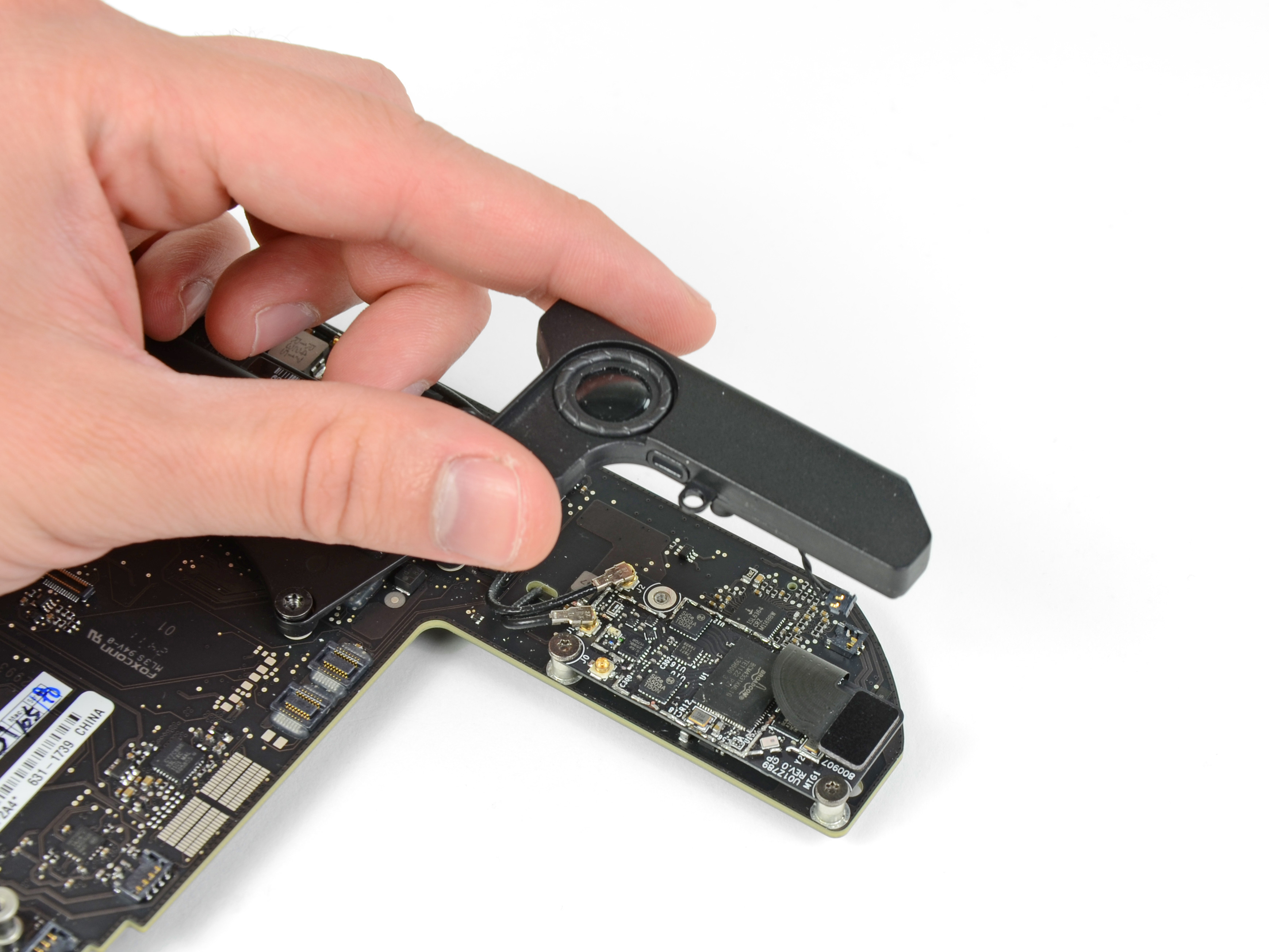

  18. Mac mini Late 2012 Speaker Replacement, Speaker: step 18, image 1 of 1
    • Remove the following two screws securing the speaker to the logic board assembly:
    • One 3.5 mm T6 Torx screw
    • One 3.7 mm T6 Torx screw
  19. Mac mini Late 2012 Speaker Replacement: step 19, image 1 of 2 Mac mini Late 2012 Speaker Replacement: step 19, image 2 of 2
    • Lift but do not remove the speaker assembly, as it still remains connected to the logic board via the speaker connector.
    • Carefully lift the speaker wires upward to lift the speaker connector up and out of its socket on the logic board.
    • Lift and remove the speaker away from the logic board.
