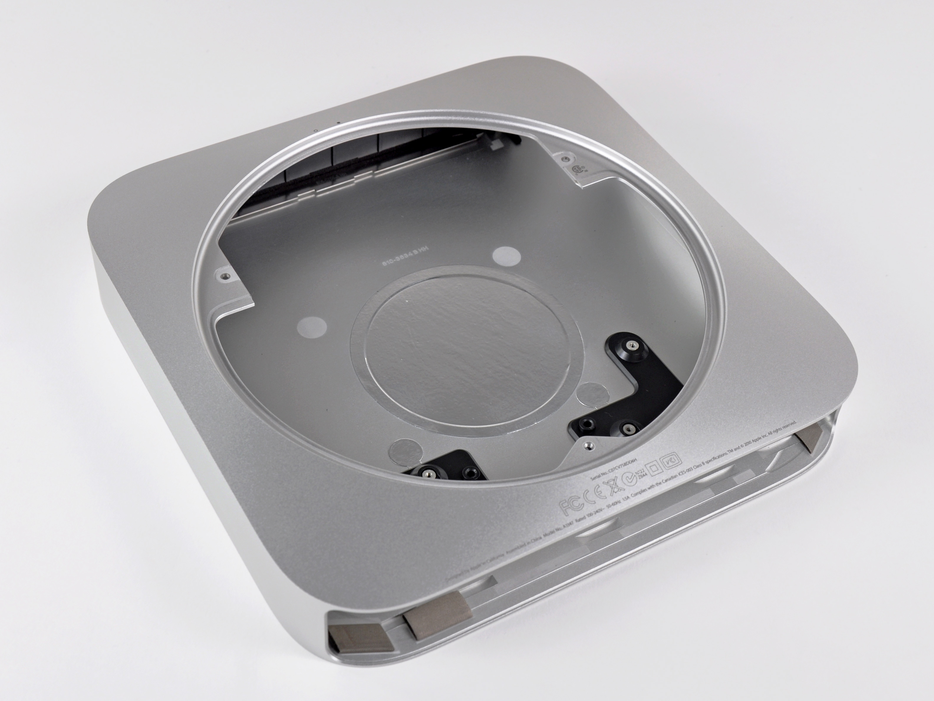

Use this guide to completely replace your mini's outer case. Replacing the outer case requires removal of every component in your mini.
Place your thumbs in the depressions cut into the bottom cover.
Rotate the bottom cover counter-clockwise until the white dot painted on the bottom cover is aligned with the ring inscribed on the outer case.
Tilt the mini enough to allow the bottom cover to fall away from the outer case.
Remove the bottom cover and set it aside.

Remove the 7.9 mm T6 Torx screw securing the hard drive tray to the outer case.
Remove the hard drive tray from the outer case.
With virtually everything removed from the outer case, this is a good time to look toward the front of the case to notice the two locations where the standoffs from the "lower" drive normally fit. You'll want to be aware of this when reinstalling that drive later.
Outer case remains.
