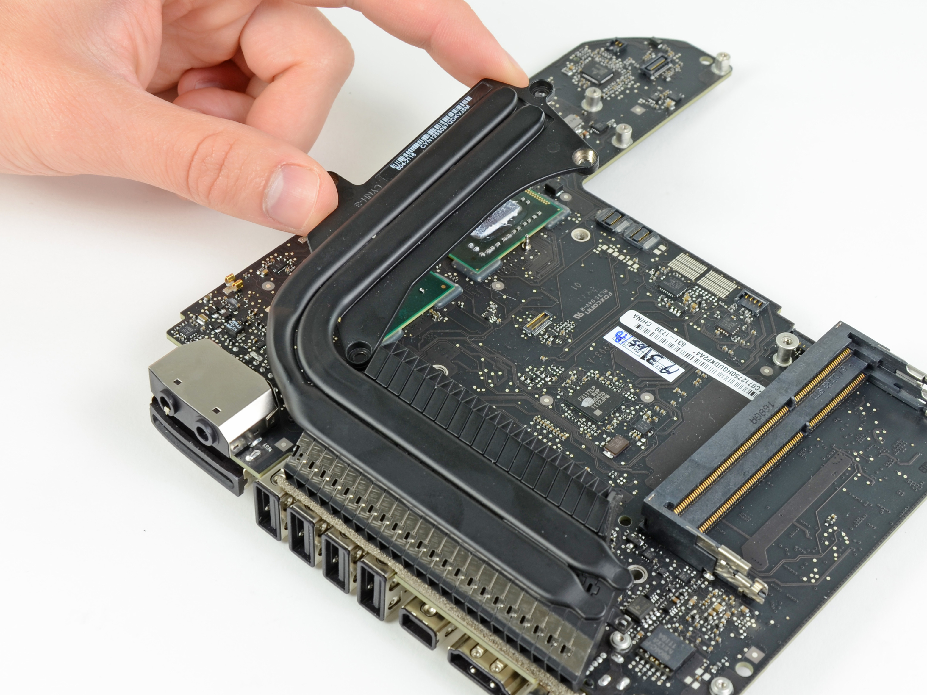

Remove the heat sink from the logic board, minding any cables that may get caught.
  • Remove the heat sink from the logic board, minding any cables that may get caught.
  • If the heat sink appears to be stuck to the logic board after removing all screws, it may be helpful to use a spudger to separate the two components.
  • If you need to mount the heat sink back onto the logic board, we have a thermal paste guide that makes replacing the thermal compound easy.
  • Logic board remains.
