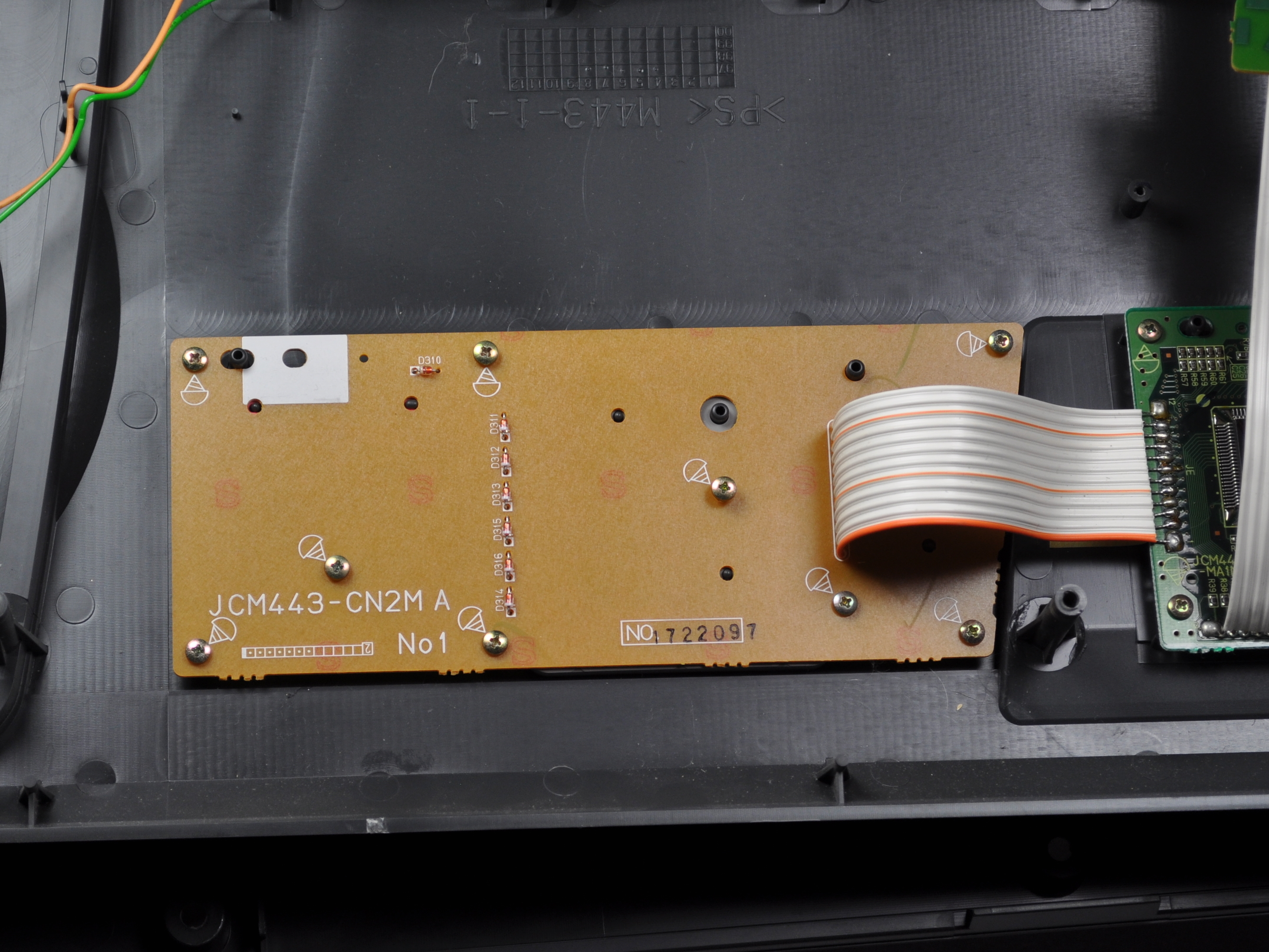

  4. Casio CTK-501 Buttons Replacement, Buttons: step 4, image 1 of 1
    • Remove the nine screws from the brown circuit board that has an attached ribbon, with a #0 Phillips.

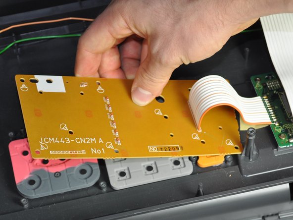

  5. Casio CTK-501 Buttons Replacement: step 5, image 1 of 1
    • Remove the circuit board, by pulling upwards.

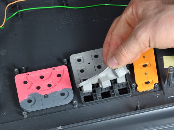

  6. Casio CTK-501 Buttons Replacement: step 6, image 1 of 1
    • Remove the buttons.
  7. Casio CTK-501 Buttons Replacement: step 7, image 1 of 1
    • Place the new buttons into the slot, and push downward in the slot.
