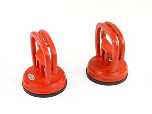

Image 1/3: To attach the [product|IF145-023|suction cups], first position the suction cup with the movable handle parallel to the face of the glass panel (as highlighted in the second picture). Image 2/3: While lightly holding the suction cup against the glass, raise the movable handle until it is parallel with the other handle (as highlighted by the third picture). Image 3/3: If your suction cups refuse to stick, try cleaning both the glass panel and the suction cup with a damp soft, lint-free cloth.  (Dampen with distilled water, and if needed, an equal ratio of distilled water and white vinegar for best results.)
  • Stick a heavy-duty suction cup near each of the two top corners of the glass panel.
  • To attach the suction cups, first position the suction cup with the movable handle parallel to the face of the glass panel (as highlighted in the second picture).
  • While lightly holding the suction cup against the glass, raise the movable handle until it is parallel with the other handle (as highlighted by the third picture).
  • If your suction cups refuse to stick, try cleaning both the glass panel and the suction cup with a damp soft, lint-free cloth. (Dampen with distilled water, and if needed, an equal ratio of distilled water and white vinegar for best results.)
  • Do not use the suction cups to carry the display glass because if one of them fails to stick, you could drop the screen and break it.

Yes, you don't need the specific suction cups to remove the display cover - it's held on by magnets, and if you start at the center by the iSight you can work out to the edges and remove it. I had an iPhone screen suction cup around and it helped with balancing the screen when you pull it out fully, but by no ways is it required.

I used a plunger (clean first ;-) to get the screen off, and http://exirion.net/ssdfanctrl/ for fan control.

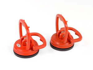

Image 1/3: Pull the glass panel away from the lower edge of the iMac and carefully set it aside. Image 2/3: Don't use the suction cups to carry the glass panel—if either one loses its grip, the panel could fall and break. Image 3/3: After setting the glass panel down safely, be sure to release the suction cups, as the suction force over time, can crack the glass.
  • Gently lift the glass panel perpendicular to the face of the LCD enough to clear the steel mounting pins attached along the underside of the top edge of the glass panel.
  • Pull the glass panel away from the lower edge of the iMac and carefully set it aside.
    • Don't use the suction cups to carry the glass panel—if either one loses its grip, the panel could fall and break.
    • After setting the glass panel down safely, be sure to release the suction cups, as the suction force over time, can crack the glass.
  • During reinstallation, be sure to meticulously clean the inside of the glass panel and the face of the LCD as any dust or fingerprints trapped inside will be annoyingly visible when the machine is turned on.
you should do this mac up, because, for me, one of the suction cup failed, and the glass fall into the lcd screen. Now there is a big hole in it...

I strongly recomment to detach the suction cups while working at the rest of the steps. In my case after half an our i heart a crack noise behind me on the table... The vacuum of one of the suction cups braked the glass! maybe there should be a warning in the Repair guide

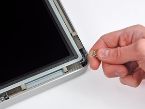

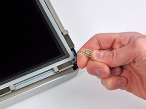

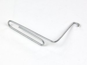

Image 1/3: Due to tight tolerances, you will have to use a thin hooked tool to lift the display out of the outer case. As seen in the third picture, we made one out of a bent paperclip. Image 2/3: Use a thin hooked tool to lift one side of the top edge of the display by its steel outer frame. Image 3/3: After lifting the top edge of the display on one side, hold it out of the outer case while you use a hooked tool to lift the other side.
  • Carefully lay the iMac stand-side down on a flat surface.
  • Due to tight tolerances, you will have to use a thin hooked tool to lift the display out of the outer case. As seen in the third picture, we made one out of a bent paperclip.
  • Use a thin hooked tool to lift one side of the top edge of the display by its steel outer frame.
  • After lifting the top edge of the display on one side, hold it out of the outer case while you use a hooked tool to lift the other side.
  • Do not lift the top edge of the display out of the outer case too far, as several short ribbon cables still connect the two components.
Be careful with any tool while lifting the edge of the display. Under the top left edge of the display sits the bluetooth-antenna-connector. I pulled it out while lifting. It was not such a great problem, cause i could just plug it in again. But maybe you could cut the small cable depending on the tool you use to lift.

The display is quite heavy, an is fitted with a tight tolerance. I found it very difficult and dangerous, lifting it with any tool in one corner while the iMac was lying down. Instead, after removing the T10 screws, it was quite easy pulling the display out of the iMac with my fingers on both sides, while the iMac was in the upright position. By doing that, you can easily hold the display with one hand and reach for the connecting cables with the other
Georg P - Reply
I broke the short ribbon cable that attaches to the inner top of the display but all the pics show the display completely removed after all cables are disconnected without the short ribbon cable intact. Does this short ribbon cable have a purpose and does it need to be reconnected? If so, how? Or is it just some worthless control put in by Apple to show its been messed with when brought back for repair? Thanks

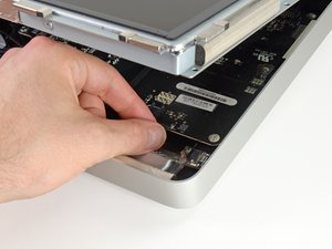

Image 1/2: Be sure to pull the connector parallel to the LED driver board, straight out of its socket. Image 2/2: Be sure to pull the connector parallel to the LED driver board, straight out of its socket.
  • Using your fingers, carefully pull the vertical sync cable out of its socket on the LED driver board near the top left corner of your iMac.
    • Be sure to pull the connector parallel to the LED driver board, straight out of its socket.
This cable is very small and fiddley to remove if you don't have much in the way of finger nails. The cables are very thin and fragile.
James York - Reply
It took me a bit of work to remove this cable, it was a hassle actually. What worked for me, without any tools, was to use your index and middle fingers' nails and pull it. That worked better than the index and thumb. Took me like 15 minutes, more than what it should take.
thefinalzeta - Reply
Yes, me too! It stuck terribly hard and I spent most of the time for the repair for this s**** little connector. I thought all the time, I'm gonna break it or tear off these tiny cables... All the other cables were *rather* easy-going. In the end I finally got a new SanDisk Ultra II 480 GB SSD working.

When the cable comes out, make note of which side has the gold contacts visible. On my cable, you could only see them from the "top" side (aka, as you look down on it). From the "bottom" or back side of the cable, you could NOT see any gold contacts. This will help to orient the cable when reconnecting it.
markcerv - Reply
In my case, all the cable connectors were oriented having the golden contacts, as seen from the wide side of the connectors, oriented facing away from the board

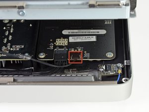

Image 1/1: If your fan is spinning full speed after completion, check this connection or the hard drive's thermal sensor cable.
  • Lift the display for enough clearance to disconnect the LCD thermal sensor cable connector from its socket on the logic board.
  • If your fan is spinning full speed after completion, check this connection or the hard drive's thermal sensor cable.
Before you take/remove the LCD thermal sensor cable connector from its socket, make a note of which color cable is on the left, and which is on the right. When I removed the cable, the black cable was leftmost, and the grey cable was rightmost.
markcerv - Reply
I replaced hard drive and added a second SSD on a 2010 27" iMac. Everything seemed fine for about a year, and now the fans run continuously. I think it's this cable in Step 8; I'll get around to opening it up to check.

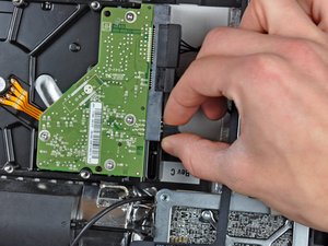

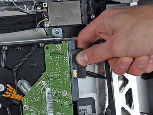

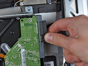

Image 1/3: Disconnect the thermal sensor, SATA power, and SATA data cables by pulling their connectors away from the sockets on the hard drive. Image 2/3: Disconnect the thermal sensor, SATA power, and SATA data cables by pulling their connectors away from the sockets on the hard drive. Image 3/3: Disconnect the thermal sensor, SATA power, and SATA data cables by pulling their connectors away from the sockets on the hard drive.
  • Before disconnecting the thermal sensor cable, take note of its orientation. It is extremely important to reinstall the connector in the current orientation so the fans will not run at full speed. If you have multiple pins on your replacement hard drive, put the connector closest to the SATA connections and closest to the PCB board.
  • Disconnect the thermal sensor, SATA power, and SATA data cables by pulling their connectors away from the sockets on the hard drive.
I just put a 2 TB WD (WD2001FASS) Black in a 27″ iMac. I had issues with the hard drive fan staying on and the system showing the thermal sensor wasn't working. I tried the pin a number of ways but I finally figured out I had to have the connector closest to the SATA connection and the black wire had to be on the board side (toward the LCD).
philomathius - Reply
Thanks so much for this comment! I was going nuts trying to figure out why the fan was going crazy despite my using the same brand drive. I flipped the connector over and plugged it back into the drive with the black cable nearest the display. Problem solved.
Howie Isaacks -
Thank you very much for sharing this information.
I can confirm the same for the WD 1TB (WD1003FZEX). I too had to turn the sensor cable 180° and insert it into the socket with the black cable facing up (i.e. towards where the LCD would be) in order to solve the fan speed issue.

Note that the thermal sensor cable is no longer present on the mid-2011 iMac.

This step is somewhat important if you want to use the thermal sensory with a multiple pin style drive. My comment is to just read the instructions a few times before and make sure you use the two pins that are in the top row on the side of the SATA cable.

The best solution for the Thermal Sensor issue is to use a 2N3904 transistor as explained here: replace the hard drive, how do I connect Hard Drive thermal sensor?
I used that exact solution yesterday and it's working like a charm: replace the hard drive, how do I connect Hard Drive thermal sensor?

For solve reving HDD fan issues with SSD install, I removed the fan and a plastic barrier...

I just turned the connector of the fan control 180 degrees, because over 30$ for HDDFan Control is very expensive and I liked to have heat adjust. It was a WD500 Caviar with 6 pins. Now it works.

When you jump the two pins that the thermal sensor cables are connect to in the HDD's *JUMPER BLOCK*, the HDD limits it’s transfer rate to 1.5 Gbits/sek.. -This is a kind of safe mode, reducing heat generated from the HDD when your iMac is running hot. -And in the same breath, the reason your fans are running haywire if the terminals aren’t connected to the right pins..
All you need to do is:
1# Read the datasheet on your “to be installed” HDD.
2# Connect the thermal sensor wires, to the pins that limits your new HDD’s transfer rate.
(One way to do it if the connectors don’t match, is by separating the terminals from the connector and heat shrinking some heatshink around the individual terminals before connecting them to the pins.. -It’s a fiddly task but not impossible. Just use a needle to pry up the little hooks that holds the terminals in place in the connector)..
That’s all folks, best of luck to you all..

  • Remove the two T10 Torx screws securing the upper hard drive bracket to the outer case.
Image 1/2: Lift the hard drive off its two lower positioning pins and remove it from the outer case. Image 2/2: Lift the hard drive off its two lower positioning pins and remove it from the outer case.
  • Slightly rotate the hard drive away from the outer case.
  • Lift the hard drive off its two lower positioning pins and remove it from the outer case.
Image 1/1: Remove the upper bracket from the hard drive.
  • Remove the two T8 Torx screws securing the upper bracket to the hard drive.
  • Remove the upper bracket from the hard drive.
