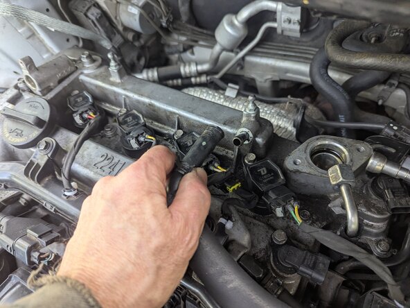

  10. Hyundai Accent Valve Cover Gasket Replacement, Disconnect the fuel pressure regulator electrical connector: step 10, image 1 of 3 Hyundai Accent Valve Cover Gasket Replacement, Disconnect the fuel pressure regulator electrical connector: step 10, image 2 of 3 Hyundai Accent Valve Cover Gasket Replacement, Disconnect the fuel pressure regulator electrical connector: step 10, image 3 of 3
    • Press the locking tab on the fuel pressure regulator's electrical connector and unplug it.

  11. Hyundai Accent Valve Cover Gasket Replacement, Remove the fuel feed tube quick connector: step 11, image 1 of 3 Hyundai Accent Valve Cover Gasket Replacement, Remove the fuel feed tube quick connector: step 11, image 2 of 3 Hyundai Accent Valve Cover Gasket Replacement, Remove the fuel feed tube quick connector: step 11, image 3 of 3
    • There will almost certainly be a small amount of residual pressure in the line, so spread a shop rag under the intake and high pressure lines.
    • Disconnect the quick connect fitting.
    • In this particular car the plastic release had deteriorated and basically disintegrated when it was attempted to be used. A fitting tool was used instead to accomplish the same goal.
    • Disconnect the line.
    • On reassembly, be sure to check the low pressure fuel hose quick-connector is completely connected to the high pressure fuel pump until a confirmation 'click' sound is heard.
    • Be sure to re-check the low pressure fuel hose is completely connected to the high pressure fuel pump by pulling it after connecting.

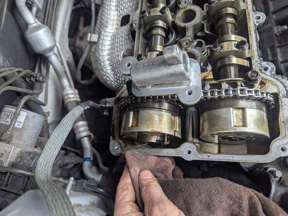

  45. Hyundai Accent Valve Cover Gasket Replacement, Clean the cylinder head surfaces: step 45, image 1 of 2 Hyundai Accent Valve Cover Gasket Replacement, Clean the cylinder head surfaces: step 45, image 2 of 2
    • Wipe down the oil control valve housing to ensure the gasket mounting surface is clean.
    • If you need to scrape it, do not use metal instruments; a plastic scraper will ensure you don't damage the surface.
    • If you need to use solvent, use something like brake cleaner that won't leave a residue.

  46. Hyundai Accent Valve Cover Gasket Replacement: step 46, image 1 of 2 Hyundai Accent Valve Cover Gasket Replacement: step 46, image 2 of 2
    • Here we're wiping down the timing cover surfaces.

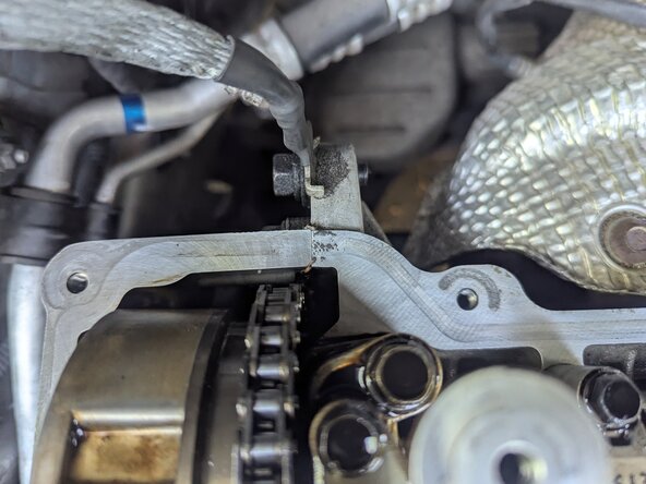

  47. Hyundai Accent Valve Cover Gasket Replacement: step 47, image 1 of 3 Hyundai Accent Valve Cover Gasket Replacement: step 47, image 2 of 3 Hyundai Accent Valve Cover Gasket Replacement: step 47, image 3 of 3
    • Now we want to wipe down the cylinder head surfaces.
    • The outside edges are clean now.
    • And the spark plug tubes are also prepared.

  53. Hyundai Accent Valve Cover Gasket Replacement, Add sealant: step 53, image 1 of 3 Hyundai Accent Valve Cover Gasket Replacement, Add sealant: step 53, image 2 of 3 Hyundai Accent Valve Cover Gasket Replacement, Add sealant: step 53, image 3 of 3
    • Add a small amount of gasket sealant to the joint between the cylinder head and the timing cover on each side.
