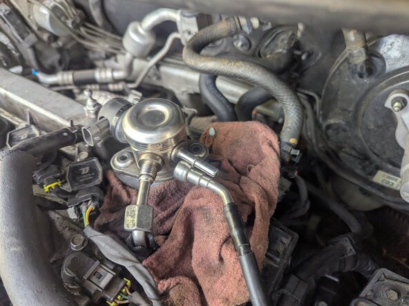

  10. Hyundai Accent High Pressure Fuel Pump Replacement, Disconnect the fuel pressure regulator electrical connector: step 10, image 1 of 3 Hyundai Accent High Pressure Fuel Pump Replacement, Disconnect the fuel pressure regulator electrical connector: step 10, image 2 of 3 Hyundai Accent High Pressure Fuel Pump Replacement, Disconnect the fuel pressure regulator electrical connector: step 10, image 3 of 3
    • Press the locking tab on the fuel pressure regulator's electrical connector and unplug it.
    Ask FixBot
  11. Hyundai Accent High Pressure Fuel Pump Replacement, Remove the fuel feed tube quick connector: step 11, image 1 of 3 Hyundai Accent High Pressure Fuel Pump Replacement, Remove the fuel feed tube quick connector: step 11, image 2 of 3 Hyundai Accent High Pressure Fuel Pump Replacement, Remove the fuel feed tube quick connector: step 11, image 3 of 3
    • There will almost certainly be a small amount of residual pressure in the line, so spread a shop rag under the intake and high pressure lines.
    • Disconnect the quick connect fitting.
    • In this particular car the plastic release had deteriorated and basically disintegrated when it was attempted to be used. A fitting tool was used instead to accomplish the same goal.
    • Disconnect the line.
    • On reassembly, be sure to check the low pressure fuel hose quick-connector is completely connected to the high pressure fuel pump until a confirmation 'click' sound is heard.
    • Be sure to re-check the low pressure fuel hose is completely connected to the high pressure fuel pump by pulling it after connecting.
    Ask FixBot
  12. Hyundai Accent High Pressure Fuel Pump Replacement, Disconnect the high pressure fuel line: step 12, image 1 of 2 Hyundai Accent High Pressure Fuel Pump Replacement, Disconnect the high pressure fuel line: step 12, image 2 of 2
    • Using a 19 mm open end or tubing wrench, unscrew the high pressure fuel line from the high pressure fuel pump.
    • On reassembly, be sure to install the high pressure fuel pipe with the specified torque (19.5 ~ 23.9 lb-ft).
    Ask FixBot
  13. Hyundai Accent High Pressure Fuel Pump Replacement, Remove the mounting bolts: step 13, image 1 of 2 Hyundai Accent High Pressure Fuel Pump Replacement, Remove the mounting bolts: step 13, image 2 of 2
    • The high pressure fuel pump is under significant spring pressure, so the two bolts securing it must be loosened evenly to prevent damage to the housing surface.
    • Use a 10 mm socket with a short extension to remove the bolts according to the instructions on the following pages.

  16. Hyundai Accent High Pressure Fuel Pump Replacement: step 16, image 1 of 1
    • Repeat the previous two steps until the tension on the bolts has been relieved. At that point you can remove them both.
    • When tightening the installation bolts of the high pressure fuel pump, tighten the bolts alternately in small steps (1/2 turn) after first hand tightening them.
    • Final torque on the bolts is 9.4 ~ 10.9 lb-ft. Most non-professional torque wrenches aren't very accurate below 15 ft/lbs, so if possible use a wrench calibrated in in/lbs, 113 ~ 131 lb-in.

  17. Hyundai Accent High Pressure Fuel Pump Replacement, Remove the high pressure fuel pump: step 17, image 1 of 3 Hyundai Accent High Pressure Fuel Pump Replacement, Remove the high pressure fuel pump: step 17, image 2 of 3 Hyundai Accent High Pressure Fuel Pump Replacement, Remove the high pressure fuel pump: step 17, image 3 of 3
    • The high pressure fuel pump can now be lifted off the valve cover.
    Ask FixBot
  18. Hyundai Accent High Pressure Fuel Pump Replacement, Remove the roller tappet: step 18, image 1 of 3 Hyundai Accent High Pressure Fuel Pump Replacement, Remove the roller tappet: step 18, image 2 of 3 Hyundai Accent High Pressure Fuel Pump Replacement, Remove the roller tappet: step 18, image 3 of 3
    • This is easiest done with a magnetic pickup tool, but it can be removed using your finger inserted into the roller tappet and pull up on it.
    • Before installing the high pressure fuel pump, position the roller tappet in the lowest position by rotating the crankshaft. Otherwise the installation bolts may be broken because of tension of the pump spring.
    Ask FixBot
During reinstallation, apply engine oil to the O-ring of the high pressure fuel pump, the roller tappet, and the protrusion. Also apply engine oil to the groove on the location where the protrusion is installed.
