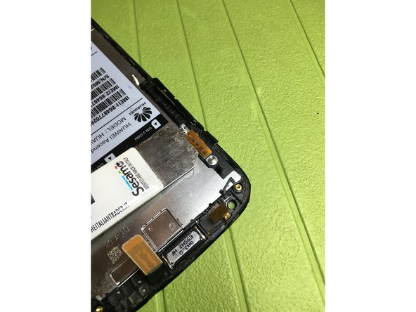

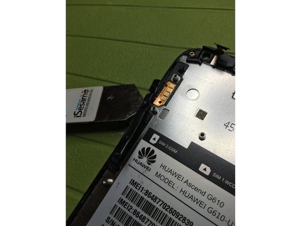

  11. Huawei Ascend G610 volume and power buttons replacement ignition: step 11, image 1 of 3 Huawei Ascend G610 volume and power buttons replacement ignition: step 11, image 2 of 3 Huawei Ascend G610 volume and power buttons replacement ignition: step 11, image 3 of 3
    • With the help of a heat source, remove the audio and power button ribbon cable
  12. Huawei Ascend G610 volume and power buttons replacement ignition: step 12, image 1 of 1
    • Replace with the new component
