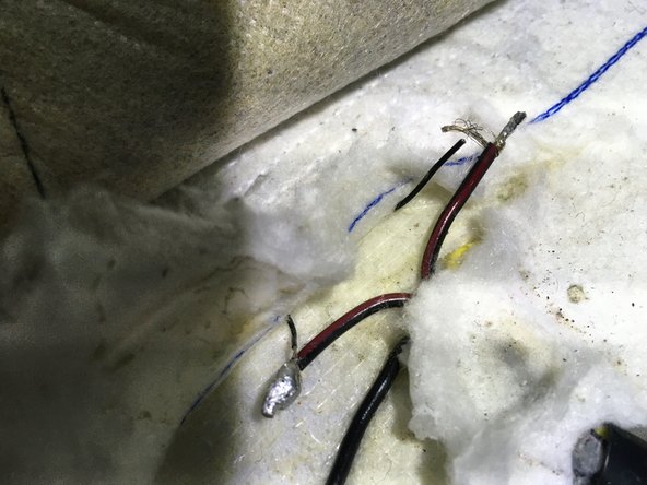

    • Now that you have access to the white cotton heating pad, you will need to carefully cut into it to expose the poor connection. Don’t bother removing the tape from the sides, I’m not sure why it’s there.
    • The bad connections will be near where the wires go in. The thicker wire runs in from the connector site and one black wire goes left and one black wire goes right.
  5. How to fix the seat heater in a 2008-Present Dodge Caravan: step 5, image 1 of 2 How to fix the seat heater in a 2008-Present Dodge Caravan: step 5, image 2 of 2
    • I ended up soldering both sides. I tried the outboard side, the side closest to me, and then reconnected all of the plugs but that didn’t fix it. Then I went to the other side and did it too. I ended up stripping back some of the insulation, as you can see the wire is extremely tiny, like 28 gauge.
    • As I mentioned, you can test it without putting everything all back together. Definitely do that. Reassembly is opposite of disassembly. Remember to disconnect the two plugs that go to the seat bottom so you can fish them back through the loop of fabric and pull the fabric down back over the phone like it was a fitted sheet on a mattress.
