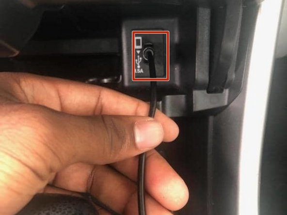

  1. How to fix 2016 Honda Accord Apple Carplay Connection, How to fix 2016 Honda Accord Apple Carplay Connection: step 1, image 1 of 1
    • Disconnect your phone's USB cable from the USB port and the Apple Car Play system.
