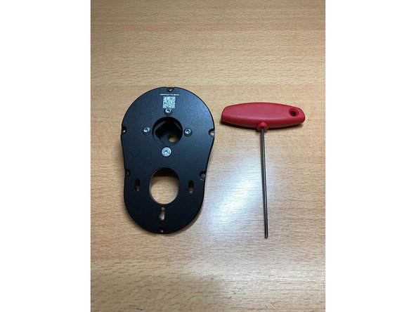

  2. How to assembly FatBoy Mini Urethane Gear Drive, Attach hanger hub to the baseplate: step 2, image 1 of 2 How to assembly FatBoy Mini Urethane Gear Drive, Attach hanger hub to the baseplate: step 2, image 2 of 2
    • Install 4 x M2.5 bolts through the baseplate to hanger hub.
    • Don't forget to use Loctite on threads

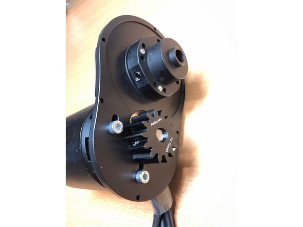

  5. How to assembly FatBoy Mini Urethane Gear Drive, Attach motor to baseplate: step 5, image 1 of 1
    • Use 3xM3 bolts to attach motor to the baseplate
  6. How to assembly FatBoy Mini Urethane Gear Drive, Attach motor gear to motor axle: step 6, image 1 of 2 How to assembly FatBoy Mini Urethane Gear Drive, Attach motor gear to motor axle: step 6, image 2 of 2
    • Tighten M2 grub screws on motor gear to secure motor gear on axle.
    • Don't forget to use Loctite on grub screw thread
