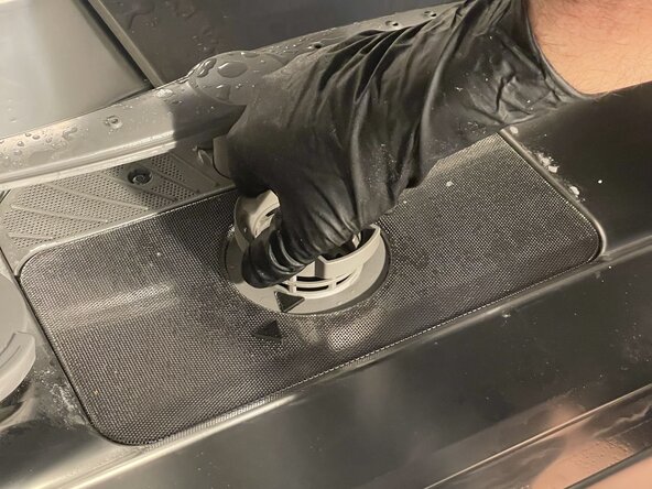

  2. How to Unclog a Bosch SHEM78WH5N/52 Dishwasher Drain Filter: step 2, image 1 of 3 How to Unclog a Bosch SHEM78WH5N/52 Dishwasher Drain Filter: step 2, image 2 of 3 How to Unclog a Bosch SHEM78WH5N/52 Dishwasher Drain Filter: step 2, image 3 of 3
    • Twist the cap of the filter basket until you feel it loosen.
    • Remember the phrase: “Righty tighty, lefty loosey”—turn right (clockwise) to tighten, and left (counterclockwise) to loosen.
    • Lift the drain screen and filter basket up to remove it and put it in a nearby sink.

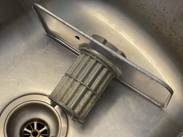

  3. How to Unclog a Bosch SHEM78WH5N/52 Dishwasher Drain Filter: step 3, image 1 of 2 How to Unclog a Bosch SHEM78WH5N/52 Dishwasher Drain Filter: step 3, image 2 of 2
    • Put the drain screen and filter basket under running water.
    • Use a washcloth or scrub brush to remove any food particles on the outside and inside the filter basket.

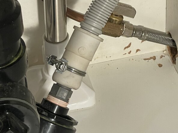

  5. How to Unclog a Bosch SHEM78WH5N/52 Dishwasher Drain Filter: step 5, image 1 of 3 How to Unclog a Bosch SHEM78WH5N/52 Dishwasher Drain Filter: step 5, image 2 of 3 How to Unclog a Bosch SHEM78WH5N/52 Dishwasher Drain Filter: step 5, image 3 of 3
    • Under the sink next to the dishwasher should be the water outlet hose that connects the dishwasher to the kitchen sink drain pipe.
    • Remove all the content in front of the outlet hose in order to have proper access to the outlet hose.
    • There should be a clamp on the outlet hose to keep it attached to the drain pipe.
    • Place a towel under the outlet hose in case any water spills or leaks out.
    • Use a 2.5 mm flathead or standard screwdriver to loosen the clamp screw.
  6. How to Unclog a Bosch SHEM78WH5N/52 Dishwasher Drain Filter: step 6, image 1 of 2 How to Unclog a Bosch SHEM78WH5N/52 Dishwasher Drain Filter: step 6, image 2 of 2
    • Pull the outlet hose off of the drain pipe.

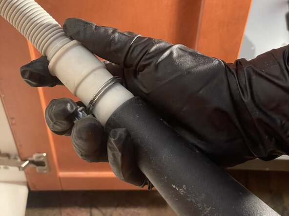

  8. How to Unclog a Bosch SHEM78WH5N/52 Dishwasher Drain Filter: step 8, image 1 of 3 How to Unclog a Bosch SHEM78WH5N/52 Dishwasher Drain Filter: step 8, image 2 of 3 How to Unclog a Bosch SHEM78WH5N/52 Dishwasher Drain Filter: step 8, image 3 of 3
    • Use the wet vacuum with the attachment that fits in the outlet hose.
    • Turn on the wet vacuum to suck out any food particles or debris that may be located deeper within the outlet hose.
    • If the water in the dishwasher begins to drain when using the wet vacuum that indicates the blockage has been removed.
