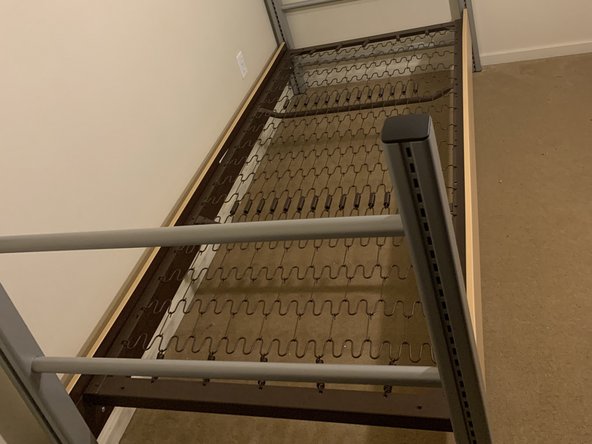

    • Ensure that there is nothing on top or around the bed.
    • Move the bed away from any walls to allow room for your entire body to be behind it.

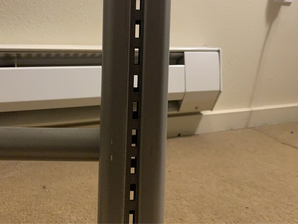

    • Align the headboard with the bed frame.
    • Use the prongs and the holes in the frame to find a height that you would like your bed to be at.

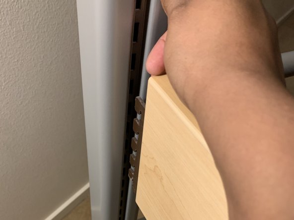

    • Gently align the hooks with the holes in the headboard and let the bed frame drop into the holes.
    • Once both sides of the headboard are placed at the same height, use one leg to push down on the bed frame and one hand to pull up on the headboard.
    • When you hear a click your bed frame is locked into the headboard.
    • Perform these steps for each side of the footboard at the same height as the headboard.

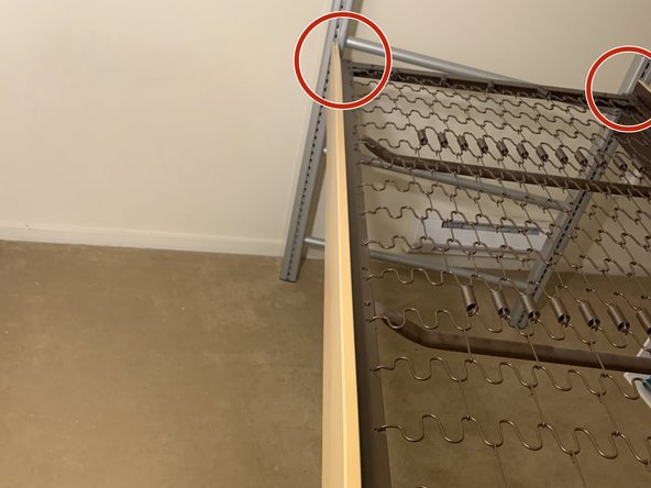

    • Ensure that all sides on the headboard and footboard are the same. Image 1 shows how they are uneven with the red circles.

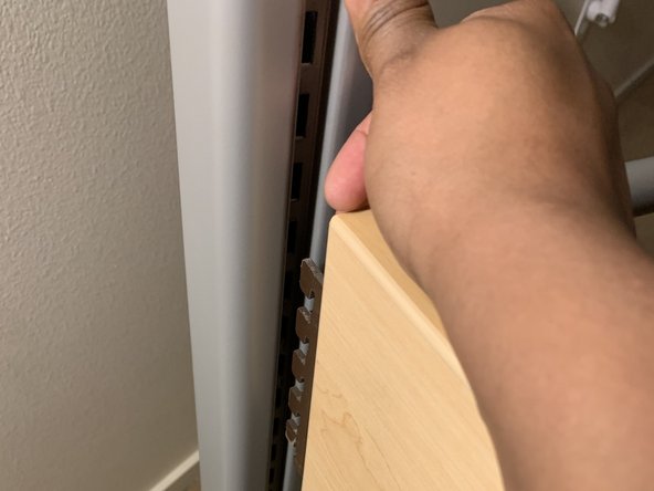

    • Once all sides are even and at the height that you would like, place your mattress back on and make your bed as you please!
To ensure that the bed is placed securely, pull up on bed frame. If it comes out it isn’t secure, if it stays in place you are good to go!
