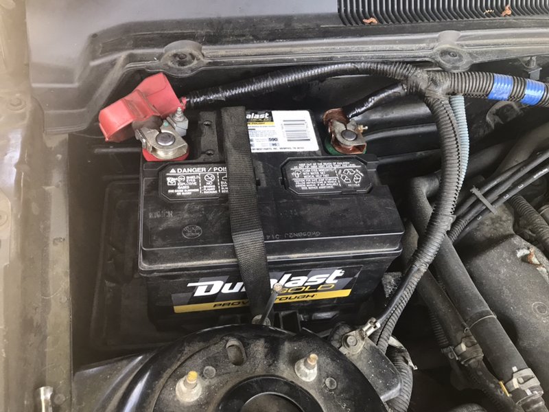

      • Open the hood and prop it open using the hood prop.
      • Locate the battery.
      • Battery acid can cause skin corrosion. Wear protective face coverings, eyewear and gloves to prevent skin contact.
