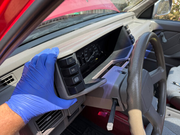

  4. How To Disable the Oxygen Sensor (O2) Dash Light in a 1989–1994 Isuzu Amigo or Pickup, Detach the cluster surround: step 4, image 1 of 2 How To Disable the Oxygen Sensor (O2) Dash Light in a 1989–1994 Isuzu Amigo or Pickup, Detach the cluster surround: step 4, image 2 of 2
    • Adjust the steering wheel tilt to the lowest setting.
    • Pivot the bottom edge of the cluster surround out towards the steering wheel.
    • A row of clips holds the cluster surround in place along the top edge.
    • Pull the surround straight out. Keep in mind that it's still connected with cables on either side.
