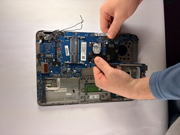

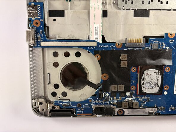

  12. HP EliteBook 725 G3 Motherboard Replacement, Motherboard: step 12, image 1 of 3 HP EliteBook 725 G3 Motherboard Replacement, Motherboard: step 12, image 2 of 3 HP EliteBook 725 G3 Motherboard Replacement, Motherboard: step 12, image 3 of 3
    • Remove the ten 2.5 mm-long Phillips #00 screws securing the motherboard.
  13. HP EliteBook 725 G3 Motherboard Replacement: step 13, image 1 of 2 HP EliteBook 725 G3 Motherboard Replacement: step 13, image 2 of 2
    • Flip up the black locking flap securing the ribbon cable and disconnect the cable.

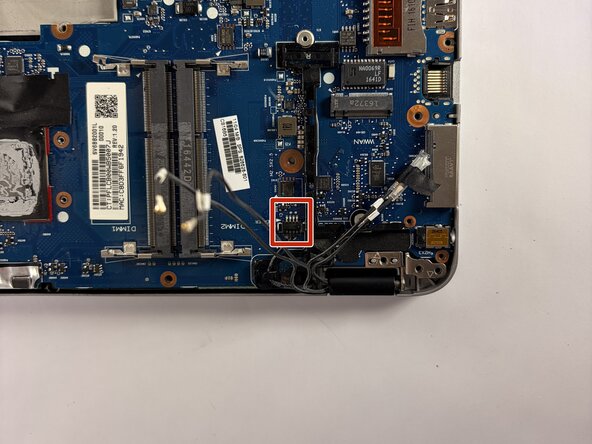

  14. HP EliteBook 725 G3 Motherboard Replacement: step 14, image 1 of 3 HP EliteBook 725 G3 Motherboard Replacement: step 14, image 2 of 3 HP EliteBook 725 G3 Motherboard Replacement: step 14, image 3 of 3
    • Disconnect the small group of wires near the hinge of the laptop by gently squeezing the sides and pulling it out
  15. HP EliteBook 725 G3 Motherboard Replacement: step 15, image 1 of 2 HP EliteBook 725 G3 Motherboard Replacement: step 15, image 2 of 2
    • Gently grab the motherboard and slowly maneuver it out.
