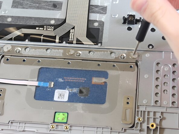

  5. HP Chromebook 14a-ne0013dx Touchpad Replacement: step 5, image 1 of 3 HP Chromebook 14a-ne0013dx Touchpad Replacement: step 5, image 2 of 3 HP Chromebook 14a-ne0013dx Touchpad Replacement: step 5, image 3 of 3
    • Locate the back of the touchpad (it will have a small ribbon cable attached).
    • Remove the four 2 mm screws from the touchpad using a Phillips #00 screwdriver.
    • Lift the metal bar and put it off to the side.

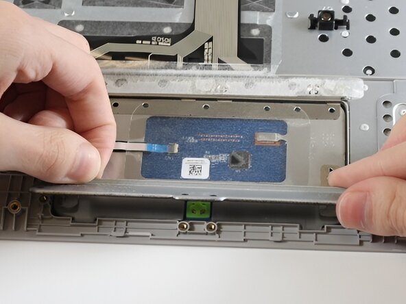

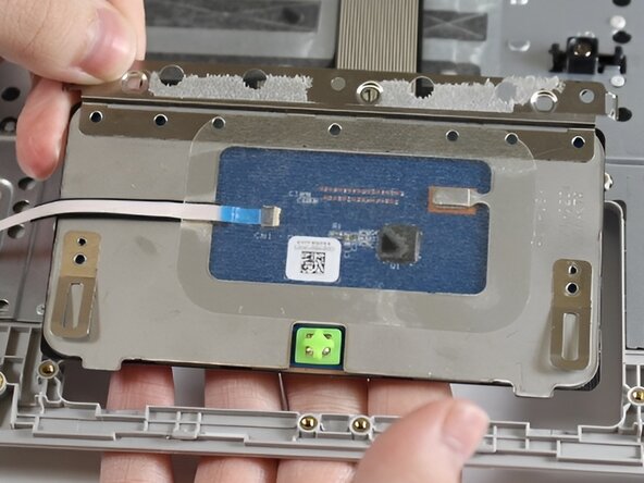

  6. HP Chromebook 14a-ne0013dx Touchpad Replacement: step 6, image 1 of 3 HP Chromebook 14a-ne0013dx Touchpad Replacement: step 6, image 2 of 3 HP Chromebook 14a-ne0013dx Touchpad Replacement: step 6, image 3 of 3
    • Peel back the layer of tape that is covering the top screws.
    • Remove the three 2 mm screws from the top of the touchpad using a Phillips #00 screwdriver.
    • Lift the touchpad to remove it from the rest of the keyboard.
