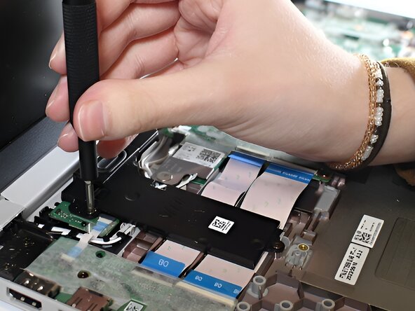

    • Remove the four 3 mm screws from the battery casing using a Phillips #0 screwdriver.
    • Gently peel the tape pieces connecting the battery to cables on the bottom panel.
    • Lift the top panel off, then lift the battery out of the casing.

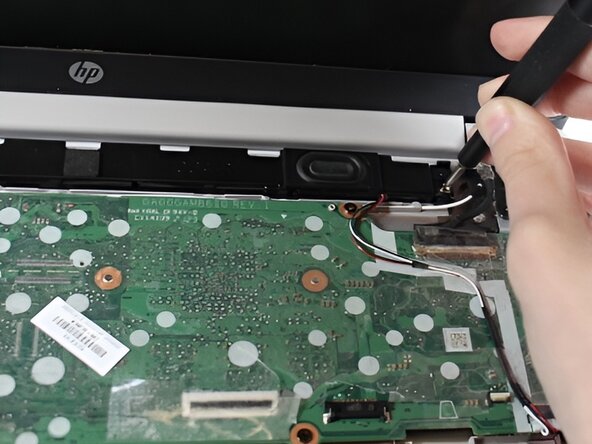

  6. HP Chromebook 14a-ne0013dx Speakers Replacement, Speakers: step 6, image 1 of 3 HP Chromebook 14a-ne0013dx Speakers Replacement, Speakers: step 6, image 2 of 3 HP Chromebook 14a-ne0013dx Speakers Replacement, Speakers: step 6, image 3 of 3
    • Remove the three 3 mm screws with a Phillips #0 screwdriver.
  7. HP Chromebook 14a-ne0013dx Speakers Replacement: step 7, image 1 of 1
    • Locate the wire connecting the speaker to the motherboard. Lift up the tape that is blocking the wire from the motherboard.
    • Gently grab and pull the wires out of the connecting socket to detach the speaker bar fully.
  8. HP Chromebook 14a-ne0013dx Speakers Replacement: step 8, image 1 of 1
    • Lift the speaker bar out of the device.
