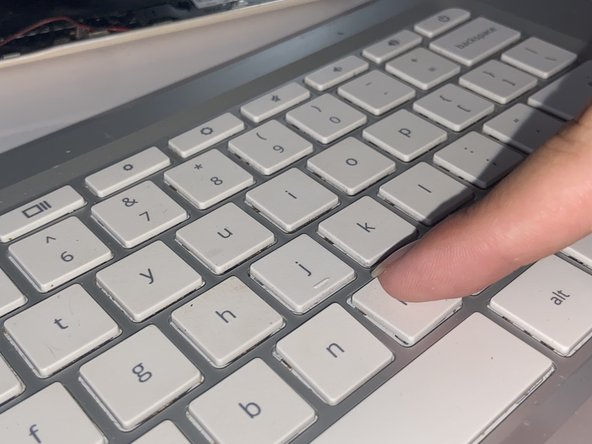

    • Press on a key above the key you want to replace.
    • Place a flat object, like an iFixit opening tool in this case, under the broken key and lift upwards to remove it.
