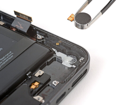

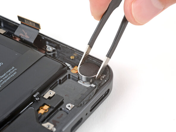

Use the flat end of a spudger to pry up the vibration motor by its right edge.
Remove the vibration motor.
Use the flat end of a spudger and tweezers to scrape up and remove the old vibration motor adhesive from the frame.

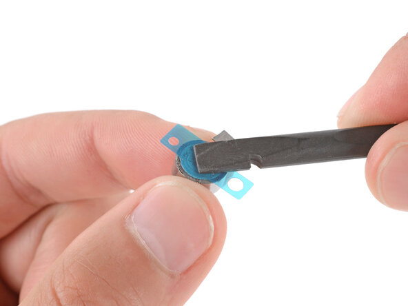

Remove the larger, clear liner from the vibration motor adhesive.
Align the adhesive on the bottom of the vibration motor and use the flat end of a spudger to firmly press it into place.
Remove the remaining liner to expose the adhesive.

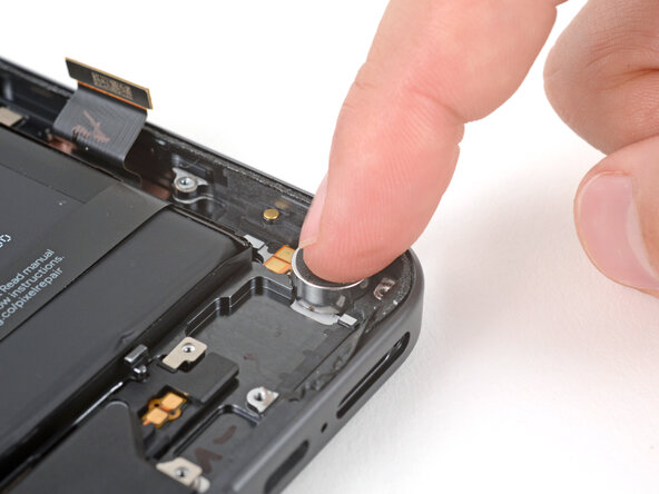

Place the vibration motor into its recess so the contact pads are facing the top of your phone.
Press down firmly on the vibration motor to secure it with the adhesive.
