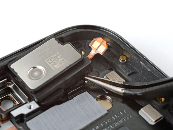

  22. Google Pixel 10a Earpiece Speaker Replacement, Remove the earpiece speaker: step 22, image 1 of 2 Google Pixel 10a Earpiece Speaker Replacement, Remove the earpiece speaker: step 22, image 2 of 2
    • Slide one arm of a pair of angled tweezers under the earpiece speaker cable and lift to peel it off of the frame.
    Ask FixBot
  23. Google Pixel 10a Earpiece Speaker Replacement: step 23, image 1 of 3 Google Pixel 10a Earpiece Speaker Replacement: step 23, image 2 of 3 Google Pixel 10a Earpiece Speaker Replacement: step 23, image 3 of 3
    • Slide the tips of your angled tweezers under the bottom-right corner of the earpiece speaker and pry up to remove it.
    Ask FixBot

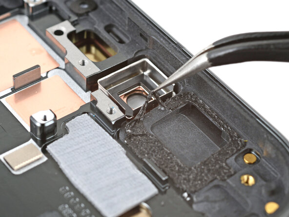

  25. Google Pixel 10a Earpiece Speaker Replacement, Remove the adhesive residue: step 25, image 1 of 1
    • Use tweezers to remove any earpiece speaker adhesive from the frame.
    • Use a lint-free cloth to wipe away any adhesive residue from the frame.
    Ask FixBot
