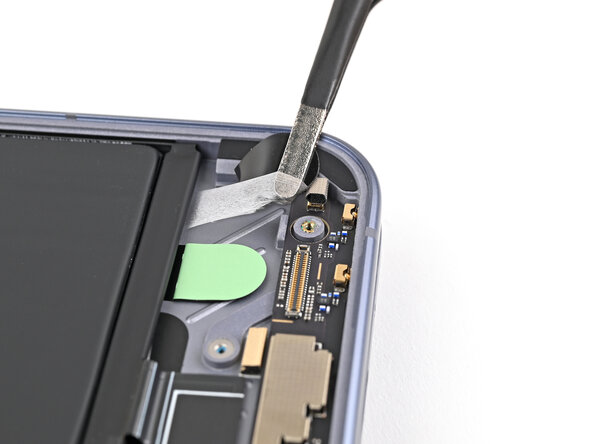

  16. Google Pixel 10 Pro Fold Flip and Base Battery Replacement, Peel up the pull tab: step 16, image 1 of 3 Google Pixel 10 Pro Fold Flip and Base Battery Replacement, Peel up the pull tab: step 16, image 2 of 3 Google Pixel 10 Pro Fold Flip and Base Battery Replacement, Peel up the pull tab: step 16, image 3 of 3
    • Use an opening pick to peel up the two green ends of the pull tab on the base battery.

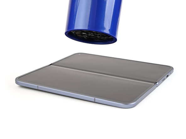

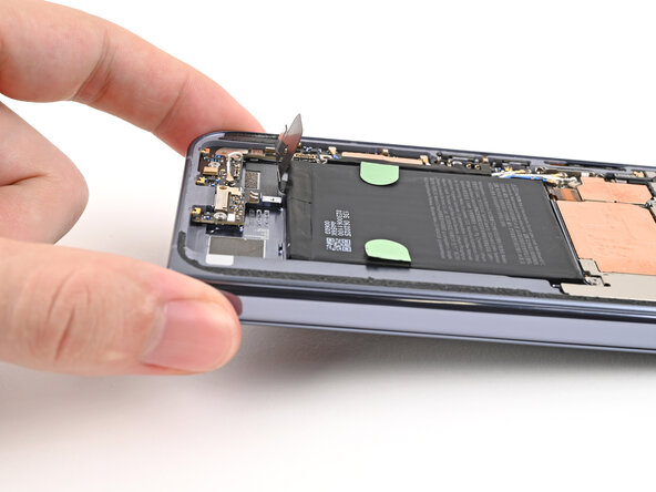

  17. Google Pixel 10 Pro Fold Flip and Base Battery Replacement, Soften the base battery adhesive: step 17, image 1 of 1
    • Unfold your phone and flip it so the inner screen is facing upward.
    • Use a hair dryer to heat the section of inner screen behind the base battery until it's barely too hot to touch.
    • Don't heat the screen longer than 30 seconds, as it's susceptible to heat damage.
  18. Google Pixel 10 Pro Fold Flip and Base Battery Replacement, Remove the base battery: step 18, image 1 of 3 Google Pixel 10 Pro Fold Flip and Base Battery Replacement, Remove the base battery: step 18, image 2 of 3 Google Pixel 10 Pro Fold Flip and Base Battery Replacement, Remove the base battery: step 18, image 3 of 3
    • If you're having trouble gripping the pull tabs, use finger stalls to get a better grip.
    • Fold your phone and turn it so the base battery is facing up.
    • Slide the pull tab back and forth toward the bottom edge of the battery to separate the bottom section of adhesive.

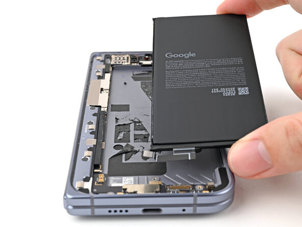

  19. Google Pixel 10 Pro Fold Flip and Base Battery Replacement: step 19, image 1 of 3 Google Pixel 10 Pro Fold Flip and Base Battery Replacement: step 19, image 2 of 3 Google Pixel 10 Pro Fold Flip and Base Battery Replacement: step 19, image 3 of 3
    • The battery adhesive is strong. Be careful when pulling on the battery and reapply heat if necessary to avoid bending it.
    • Pull straight up with constant, steady force to separate the adhesive under the battery. Work slowly and let time do the work for you until the adhesive separates.
    • Remove the base battery.
    • If you're having trouble separating the adhesive, apply more heat and try again.

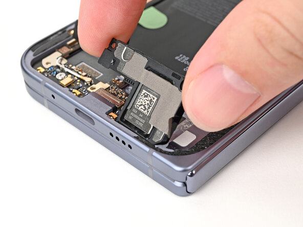

  21. Google Pixel 10 Pro Fold Flip and Base Battery Replacement, Remove the loudspeaker screw: step 21, image 1 of 2 Google Pixel 10 Pro Fold Flip and Base Battery Replacement, Remove the loudspeaker screw: step 21, image 2 of 2
    • Use a Torx Plus 3IP driver to remove the 2.4 mm‑long screw securing the loudspeaker.

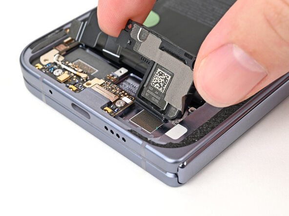

  22. Google Pixel 10 Pro Fold Flip and Base Battery Replacement, Remove the loudspeaker: step 22, image 1 of 2 Google Pixel 10 Pro Fold Flip and Base Battery Replacement, Remove the loudspeaker: step 22, image 2 of 2
    • Use the point of a spudger to pry up the left edge of the loudspeaker to separate the adhesive securing it to the frame.
  23. Google Pixel 10 Pro Fold Flip and Base Battery Replacement: step 23, image 1 of 2 Google Pixel 10 Pro Fold Flip and Base Battery Replacement: step 23, image 2 of 2
    • Use your fingers to lift the top edge of the loudspeaker and pull it out of its recess in the frame.
    • Remove the loudspeaker.

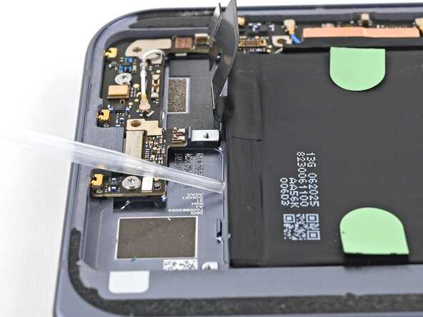

  24. Google Pixel 10 Pro Fold Flip and Base Battery Replacement, Apply isopropyl alcohol: step 24, image 1 of 2 Google Pixel 10 Pro Fold Flip and Base Battery Replacement, Apply isopropyl alcohol: step 24, image 2 of 2
    • Apply a few drops of high concentration (>90%) isopropyl alcohol under the bottom edge of the base battery.
  25. Google Pixel 10 Pro Fold Flip and Base Battery Replacement: step 25, image 1 of 2 Google Pixel 10 Pro Fold Flip and Base Battery Replacement: step 25, image 2 of 2
    • Lift the bottom edge of the phone to let the isopropyl alcohol flow under the battery.
    • Wait one minute for the alcohol to soften the adhesive.

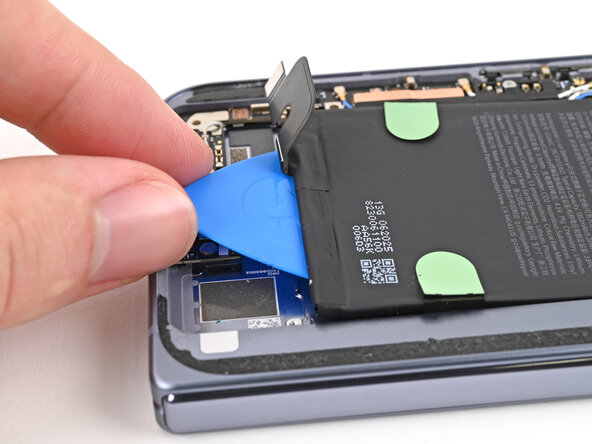

  26. Google Pixel 10 Pro Fold Flip and Base Battery Replacement, Separate the adhesive: step 26, image 1 of 2 Google Pixel 10 Pro Fold Flip and Base Battery Replacement, Separate the adhesive: step 26, image 2 of 2
    • Slide an opening pick—long edge first—under the bottom edge of the battery to separate the bottom section of adhesive.

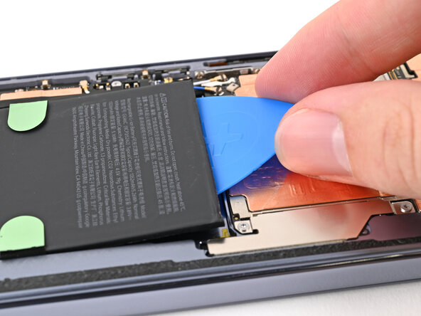

  27. Google Pixel 10 Pro Fold Flip and Base Battery Replacement: step 27, image 1 of 3 Google Pixel 10 Pro Fold Flip and Base Battery Replacement: step 27, image 2 of 3 Google Pixel 10 Pro Fold Flip and Base Battery Replacement: step 27, image 3 of 3
    • Insert an opening pick—long edge first—between the top edge of the battery and the logic board.
    • Rotate the pick so it lies flat under the battery and slide it downward to separate the top portion of adhesive.

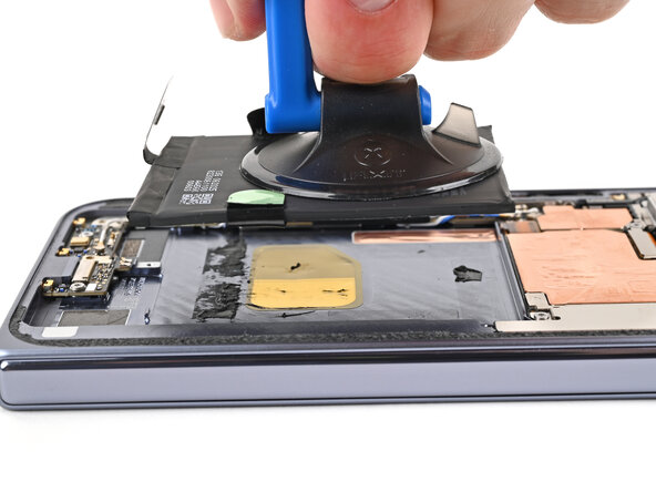

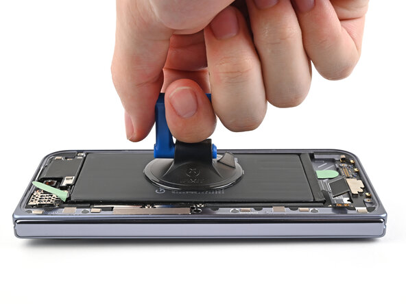

  28. Google Pixel 10 Pro Fold Flip and Base Battery Replacement, Remove the base battery: step 28, image 1 of 2 Google Pixel 10 Pro Fold Flip and Base Battery Replacement, Remove the base battery: step 28, image 2 of 2
    • Apply a suction cup to the center of the base battery.

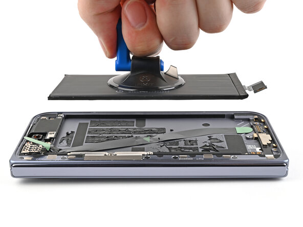

    • While securing the phone with one hand, pull up on the suction cup with strong, steady force to separate the base battery from the frame.

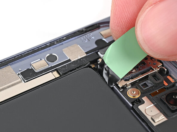

  40. Google Pixel 10 Pro Fold Flip and Base Battery Replacement, Remove the stretch release adhesive: step 40, image 1 of 2 Google Pixel 10 Pro Fold Flip and Base Battery Replacement, Remove the stretch release adhesive: step 40, image 2 of 2
    • Use tweezers to grip the black pull tab on the stretch release adhesive and wrap it around the ends of your tweezers.
  41. Google Pixel 10 Pro Fold Flip and Base Battery Replacement: step 41, image 1 of 3 Google Pixel 10 Pro Fold Flip and Base Battery Replacement: step 41, image 2 of 3 Google Pixel 10 Pro Fold Flip and Base Battery Replacement: step 41, image 3 of 3
    • Hold the phone steady using the edges of the frame—don't press down on the battery.
    • Pull the strip slowly, evenly, and at a low angle without dragging on other components. Give it plenty of time to stretch and un-stick from under the battery.

  42. Google Pixel 10 Pro Fold Flip and Base Battery Replacement, Soften the flip battery adhesive: step 42, image 1 of 1
    • Use a hair dryer to heat the section of inner screen behind the flip battery (the side with the SIM card cutout) until it's barely too hot to touch.
  43. Google Pixel 10 Pro Fold Flip and Base Battery Replacement, Separate the flip battery adhesive: step 43, image 1 of 2 Google Pixel 10 Pro Fold Flip and Base Battery Replacement, Separate the flip battery adhesive: step 43, image 2 of 2
    • Fold your phone and turn it so the flip battery is facing up.
    • Grip the green pull tab at the top left corner of the flip battery and rotate it around the battery so it rests along the left edge.
  44. Google Pixel 10 Pro Fold Flip and Base Battery Replacement: step 44, image 1 of 3 Google Pixel 10 Pro Fold Flip and Base Battery Replacement: step 44, image 2 of 3 Google Pixel 10 Pro Fold Flip and Base Battery Replacement: step 44, image 3 of 3
    • While holding the bottom right pull tab in place, slide the other tab down the left edge of the battery and separate its adhesive.
  45. Google Pixel 10 Pro Fold Flip and Base Battery Replacement: step 45, image 1 of 2 Google Pixel 10 Pro Fold Flip and Base Battery Replacement: step 45, image 2 of 2
    • Grip the pull tab section at the bottom right corner of the flip battery and rotate it around the battery so it rests along the right edge.
  46. Google Pixel 10 Pro Fold Flip and Base Battery Replacement: step 46, image 1 of 2 Google Pixel 10 Pro Fold Flip and Base Battery Replacement: step 46, image 2 of 2
    • Reposition the jacket so it sits evenly under the bottom edge of the battery.
  47. Google Pixel 10 Pro Fold Flip and Base Battery Replacement, Remove the flip battery: step 47, image 1 of 3 Google Pixel 10 Pro Fold Flip and Base Battery Replacement, Remove the flip battery: step 47, image 2 of 3 Google Pixel 10 Pro Fold Flip and Base Battery Replacement, Remove the flip battery: step 47, image 3 of 3
    • Slide the jacket towards the top edge of the battery to separate the remaining adhesive.
    • Remove the flip battery.
    • If you're having a lot of trouble separating the adhesive, or if you feel like you might damage the battery, follow the next five steps for an alternate method. Otherwise, skip here.
  48. Google Pixel 10 Pro Fold Flip and Base Battery Replacement, Apply isopropyl alcohol: step 48, image 1 of 2 Google Pixel 10 Pro Fold Flip and Base Battery Replacement, Apply isopropyl alcohol: step 48, image 2 of 2
    • Apply a few drops of isopropyl alcohol (>90%) under the bottom edge of the flip battery.
  49. Google Pixel 10 Pro Fold Flip and Base Battery Replacement: step 49, image 1 of 2 Google Pixel 10 Pro Fold Flip and Base Battery Replacement: step 49, image 2 of 2
  50. Google Pixel 10 Pro Fold Flip and Base Battery Replacement, Separate the adhesive: step 50, image 1 of 2 Google Pixel 10 Pro Fold Flip and Base Battery Replacement, Separate the adhesive: step 50, image 2 of 2
  51. Google Pixel 10 Pro Fold Flip and Base Battery Replacement: step 51, image 1 of 2 Google Pixel 10 Pro Fold Flip and Base Battery Replacement: step 51, image 2 of 2
    • Insert an opening pick—long edge first—between the top edge of the battery and the upper board.
  52. Google Pixel 10 Pro Fold Flip and Base Battery Replacement, Remove the flip battery: step 52, image 1 of 2 Google Pixel 10 Pro Fold Flip and Base Battery Replacement, Remove the flip battery: step 52, image 2 of 2
    • Apply a suction cup to the center of the flip battery.
    • While securing the phone with one hand, pull up on the suction cup with strong, steady force to separate the flip battery from the frame.

  90. Google Pixel 10 Pro Fold Flip and Base Battery Replacement, Place the vibrator: step 90, image 1 of 3 Google Pixel 10 Pro Fold Flip and Base Battery Replacement, Place the vibrator: step 90, image 2 of 3 Google Pixel 10 Pro Fold Flip and Base Battery Replacement, Place the vibrator: step 90, image 3 of 3
    • Use tweezers to slide the left edge of the vibrator into its clip and rest it in its cutout in the frame.
  91. Google Pixel 10 Pro Fold Flip and Base Battery Replacement, Install the vibrator screws: step 91, image 1 of 2 Google Pixel 10 Pro Fold Flip and Base Battery Replacement, Install the vibrator screws: step 91, image 2 of 2
    • Use a Torx Plus 3IP driver to install the three 3.2 mm‑long screw securing the vibrator.

    • Separate one of the secondary liner's pull tabs at the top right corner.
  105. Google Pixel 10 Pro Fold Flip and Base Battery Replacement: step 105, image 1 of 2 Google Pixel 10 Pro Fold Flip and Base Battery Replacement: step 105, image 2 of 2
    • Peel the liner from the right and bottom edge of the frame.
  106. Google Pixel 10 Pro Fold Flip and Base Battery Replacement: step 106, image 1 of 3 Google Pixel 10 Pro Fold Flip and Base Battery Replacement: step 106, image 2 of 3 Google Pixel 10 Pro Fold Flip and Base Battery Replacement: step 106, image 3 of 3
    • While holding the back cover over the frame, peel the liner from the left and top edge of the frame and expose the adhesive.

    • Optionally, you can use a hair dryer or heat gun to lightly heat the edges of the back cover and create a stronger bond.
