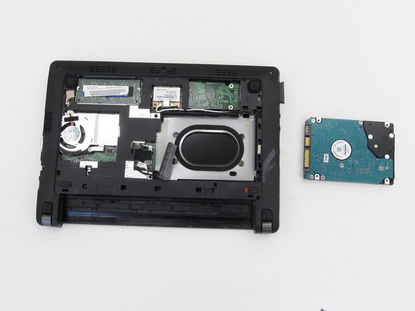

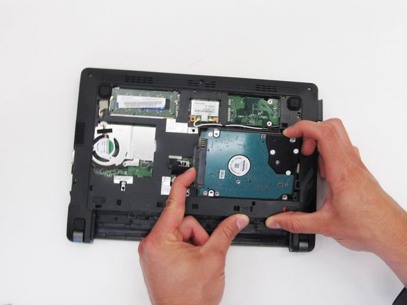

  10. Gateway Lt4004u Hard Drive Replacement, Hard Drive: step 10, image 1 of 3 Gateway Lt4004u Hard Drive Replacement, Hard Drive: step 10, image 2 of 3 Gateway Lt4004u Hard Drive Replacement, Hard Drive: step 10, image 3 of 3
    • Locate the hard drive in the top left hand corner of the device. It is a teal blue-green color with the top right corner covered by a black piece of plastic.
    • Gently insert your fingernail or a spudger into the crevice on the right side of the hard drive in order to pry the hard drive from the bottom of the laptop.
    • Note that the laptop has been rotated 180 degrees from the first picture of this step to the second picture. The hard drive is shown in the top left corner in the first picture, but in the bottom right corner in the second.
  11. Gateway Lt4004u Hard Drive Replacement: step 11, image 1 of 2 Gateway Lt4004u Hard Drive Replacement: step 11, image 2 of 2
    • Use your fingers to unplug the black plastic connection from the left side of the hard drive.
    • Remove the hard drive from the rest of the laptop.
