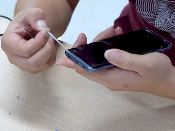

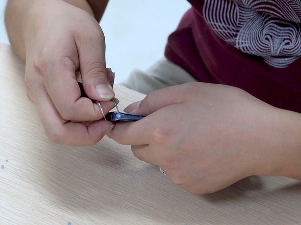

    • The following part is using 17 inches of Frozen Machine to disassemble the mid-frame from the OLED. Firstly, we would place the whole screen into the working area of the frozen machine for freezing. Here it needs to take 5 minutes to freeze the screen.
    • Then we can use a poker card to separate the mid-frame under the low temperature after the freezing time is up.
    • Warm tips: Pleaser wear the gloves to protect your hands from lower temperature when you are operating. Besides, you can add some glue cleanser to separate the mid-frame during the process.
    • Once separated the mid-frame, we have to use Test Boarder to test the display and the touch are on work or not.

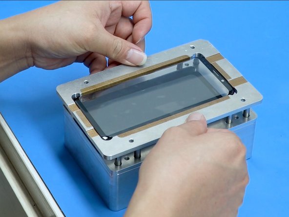

  3. Five Steps To Replace Samsung S9 Broken Screen, New OCA Laminating: step 3, image 1 of 3 Five Steps To Replace Samsung S9 Broken Screen, New OCA Laminating: step 3, image 2 of 3 Five Steps To Replace Samsung S9 Broken Screen, New OCA Laminating: step 3, image 3 of 3
    • Then we would laminate a new piece of OCA to the new glass of Samsung S9 once we confirmed the test result is no problem.

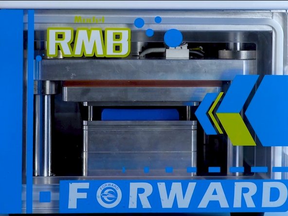

    • In the OCA lamination part, the tools we would use are the whole set high precision positioning edge mold of model S9 and RMB-2 OCA Lamination Machine. It would take 90s in this process.
    • Here we can see there’s no any bubble and folds on the new glass after the lamination through the third picture.

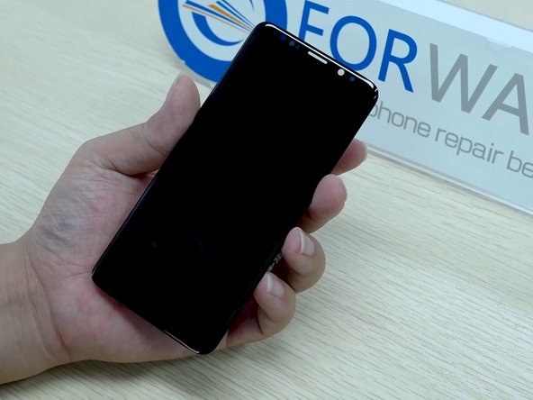

    • The last step is putting the screen into bubble remover to remove bubbles. It should take 5 mins to remove bubbles so that we can get a perfect effect.
    • We can see the final screen lamination and bubble removing effects are extremely good.
That’s all steps for Samsung S9’s broken screen replacement. Reviewing the whole process, I think that mid-frame cold separating is a key point for the entire replace process. But I think you can do it well.
