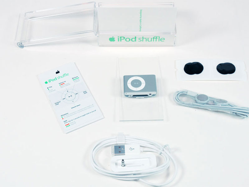

  1. Packaging is virtually identical to the iPod Nano G2 packaging.
    • Packaging is virtually identical to the iPod Nano G2 packaging.
    • Included: Shuffle, color manual, USB 2 dock, and earbuds (plus spare earbud covers).
    • There are LEDs on top and bottom of the shuffle. You can't see both at once and they both flash the same messages.

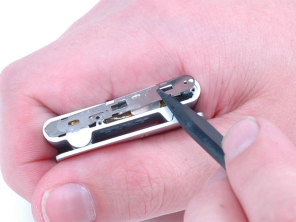

  6. Use a spudger to lift out the metal retaining brackets on either side of the Shuffle. The hinge side contains a tiny extension that supports the casing, so start from the other side (as shown).
    • Use a spudger to lift out the metal retaining brackets on either side of the Shuffle. The hinge side contains a tiny extension that supports the casing, so start from the other side (as shown).
    • Apple includes a 'flash guide' with ten different codes. The LEDs flash green, amber, and red.

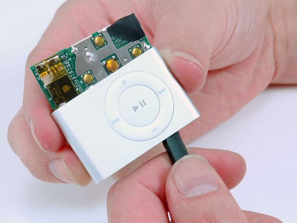

  7. Use a spudger to push the logic board through the case and out of the Shuffle.
    • Use a spudger to push the logic board through the case and out of the Shuffle.

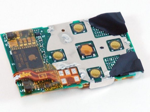

  8. The top of the logic board.
    • The top of the logic board.
    • You can see the five button sensors, Apple logo ARM chip, and data ribbon cable (this leads to the headphone / dock jack on the other side)
    • The ARM chip has the numbers: 337S3300 844A N05WDK01 0642 ARM.
    • There's a smaller chip to the left of the Apple logo chip that simply says 'AAC.'

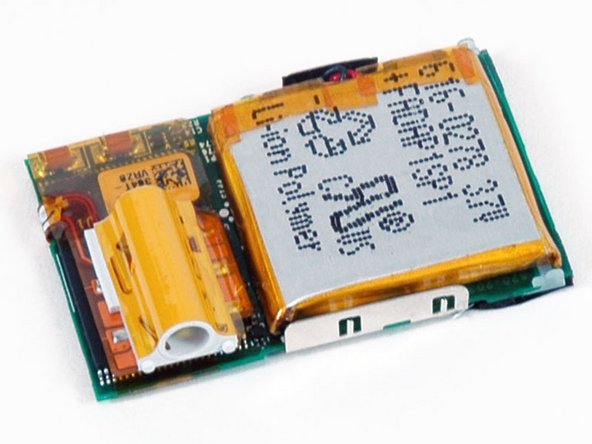

  10. Battery flipped out
    • Battery flipped out
    • Notable features: Li-ion polymer battery (this is soldered onto the logic board), headphone / dock / power jack, and memory chip (hidden beneath the headphone jack.
