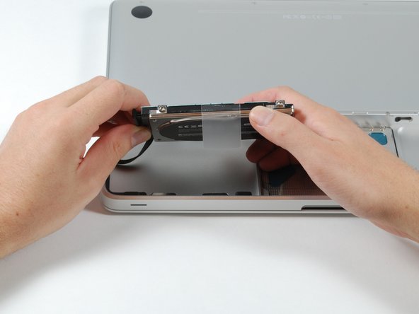

  9. MacBook Unibody Model A1278 Teardown: step 9, image 1 of 1
    • Disconnecting the hard drive.
    • To replace the hard drive, you'll need a T6 Torx screwdriver to transfer the hard drive mounting screws to the new drive.

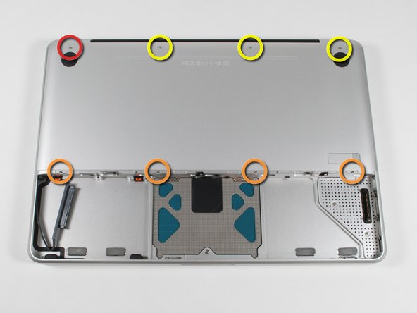

    • The bottom panel is attached by 8 screws:
    • One 3 mm Phillips in the top left corner.
    • Four 3.5 mm Phillips along the bottom.
    • Three 13.8 mm Phillips along the top.

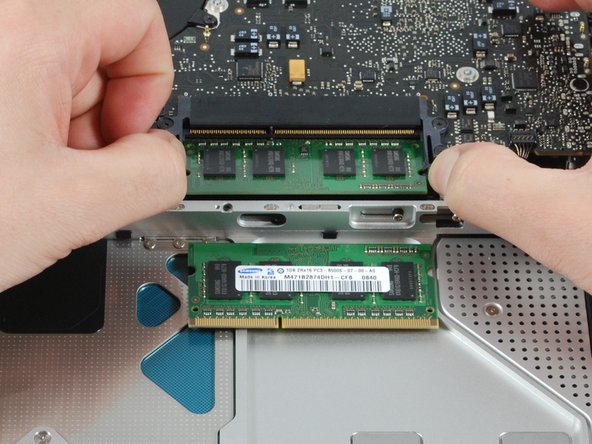

    • Removing the RAM
    • 2GB (two 1GB SO-DIMMs) of 1066MHz DDR3 SDRAM are included. Apple will upgrade the RAM to 4GB for an extra $150.
    • Apple claims this machine maxes out at 4GB RAM, but the Montevina chipset appears to support up to 8GB.
    • Shameless plug: You can upgrade your existing MacBook or MacBook Pro to 4 GB. We'll also be offering the RAM for the new Unibody machines in the near future.

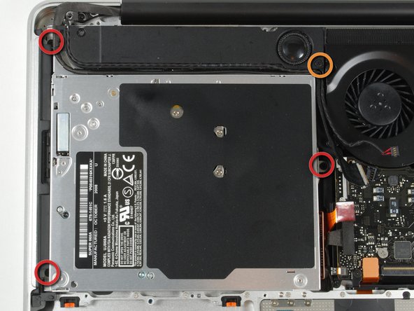

  14. MacBook Unibody Model A1278 Teardown: step 14, image 1 of 1
    • The optical drive is held in by the following 4 screws:
    • Three 2.5 mm Phillips.
    • One 3.7 mm Phillips.
    • Apple gives the following specification: 8x SuperDrive (DVD±R DL/DVD±RW/CD-RW).

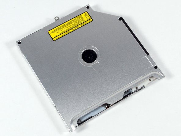

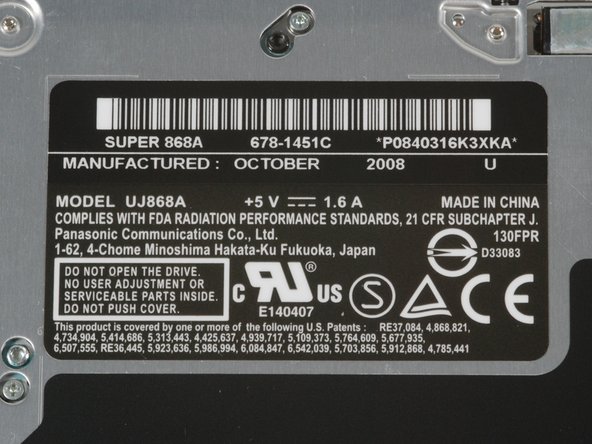

  15. MacBook Unibody Model A1278 Teardown: step 15, image 1 of 2 MacBook Unibody Model A1278 Teardown: step 15, image 2 of 2
    • The optical drive, now SATA.
    • The optical drive shows a manufacture date of October 2008. That drive sure got from the factory to us fast!

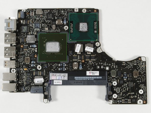

    • Removing the logic board.
    • This may be the most beautiful laptop we've disassembled. Apple has a right to be proud of their engineers and manufacturing team.

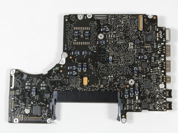

  17. MacBook Unibody Model A1278 Teardown: step 17, image 1 of 3 MacBook Unibody Model A1278 Teardown: step 17, image 2 of 3 MacBook Unibody Model A1278 Teardown: step 17, image 3 of 3

    • The bottom of the logic board.
    • Part numbers found thus far:
    • Cypress PSoC Mixed-Signal Array CY8C24794-24L FXI 0831 A 04 KOR CYP 637569
    • Realtek HD Audio Codec ALC885 87J24A1 G83283
    • TDK 6T213HF 0838 d
    • ISL95O4 BHRZ H0832BB49
    • APP001 928 3T 0829A
    • SN 802043 TI 87K JR7C G4

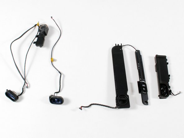

  19. MacBook Unibody Model A1278 Teardown: step 19, image 1 of 2 MacBook Unibody Model A1278 Teardown: step 19, image 2 of 2
    • Removing the right speaker and subwoofer.
    • The new MacBook received a welcome speaker upgrade. In the second image, the old plastic MacBook's speakers are on the left, and the new MacBook's speakers are on the right.

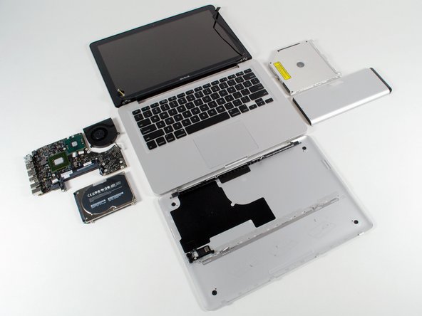

    • All major components - only 4.5 pounds, not bad for a full-featured, metal laptop.
    • Looking for more pictures? We've also disassembled the new MacBook Pro.
