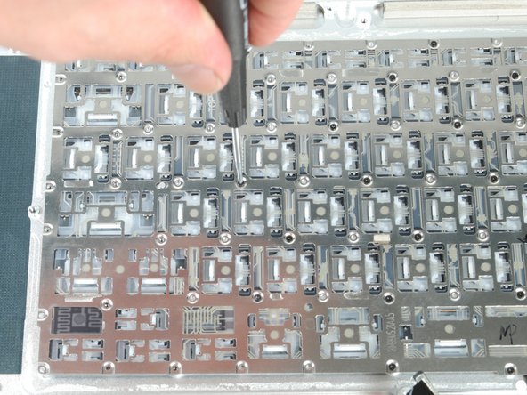

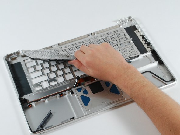

Image 1/1: The keyboard is now more similar to the old MacBook than the previous MacBook Pro. While the unibody case is very cool, this is going to make keyboard repair difficult.
  • Old on the left, new on the right.
  • The keyboard is now more similar to the old MacBook than the previous MacBook Pro. While the unibody case is very cool, this is going to make keyboard repair difficult.

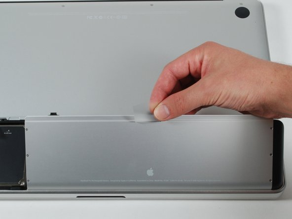

  • Removing the battery cover.
  • Aww, look at the cute little Apple logo.

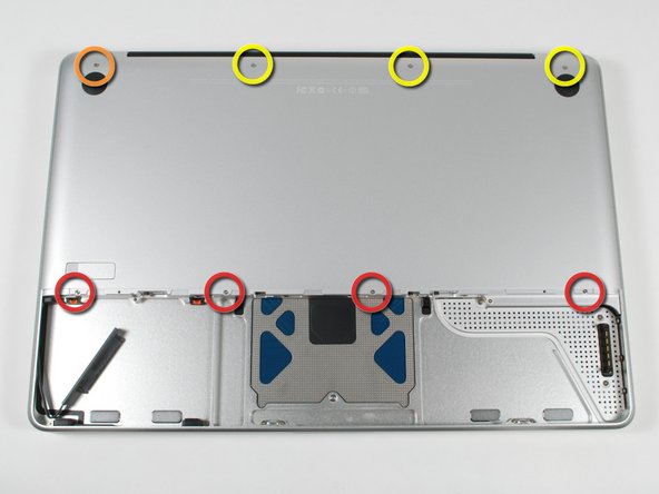

Image 1/1: Remove the following 8 screws:
  • The first step to opening this machine is removing the bottom plate.
  • Remove the following 8 screws:
  • Let's see what's creating all that torsional rigidity that Jony Ive keeps talking about.
I'm upgrading RAM and have removed all 8 screws but not touched the HD.
The bottom casing refuses to move and feels like there's something else
connected. No info in manual, any ideas?
thedarklord - Reply

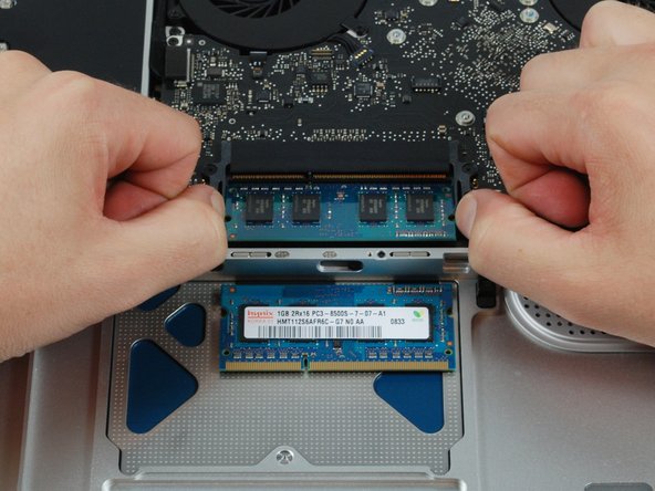

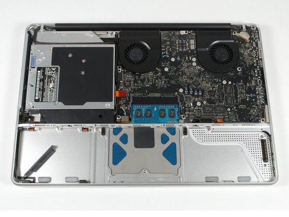

Image 1/1: Apple claims this machine maxes out at 4GB RAM, but the Montevina chipset appears to support up to 8GB.
  • Removing the two 1 GB DIMMs. These chips are a new RAM type for Apple, 1066 MHz DDR3 SDRAM.
  • Apple claims this machine maxes out at 4GB RAM, but the Montevina chipset appears to support up to 8GB.
  • Shameless plug: You can upgrade your existing MacBook or MacBook Pro to 4 GB. We'll also be offering the RAM for the new Unibody machines in the near future.
Here's the complete spec on the memory module
http://www.hynix.com/products/computing/...
cosomojon - Reply
Hi,
somebody already tried 8GB? I saw that the new 17" Unibody has an option for 8GB so I am wondering if it is also possible in the 15" Unibody Pro.
What are the exact specs of the memory module? Is it 1066 6-6-6 or 1066 7-7-7 or the slowest one 1066 8-8-8?
Thanks for the info.
xanthalas - Reply
Quote from xanthalas:
Hi,
The original 15" Unibody does not support 8 GB, but later 15" Unibodies do.
Miroslav Djuric - Reply
Quote from miro:
Hi miro.
Thanks for your info. How comes? What changed in the models? Starting with which Model of the 15" MacBook Pro 8GB is supported? The one without ExpressCard Slot but with Cardreader or also older models of the 15" MacBook Pro. How can I identifiy if 8GB are supported or not?
looking forward hearing your answer soon.
xanthalas - Reply
Hi miro.
Nobody knows?
The timing of the memory would also be interesting (CL).
Thanks
xanthalas - Reply
I tried in my unibody (late2008) and works perfect - the system reconigze all the 2x 4GB memory.
fernando - Reply

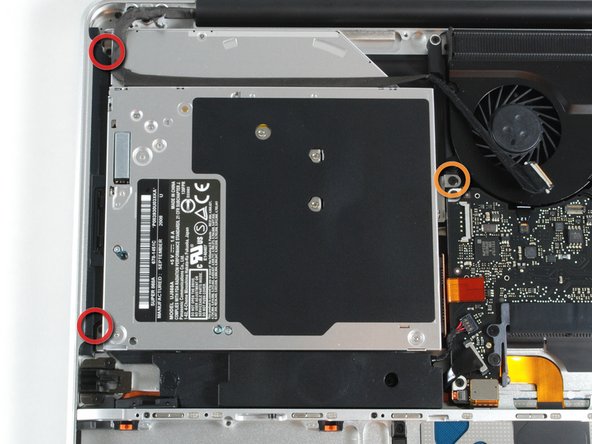

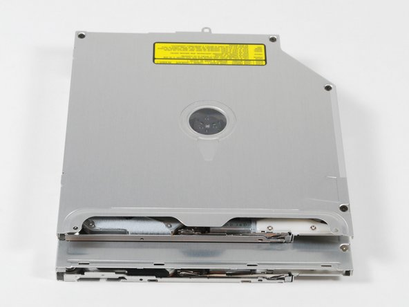

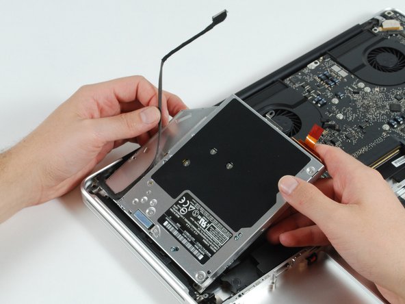

  • To free the Superdrive, remove the following 3 screws
Image 1/1:
  • Liberating the optical drive from the confines of this beautiful machine.

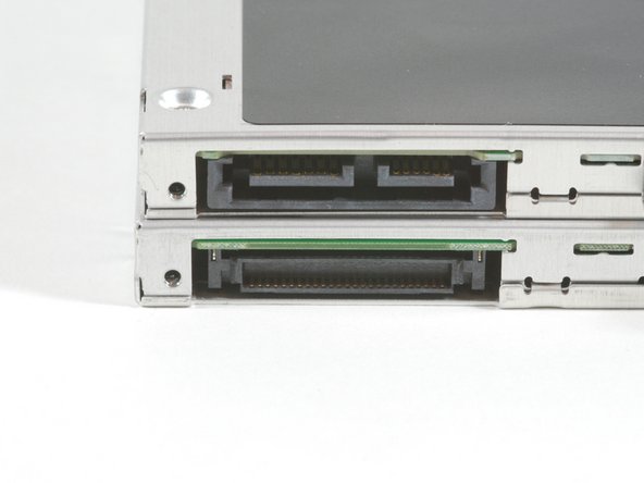

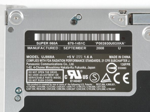

Image 1/3: The superdrive in the last model was ATA, model #UJ857. Image 2/3: You can see the different connectors in the middle picture. The new, SATA connector is on top. Image 3/3: The rightmost photo is a shot of the new drive label.
  • The optical drive is SATA for the first time. Panasonic model #UJ878A.
  • The superdrive in the last model was ATA, model #UJ857.
  • You can see the different connectors in the middle picture. The new, SATA connector is on top.
  • The rightmost photo is a shot of the new drive label.
Can you please note if this optical drive is 9mm or 11mm high? Wondering if it is possible to replace with a slot-loading Panasonic Blu-Ray drive...
mooner - Reply
Quote from mooner:
It's a Panasonic Super Slim which means it's 9.5mm
Therefore the Blu-ray drive doesn't fit.
ranron - Reply

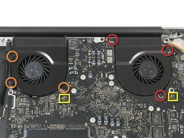

Image 1/1: Remove the following 6 screws:
  • Pry the two fan connectors up off their sockets on the logic board.
  • Remove the following 6 screws:
    • Three 3.1 mm Philips screws.
    • Three 3.7 mm Philips screws.
How do you disconect the connector ?
Pull up, or sideways (towards the fan) ?
Ty :)
elmancho - Reply
Quote from elmancho:
Ty :)
I went ahead and edited the step to make it more clear. Thanks for pointing it out!
Andrew Bookholt - Reply
Can you install a second SSD drive for raid 0 in place of the superdrive.
Not a Mac person yet.
Looking for a fast portable Photoshop processor. One draw back I see to the Macbook is only 256 in the video board. Photoshop wants at least 512 to activate OpenGL and the shader.
sjprg - Reply

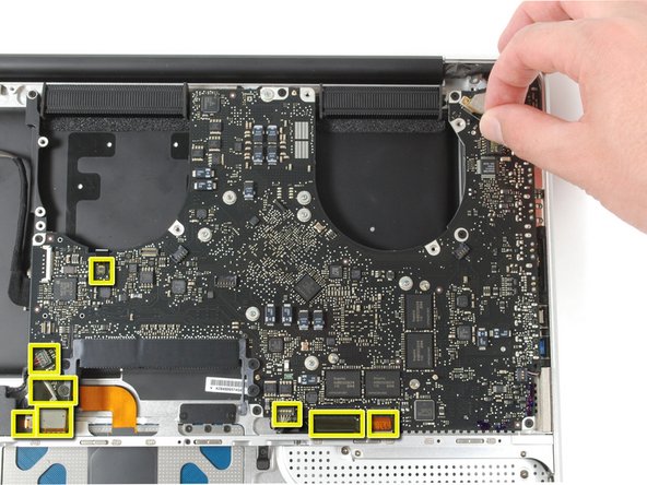

  • There are a number of ribbon cables to disconnect from the logic board.
Can you label the connectors as to what they go to? Where I work we have to disable the iSight and in some cases the wireless interfaces.
notu - Reply

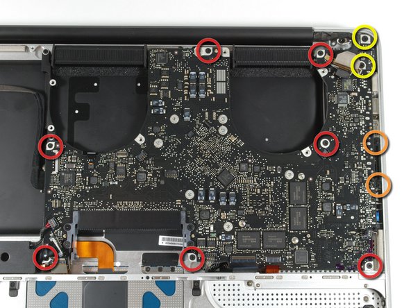

Image 1/1: While our circles make it look like there are a lot of screws, this machine appears to have fewer screws than the previous MacBook Pro. These screws all attach directly to the solid-piece upper case, which should simplify maintenance a bit.
  • Remove the following 11 screws:
  • While our circles make it look like there are a lot of screws, this machine appears to have fewer screws than the previous MacBook Pro. These screws all attach directly to the solid-piece upper case, which should simplify maintenance a bit.

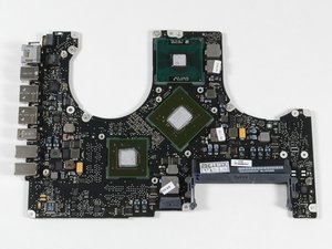

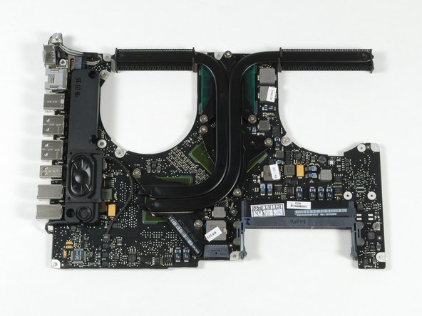

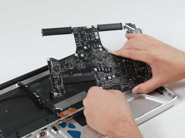

Image 1/1: We're noticing a lot of hardware similarities between the MacBook Air, new Macbook, and this MacBook Pro.
  • Removing the logic board.
  • We're noticing a lot of hardware similarities between the MacBook Air, new Macbook, and this MacBook Pro.
  • Apple has taken their new manufacturing approach to heart, and is using the flexibility it provides to standardize as much of their design as possible.
Image 1/1:
  • The top of the logic board, with the heatsink still attached.

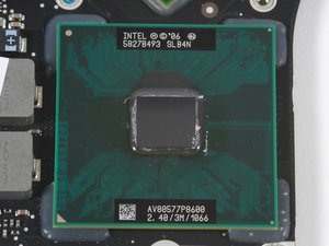

Image 1/2: The large chip on top is the Intel 2.4 GHz Montevina processor. It has 3M L2 cache and a 1066 MHz bus. Markings: 5827B493 SLB4N AV80577P8600 Image 2/2: The other two large chips are Nvidia graphics chips.
  • Logic board top with heatsink removed.
  • The large chip on top is the Intel 2.4 GHz Montevina processor. It has 3M L2 cache and a 1066 MHz bus. Markings: 5827B493 SLB4N AV80577P8600
  • The other two large chips are Nvidia graphics chips.
  • We'll post part numbers as we identify them.

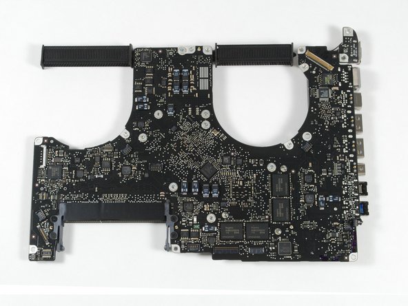

Image 1/1:
  • Logic board bottom.
Some of these:
CY8C24794-24L is a SoC with a lot of bus interfaces, a LOT of analog interfaces and CapSense touch capabilities. This chip is very versatile and function cannot be determined by it's typenumber. It might run fanspeed, touchpad, backlight, temp. sensors and lot of other functions I cannot even think up at the moment.
RTL8251CA is the 10M/100M/1G bit ethernet chip.
H5RS5223CFA are the GDDR3 videomemory chips.
ISL6236 is the power supply controller.
roadrunner - Reply

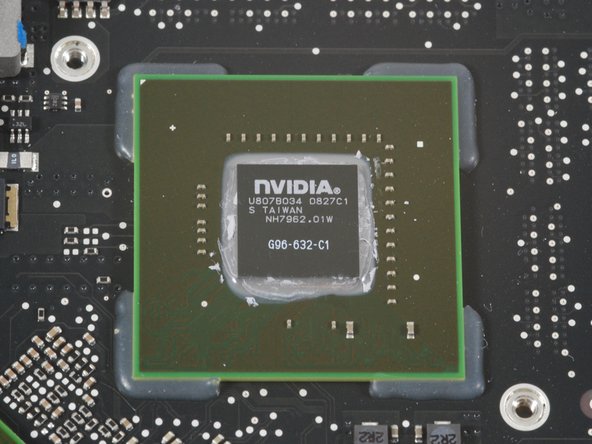

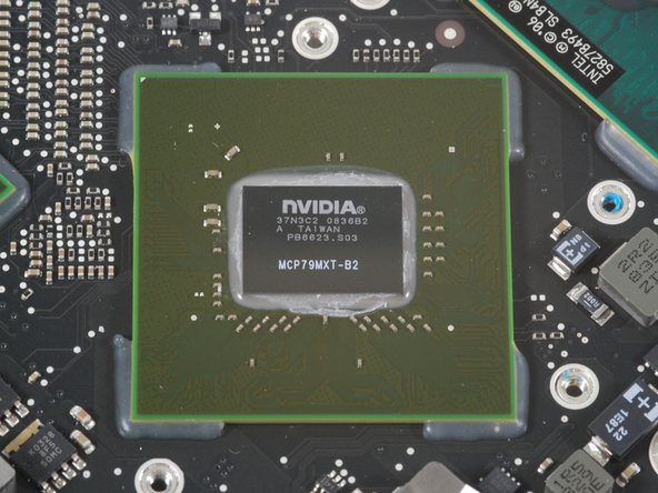

Image 1/2: The first chip is marked 37N3C2 0836B2 PB6623.S03 MCP79MXT-B2. This is the [http://www.nvidia.com/object/product_geforce_9400m_g_us.html|GeForce 9400M], also serving as a northbridge. Image 2/2: The second chip is marked  U807B034 0827C1 NH7962.01W G96-632-C1. This is the [http://www.nvidia.com/object/geforce_9600m_gt.html|GeForce 9600M GT], which has 32 processor cores and is capable of 120 Gigaflops.
  • Here are the two Nvidia chips! They occupy a significant amount of the logic board. There's no way both of these puppies could fit in a MacBook Air.
  • The first chip is marked 37N3C2 0836B2 PB6623.S03 MCP79MXT-B2. This is the GeForce 9400M, also serving as a northbridge.
  • The second chip is marked U807B034 0827C1 NH7962.01W G96-632-C1. This is the GeForce 9600M GT, which has 32 processor cores and is capable of 120 Gigaflops.
The 6900M GT is actually smaller than the 9400M.
So wtf gets my correction of that mistake denied for the third time now?
Look at the pictures, dude! The larger chip is the 9400M.
MrUNIMOG - Reply
Image 1/1: Remove six 6 mm T-6 Torx screws near the hinge.
  • Continuing the disassembly, we're going to remove the display assembly.
  • Remove six 6 mm T-6 Torx screws near the hinge.
There are also two small hinge parts on top of these six screws that need to be taken off. Big step missing here. Disassembling the hinges and separating the display from lower case is complicated procedure that needs more pictures/directions.
twokitties - Reply
The absolutely crucial step that's missing at step 24 is that you need to open the display by 90 degrees before unscrewing the hinge from the main body!!
Rolf - Reply
Quote from Rolf:
As it says in the intro, this page is a teardown and should not be used for disassembly. Check out our MacBook Pro 15" Unibody Late 2008 and Early 2009 device page for detailed repair instructions.

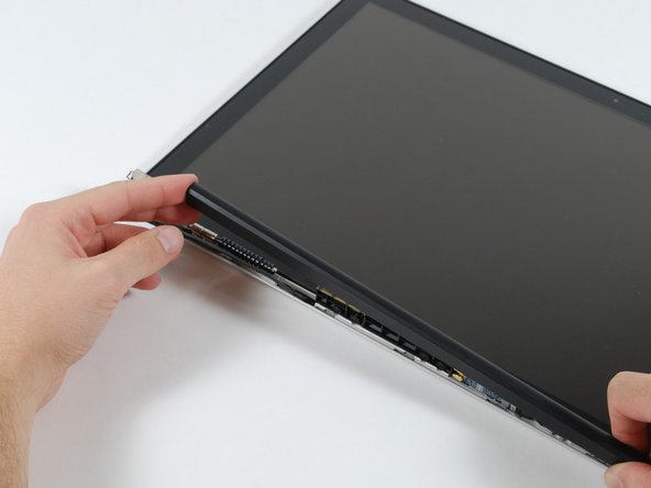

Image 1/1:
  • Removing the lower display bezel.
Help!! How does one get from Step 24 to Step 25 and separate the display from the bottom case? Seems to be a lot of info missing here.
twokitties - Reply
Airport card does NOT appear to be mini-pci express (and thus not easily replaced with a non-broadcom one). Can you confirm? Are the connectors proprietary?
Thanks for your guides!
idk - Reply
HELP!
How the lower display bezel was removed? Which tools was used?
AlekseyNN - Reply
this should be added:
"Next remove the clutch cover by sliding it to the side and applying a gentle upward pressure."
blargh - Reply
The trick is that you need to open the display by 90 degrees before unscrewing the hinge!! That's not at all obvious from picture 24 and caught me out big time.
Rolf - Reply
To remove the cover you need to slide it to the left about .5" to release it.
Kyle Halwey - Reply

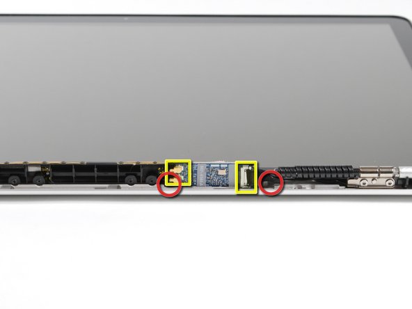

Image 1/1: Disconnect the antenna connector and the data cable.
  • Removing the Airport card.
  • Disconnect the antenna connector and the data cable.
  • Remove the two screws.
  • The Bluetooth cable disappears into the display, and our sources tell us that it's sandwiched between the glass and the metal case. This means that if your Bluetooth goes out, you may have to replace the entire display!

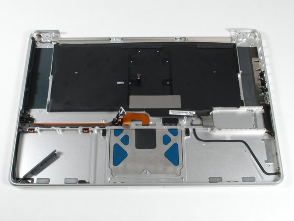

Image 1/1: This case assembly includes the keyboard, glass trackpad, and ribbon cables.
  • The "unibody" upper case assembly.
  • This case assembly includes the keyboard, glass trackpad, and ribbon cables.
  • While the manufacturing of the case is sexy, our sources say that Apple is treating this as a single replaceable part. This means that if you break a key on the keyboard, you'll have to replace the entire upper case. That could get very expensive.
Hello, Is the picture of the lower case assembly is the one that we can buy "as is" on your store ? I mean, nothing missing? I've to change the upper case of my MBP and I'd like to now if I can go to the step 28 and go backward from step 28 to step 1 with my new upper case. Thank you!
antoinemercadal - Reply
Does anybody know what type of LEDs are used there?
Ankantoiel - Reply

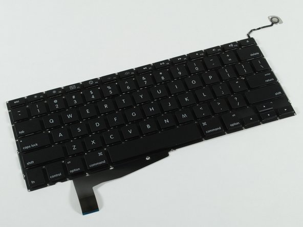

Image 1/1:
  • In an attempt to save a lot of people a lot of money, we're going to try removing the keyboard from the upper case.
I have successfully replace my keyboard on my unibody MBP. I purchased the keyboard on ebay. The whole thing took two hours.
SoDigito - Reply
I am just curious, if I have to reapply the thermal paste after the keyboard is replaced? Thanks!
diezmann -
Image 1/1:
  • The keyboard is secured by lots of tiny black Phillips #000 screws. We're removing ALL of them.
Hi to all.
I wanted to know if the keyboard was also 13,3 removable by the 56 targeted or if it was welded into a store because I have said it was welded.
Thank you for your reply.
LaurentFrensh - Reply
Image 1/1: This is looking promising!
  • OK, we got them all out. There are 56 screws on the keyboard, plus two on the power button.
  • This is looking promising!
How much does the unibody enclosure weigh with the other parts removed?
Trevor Abbott - Reply
Image 1/1: It looks like users may be able to repair their own keyboards after all! Great news for the heavy-handed and spill-prone.
  • We got it off! Phew. It took about 15 minutes to remove all the screws.
  • It looks like users may be able to repair their own keyboards after all! Great news for the heavy-handed and spill-prone.
So, can you pop the keys off?
RichDay - Reply
Quote from RichDay:
no
hti - Reply
Hi can you get replacement keyboards? What is the part number on the keyboard? are all new 15" keyboards the same?
danielkoene - Reply
is there any website that sell only the backlid keyboard for the macbook pro?
vaughnescobal - Reply
Quote from vaughnescobal:
is there any website that sell only the backlid keyboard for the MacBook Pro?
I was unable to find one and ended up replacing the entire case. BTW, I had gone this route before shopping for the replacement -got the backlight panel off and removed all 56 of those screws. I even removed all the keys (using toothpicks and a hemostat), but found the membrane sandwich under the metal frame laminated together. Other than harvesting keys for replacement on another kybd, there's no point breaking it down any further than shown here.
It's a shame, too, cuz a factory new lower case ends up being $250-$280 depending on the source. The kybd alone should've only been about $50.
Brett Deriso - Reply
