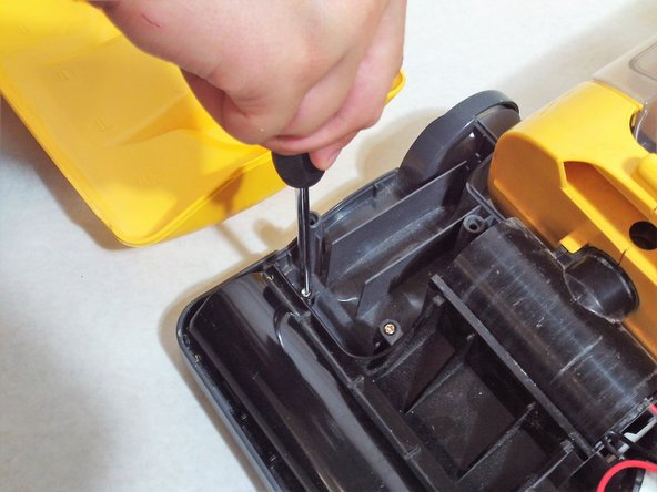

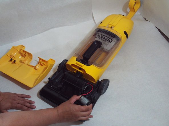

  2. Eureka 402A Mini Light Upright Vacuum Belt Replacement: step 2, image 1 of 3 Eureka 402A Mini Light Upright Vacuum Belt Replacement: step 2, image 2 of 3 Eureka 402A Mini Light Upright Vacuum Belt Replacement: step 2, image 3 of 3

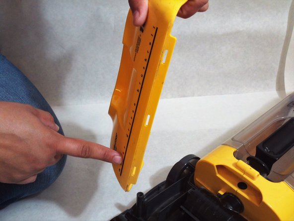

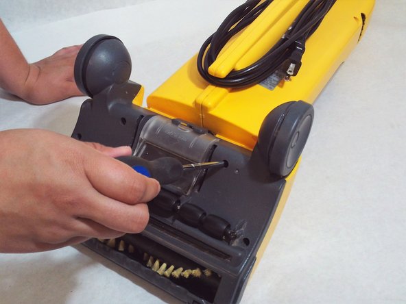

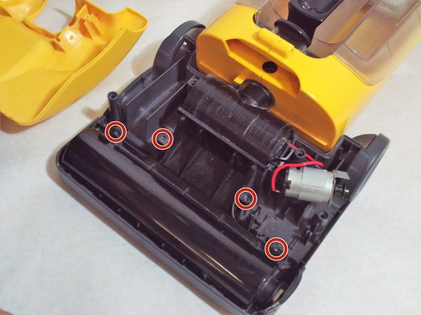

    • Rotate the vacuum faced down. With your Phillips screwdriver, remove the following four screws.
    • To remove the yellow housing, lift upwards.
    • Remember of where each of the screws you remove belong, separate them accordingly.

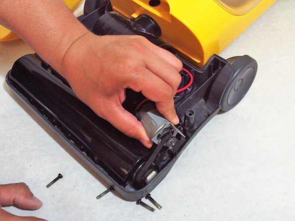

  3. Eureka 402A Mini Light Upright Vacuum Belt Replacement: step 3, image 1 of 3 Eureka 402A Mini Light Upright Vacuum Belt Replacement: step 3, image 2 of 3 Eureka 402A Mini Light Upright Vacuum Belt Replacement: step 3, image 3 of 3

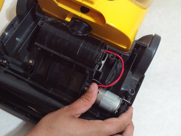

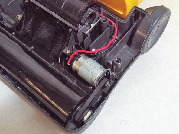

    • Remove the metal motor simply by gripping each end and pulling upwards.
    • This will release the connection to the vacuum belt.

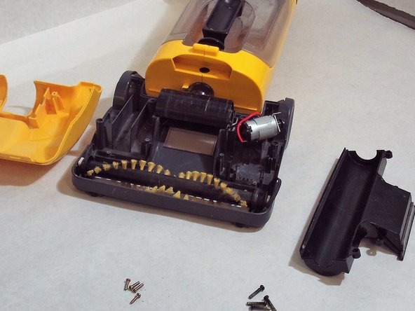

  4. Eureka 402A Mini Light Upright Vacuum Belt Replacement: step 4, image 1 of 3 Eureka 402A Mini Light Upright Vacuum Belt Replacement: step 4, image 2 of 3 Eureka 402A Mini Light Upright Vacuum Belt Replacement: step 4, image 3 of 3

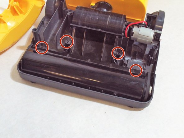

    • Unscrew the four screws from black roller housing, then remove by lifting up.

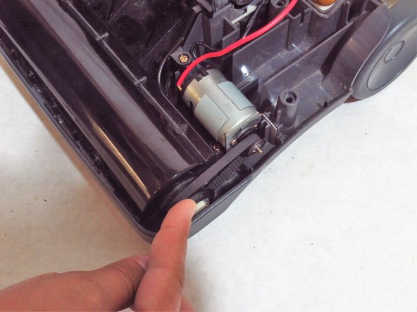

  5. Eureka 402A Mini Light Upright Vacuum Belt Replacement: step 5, image 1 of 2 Eureka 402A Mini Light Upright Vacuum Belt Replacement: step 5, image 2 of 2
    • Raise the side of the brush which is connected to the vacuum belt.

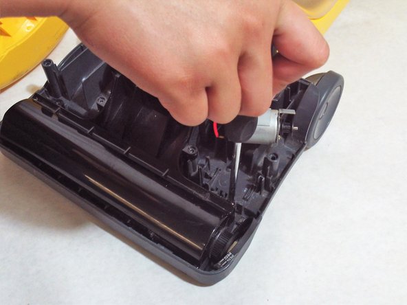

  6. Eureka 402A Mini Light Upright Vacuum Belt Replacement: step 6, image 1 of 3 Eureka 402A Mini Light Upright Vacuum Belt Replacement: step 6, image 2 of 3 Eureka 402A Mini Light Upright Vacuum Belt Replacement: step 6, image 3 of 3
    • After the brush has been removed, replace the vacuum belt.
    • Following the replacement of the belt, secure the brush back into housing.
    • Place the black cover back on the housing, and secure with screws.
    • Make sure screws are tightly wound. A loose screw can cause a loss of suction.

    • Stretch and wind the belt onto the motor notch.
    • Replace the motor back into position, then check the movement of the belt.
    • Belt should easily rotate.
    • Check to make sure wiring is connected properly and not misplaced.

You might've spent a little more time on the step: "To remove the yellow housing, lift upwards." Not happening on my planet. I have removed just about everything from under the yellow housing and disconnected the wheeled brush nozzle from the upright. Without (yet) disconnecting the two. In all these years no one asking you to reveal this secret?
gubbjavel - Reply
I just had the same problem removing the yellow cover. With the yellow cover tilted up, insert a very small flat blade screwdriver starting from one side between the grey part and the yellow cover. Work the screwdriver inwards until it hits one of the 3 clips. Then you should be able to release the first clip by working the screwdriver into it. Work the screwdriver across the front to release the other two clips.
fixitallnowplease - Reply
