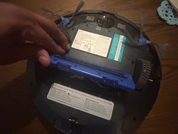

  2. Eufy Robovac 25c Roller Brush Replacement: step 2, image 1 of 1
    • Flip over the Eufy Robovac 25C and locate the brush roll cover.
    Ask FixBot
  3. Eufy Robovac 25c Roller Brush Replacement: step 3, image 1 of 1
    • Remove the brush roll cover.
    Ask FixBot

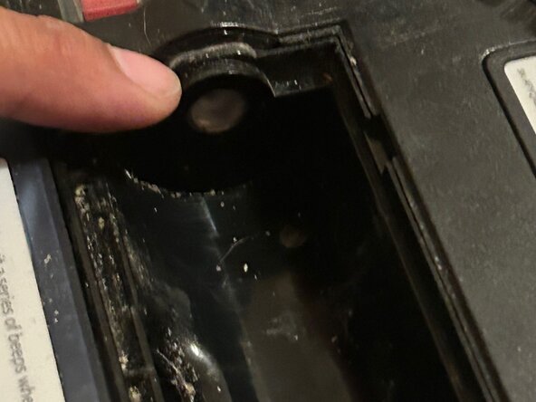

  4. Eufy Robovac 25c Roller Brush Replacement: step 4, image 1 of 1
    • Remove the brush roll by lifting from the round side first.
    Ask FixBot
  5. Eufy Robovac 25c Roller Brush Replacement: step 5, image 1 of 1
    • Set aside the used brush and clean the main brush well of any loose debris.
    Ask FixBot
  6. Eufy Robovac 25c Roller Brush Replacement: step 6, image 1 of 1
    • Install the new main brush roller square side first making sure to align the squares.
    Ask FixBot
  7. Eufy Robovac 25c Roller Brush Replacement: step 7, image 1 of 1
    • Replace the brush guard cover.
    Ask FixBot
  8. Eufy Robovac 25c Roller Brush Replacement: step 8, image 1 of 1
    • Ensure the brush guard cover is on secure by pressing the clips until you hear it click.
    Ask FixBot
Follow the steps to replace the main roller brush one complete make sure you power the Eufy Robovac 25C back on and is fully charged. This should help the vacuum work more efficiently.
