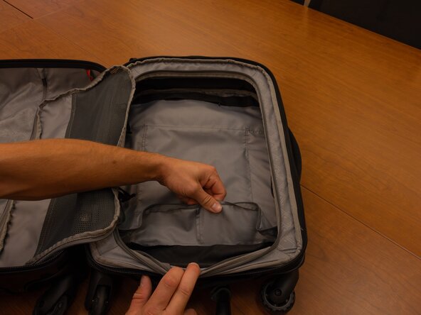

    • In the left pocket of the suitcase, unzip the zipper in the middle of the pocket to reveal the hard shell of the case.
  3. Eagle Creek Luggage Wheels Replacement: step 3, image 1 of 2 Eagle Creek Luggage Wheels Replacement: step 3, image 2 of 2
    • Locate the base of the wheels within the case.

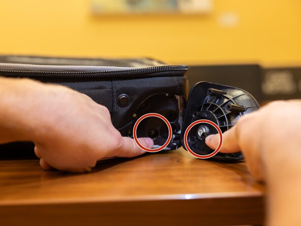

  4. Eagle Creek Luggage Wheels Replacement: step 4, image 1 of 3 Eagle Creek Luggage Wheels Replacement: step 4, image 2 of 3 Eagle Creek Luggage Wheels Replacement: step 4, image 3 of 3
    • Remove the five screws on each base side of the suitcase using a Phillips #00 screwdriver.
    • Remove the two old wheels.

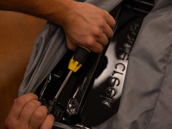

  9. Eagle Creek Luggage Wheels Replacement: step 9, image 1 of 3 Eagle Creek Luggage Wheels Replacement: step 9, image 2 of 3 Eagle Creek Luggage Wheels Replacement: step 9, image 3 of 3
    • Unscrew the five screws holding the two old wheels using a Phillips #00 screwdriver.
    • Remove the wheels.
