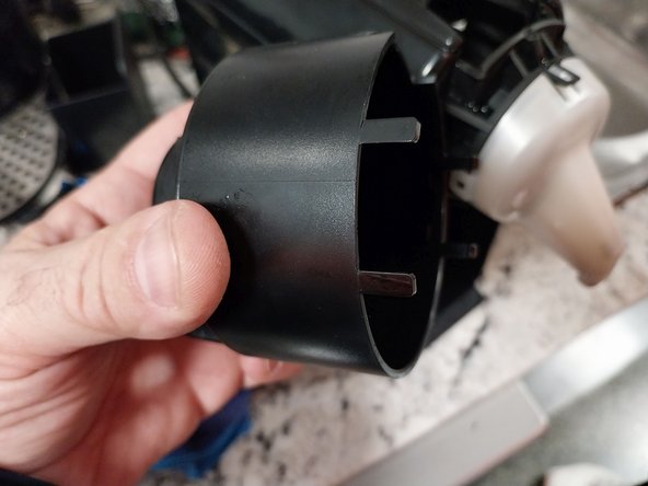

    • I am sorry, this was a quick, improvised repair, not done on my usual table, so I couldn't take all the detailed photos I would have liked to. Photo 1, marked the points where to pry. BEWARE, the red covers must be removed.
    • Photo 2: View of the side catches or anchors, the front has four latches and tabs.
  9. Disassembly of coffee outlet nozzle Krups Nespresso XN100 coffee maker due to clogging, losing excess water., Nozzle cover.: step 9, image 1 of 1
    • View of the front and its four latches and tabs.
