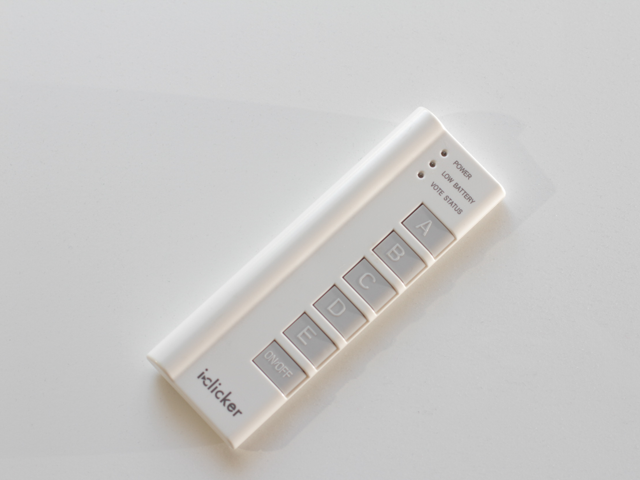

  1. Disassembling iClicker Device, Disassembling iClicker Device: step 1, image 1 of 1
    • Behold the iclicker in all its interactive and educational beauty.
  2. Disassembling iClicker Device: step 2, image 1 of 1
    • Place the device on a flat surface, buttons facing down.

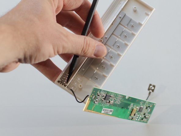

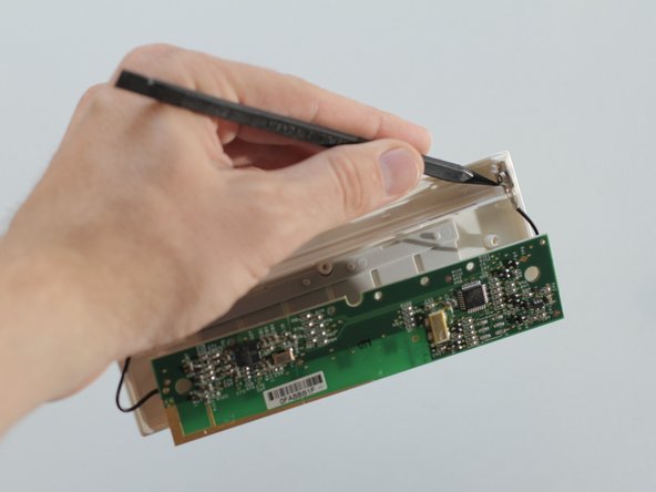

  6. Disassembling iClicker Device: step 6, image 1 of 2 Disassembling iClicker Device: step 6, image 2 of 2
    • Using a spudger, gently pry the battery connectors from the front panel.
  7. Disassembling iClicker Device: step 7, image 1 of 1
    • If your circuit board is stuck in the front panel, use a spudger to lift the circuit board from the front panel.
