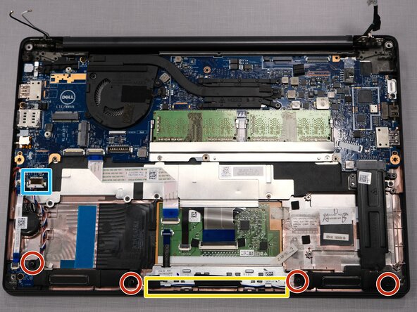

    1. Dell Latitude 7400 Speakers Replacement, Speakers: step 3, image 1 of 3 Dell Latitude 7400 Speakers Replacement, Speakers: step 3, image 2 of 3 Dell Latitude 7400 Speakers Replacement, Speakers: step 3, image 3 of 3
      • Disconnect the speaker cable from its connector on the motherboard.
      • Unthread the speaker cables from the routing guides, and carefully pull the cables out from the metal snap.
      • Caution: The cables will break if you pull too hard.

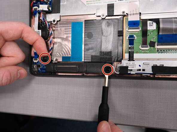

    2. Dell Latitude 7400 Speakers Replacement: step 4, image 1 of 3 Dell Latitude 7400 Speakers Replacement: step 4, image 2 of 3 Dell Latitude 7400 Speakers Replacement: step 4, image 3 of 3
      • Use a spudger to pry both sides of the speakers off the rubber grommets, then carefully pull the speakers out.
      • Note: The attached rubber grommets might come loose and fall off.
