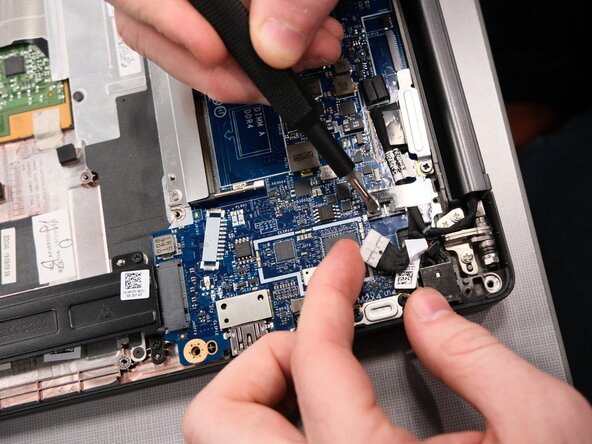

    2. Dell Latitude 7400 Charging Port Replacement: step 4, image 1 of 2 Dell Latitude 7400 Charging Port Replacement: step 4, image 2 of 2
      • Use a spudger to push the white charging port connector out of its motherboard socket.
      Ask FixBot
    3. Dell Latitude 7400 Charging Port Replacement: step 5, image 1 of 1
      • Carefully lift the charging port straight up to remove it.
